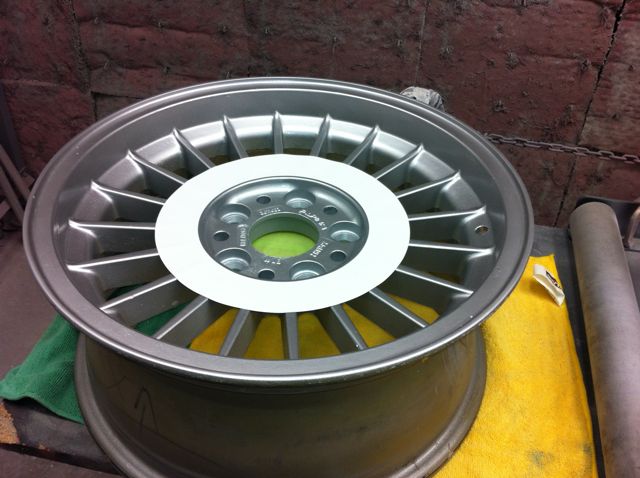

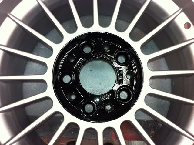

To get the new paint to stick it's best to have them media blasted. Our local guy charges $40 per wheel, a real bargain based on my attempt to blast one in my cabinet. Once you have bare aluminum you need to decide on paint vs. powder coat. One advantage of powder coat is the vendor might media blast as part of the deal. If you go with paint I recommend base/clear coat. I used PPG in BMW polaris on my Alpina wheels, per recommendations on this forum. For the centers, I had masks made up and those were shot with single stage PPG gloss black. I asked the paint store about semigloss and they didn't recommend it because the flatting agent can result in an inconsistent finish.
Here are a couple of shots.

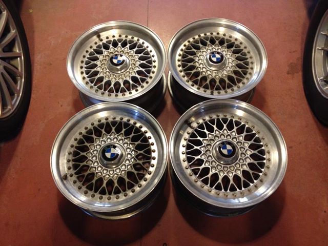

I've had my 16" BBS RSs & 14" basketweave Mahles powder coated. Powder coat temp is only 350º, looks great. Had them done by Kwicksilver Wheel Services.
So I'd get them powder coated.

They look great Bill. Its not clear to me whether you did them yourself or by a shop.
I have a good friend who has a booth and has done a lot of paint work over the years. I helped but he did the actual paint application. It is quite tricky to get enough paint on the Alpina spokes without having runs appear. I'd leave it to a pro if you decide on paint. Powder coat, by the nature of the electrostatic process, is probably easier in that regard. If you search this site you will find several threads regarding wheel painting and Alpinas specifically. I think Bob (Nicad) was the one who suggested Polaris.
