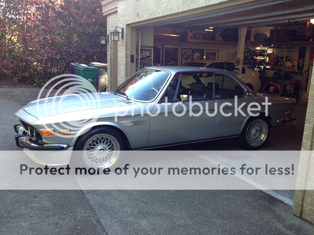

my inspiration (ccmguy8)

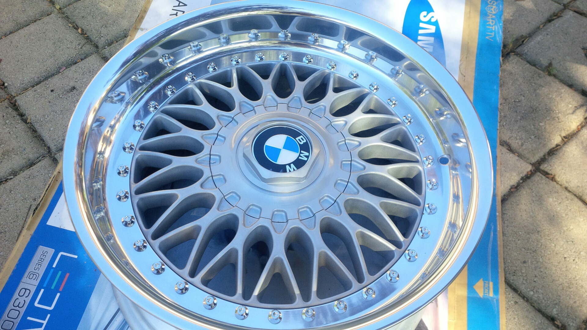

My refurbished wheels with new chrome hardware
Beautiful car. Are those staggered or square? I will soon have tires for my staggered set of 17" RC's. I look forward to seeing how they suit the car. Today I just fitted Alpina's that I have been chasing for quite some time.
I believe they're square ...another member "Vince" has staggered ...his is a beautiful car too. Cheers, Simon
One of the DC area guys has a staggered setup on his car with those same wheels.
I run hub centric rings but no spacers. My front fenders are rolled. These are old pictures, I need to take some new ones.
Beautiful car Vince. I will finally have tires on my staggered set tomorrow so will see how they look in person. My rears have a slightly more aggressive offset using the faces of the 8" wheel on the 9" hub. The final set I want to fit and see in person is the 17" RS and there after will decide which BBS to keep. Put another way, other than the Alpinas, there will be some nice wheels up for grabs because I just can't justify keeping them all.
