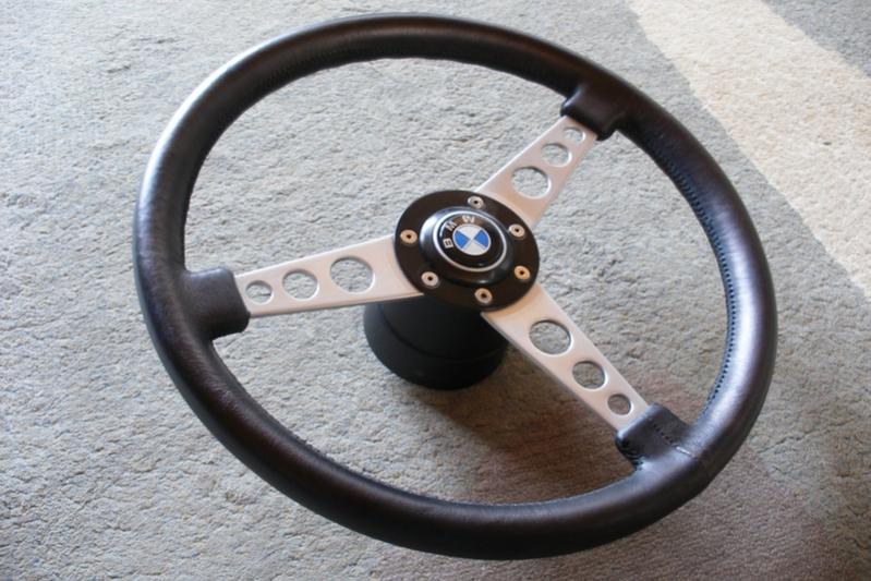

Coupeguy has had some covered in leather - i believe in germany. its not inexpensive as freight going both ways is involved. attached is a pic i believe i got from him when i was considering doing it. also seems like there were some discussions on this forum about the exploration of domestic covering ... seems like Stevehose had some posts

I guess you lose the finger indents when recovering like that. Hmmn. Thanks for the info Scott. Will come to a decision soon!!

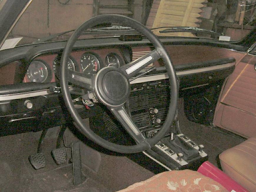

John, can you post a photo of your wheel if convenient. Also, can you feel the finger indents?
If you give them the right measurements you will have no problem feeling the finger grips. Most of the stretching during the install is around the thickness of the rim, not the overall diameter of the wheel if that makes any sense. So the finger ribs / grips do show thru the leather nicely, more so than you’d think. The leather doesn’t slip on the rim at all on my wheel. Hey, if you don’t like it after driving with it on cut it off and go the big $$$ route :grin:. ~ John Buchtenkirch

. To be honest you don’t even feel the thread when driving, the slightly padded leather wads up between the thread and becomes new grips. ~ John Buchtenkirch
