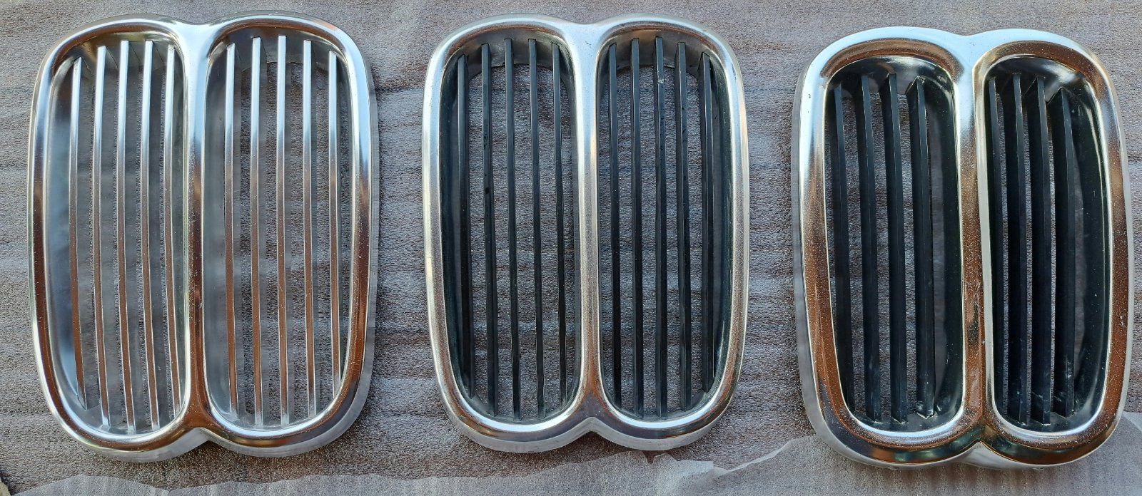

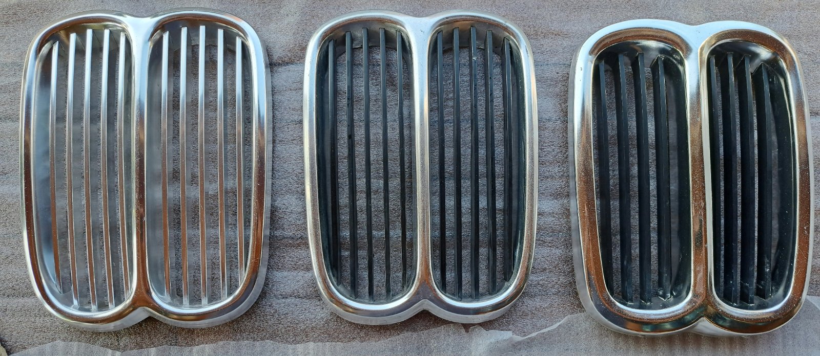

Here:
Left with five bars stainless
Center with five bars anodised
Right for bars plastic

@TomHom; Nice overview pic of the 3 versions side by side.
Are you sure the left one is "stainless" as you write above? (rostfrei?)
I think it looks like the normal anodized version, as it has all those tiny scratches that Alu parts develop from years of Sheer Driving Pleasure.
I ask it as there was a company ~ 6 months ago trying to make repro versions from real Stainless steel in Vietnam or so, which were commented on this forum to be very, very disappointing.
