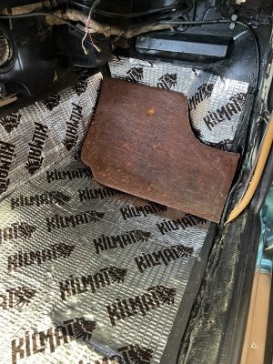

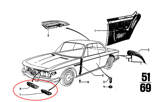

Where are these parts installed?

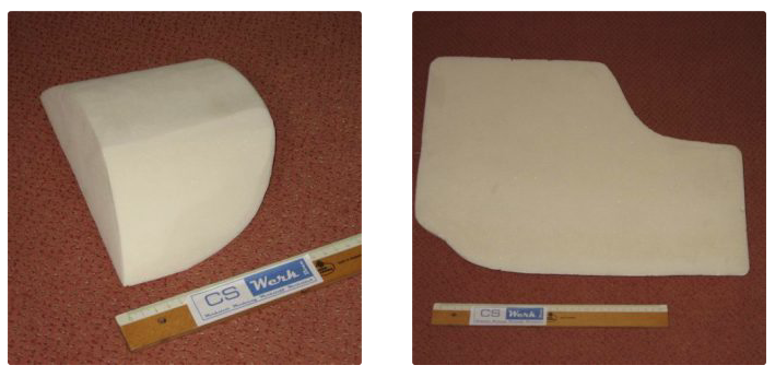

The original ones are a polystyrene material that smooths out the carpet. I just had new carpet installed and these were contact cemented into place before the carpet was cemented onto them. You really need them on both sides for a good installation.
