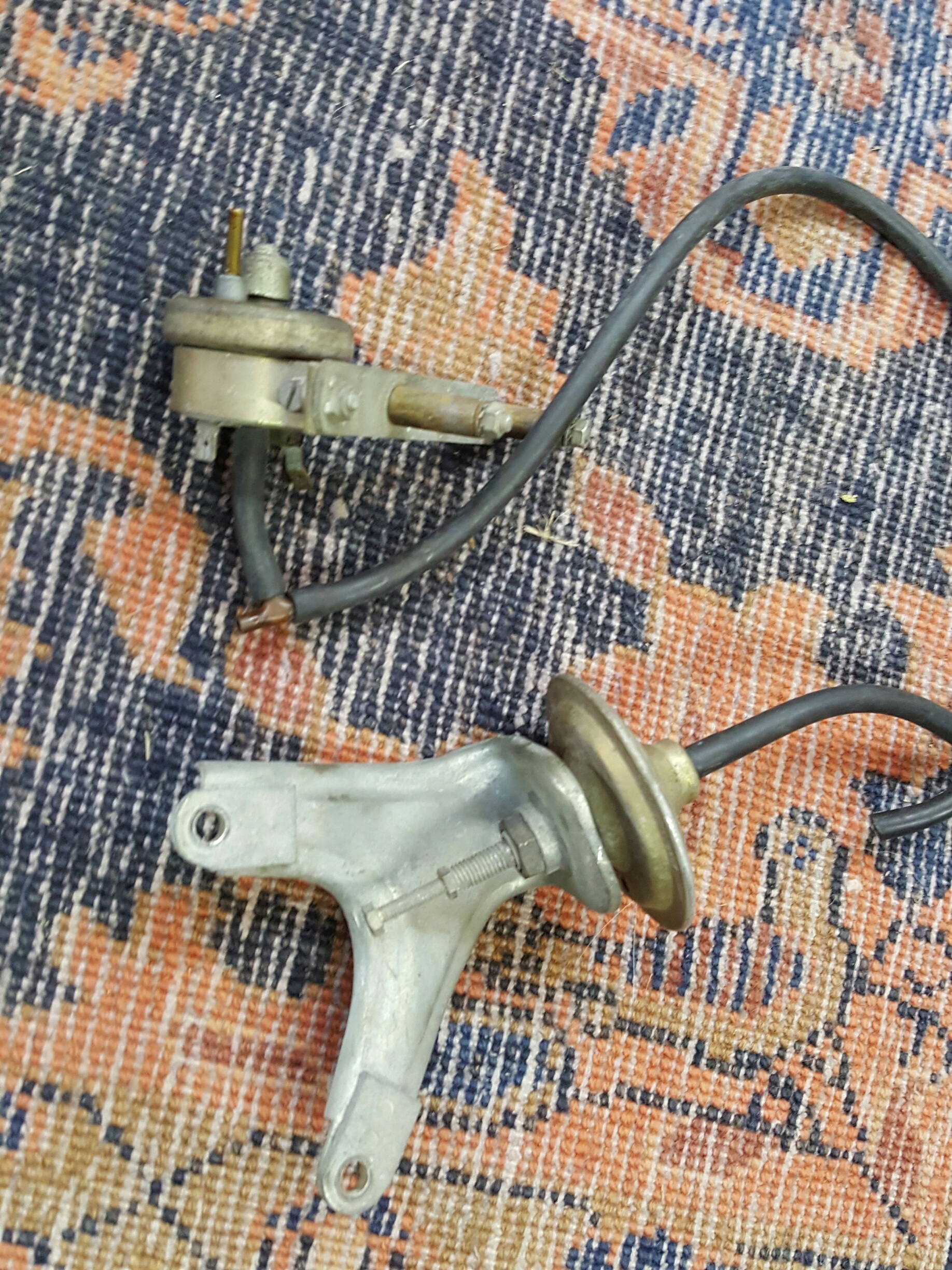

I know the parts are for transmission idle control but not sure where the vacuum lines go.
Also can someone tell me where fuel tanks vacuum line goes in engine dept. Thanks for all your help!

You don't need those, that is the vacuum dashpot and throttle diaphragm that slows the return of the accel linkage when letting off the gas. For the daspot to work you woukd need the speed relay below the coil, vacuum runs from retard I think to daspot then to diaphragm.
