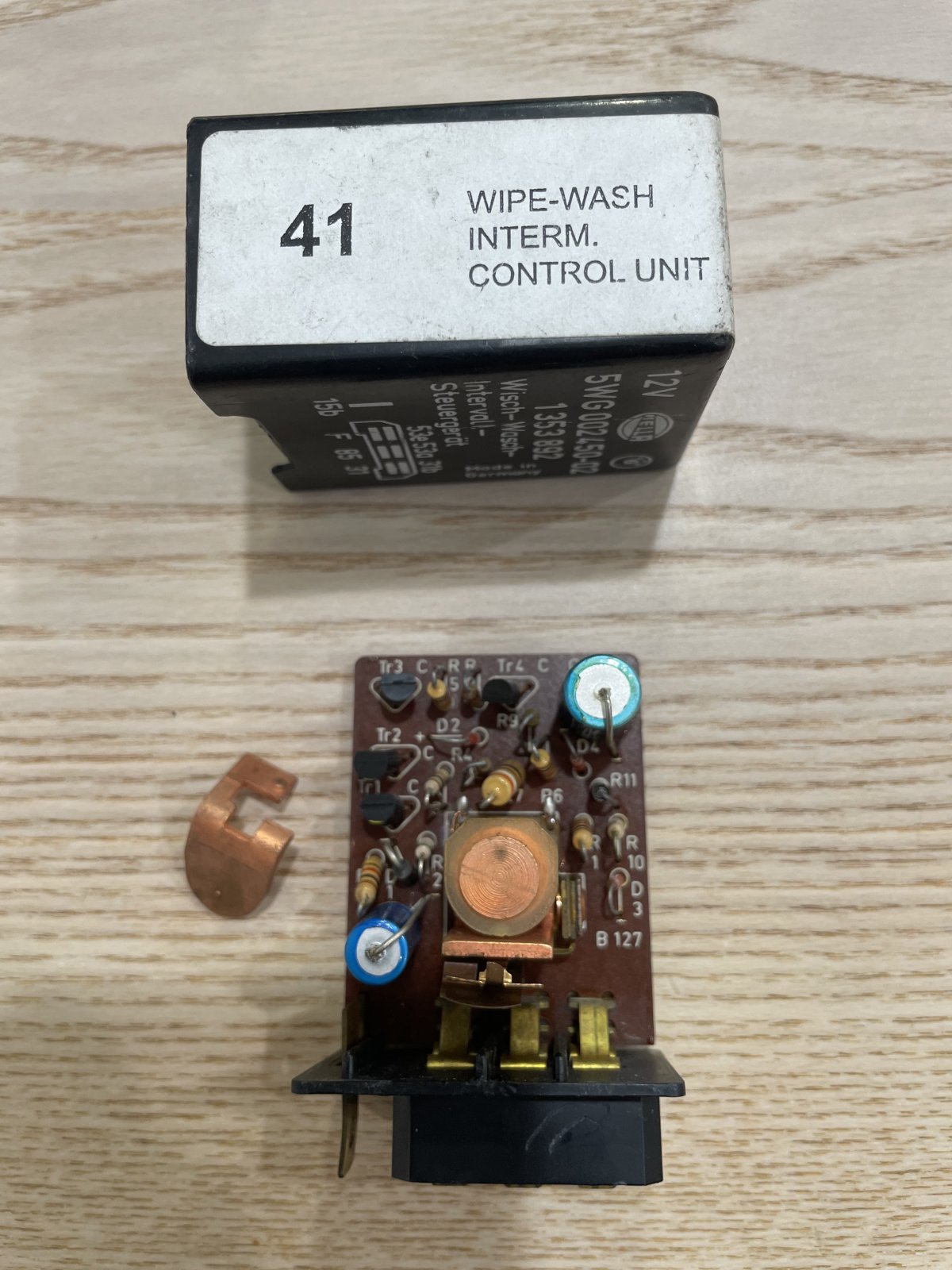

where does this part go?

I found it like this...

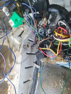

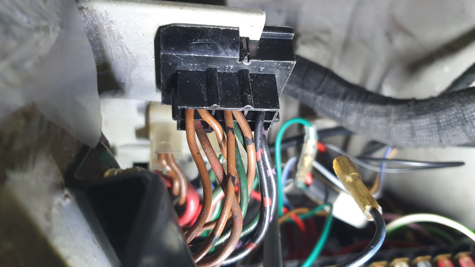

It goes here in that bracket.
Breiti

I'm wondering if alprada70 would like to know where the loose copper piece goes inside the relay enclosure. I haven't had one of these apart, but I suspect it has come loose from the coil part of the relay in the center of the board. There's bound to be a spring mechanism involved somehow and that may be missing. If parts are missing or damaged, a replacement relay may be needed.
That looks like the one half of the points for the relay Should be attached to the top of the solenoid that is showing as the copper round section in the middle of the picture I think that the points contact that small square just below the solenoid My 2 cents worth
That's right. I need to see how the copper piece was going...
