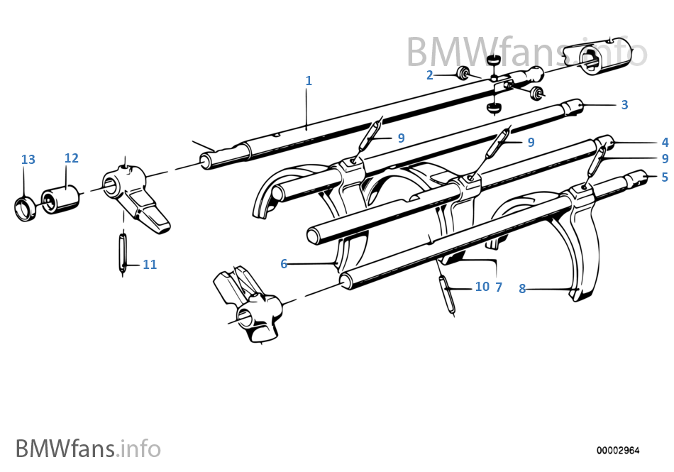

The shop rebuilding my 265 says that one of the shift forks appears bent. Are parts available - and if so where can I get the part numbers from and where can I order from?

The part numbers are online. You should be able to order the parts from any BMW dealer. If you google the parts, you'll get hits on a few BMW dealers with an online presence, such as BMW of South Atlanta.
http://bmwfans.info/parts-catalog/E...ission/getrag_265_5_inner_gear_shifting_parts

The speedo drive part numbers are the same for all models through the 80s, you may need the gear on the output shaft as well. I am surprised any Getrag parts are available other than seals and synchros.
