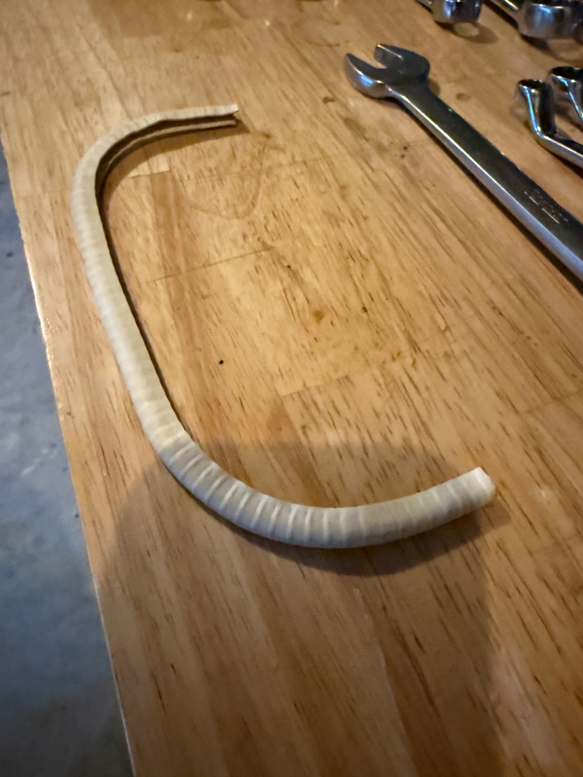

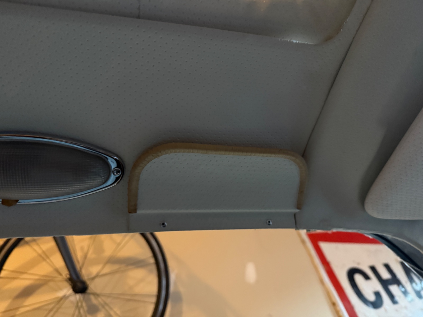

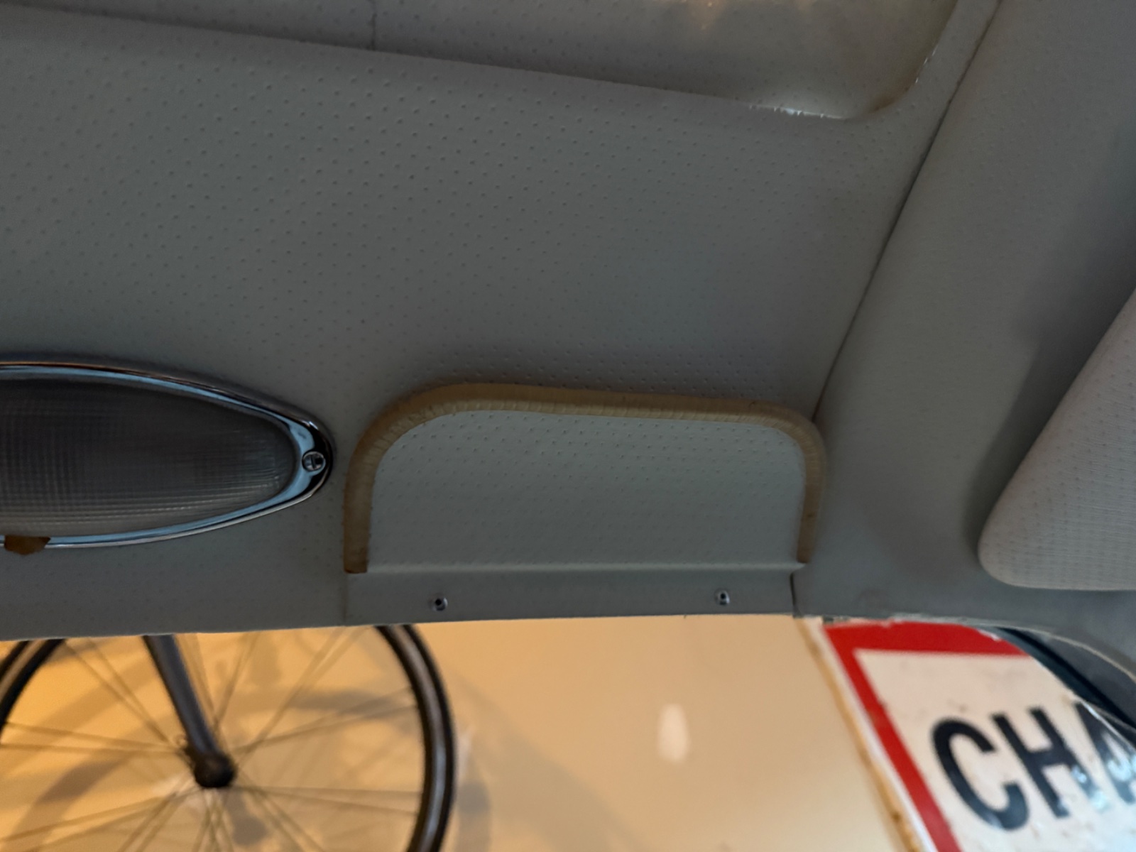

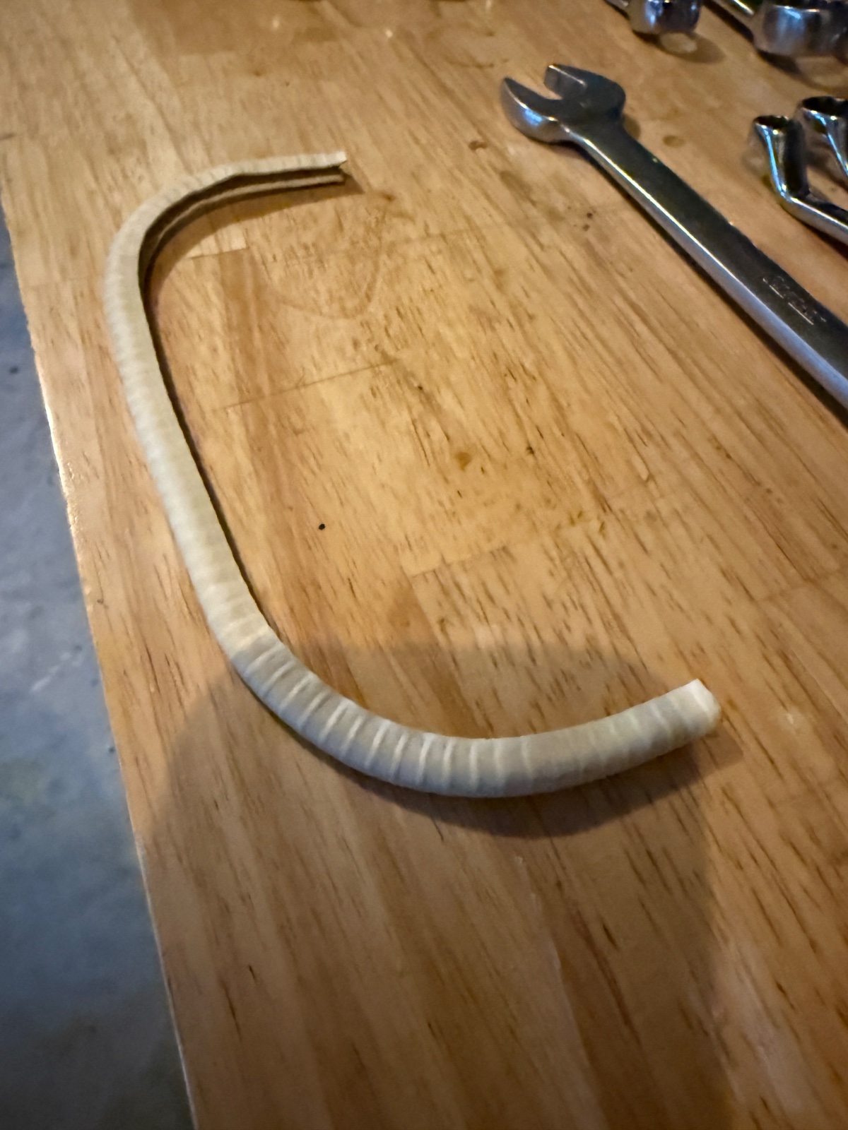

Bit if an odd one, but I am trying to find the white edging that goes on the headliner handles/slots ( not really sure what they are) pictured. I know a lot of coupes do not have these, but the material looks like a thinner version of the white edge trim in the trunk. My old trim has browned over time and no amount of cleaning is bringing it back.

Does the paint hold up on the rubber? I
As Thomas76 wrote, it does hold up. SEM paint is formulated to bond to vinyl and other plastics. Note that you should also use the SEM cleaner / preparation prior to applying the color coat.
it is otherwise fine, just discolored through and through
Discolored or just dirty? I cleaned the similar material used on the edges of my trunk caddy with mineral spirits and a toothbrush, and it came out looking pretty good. But your headliner pocket edging probably gets more sun exposure than my trunk caddy did, so that may have yellowed it.
