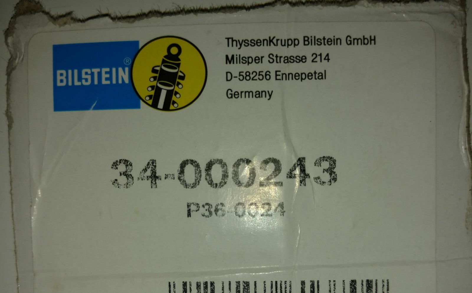

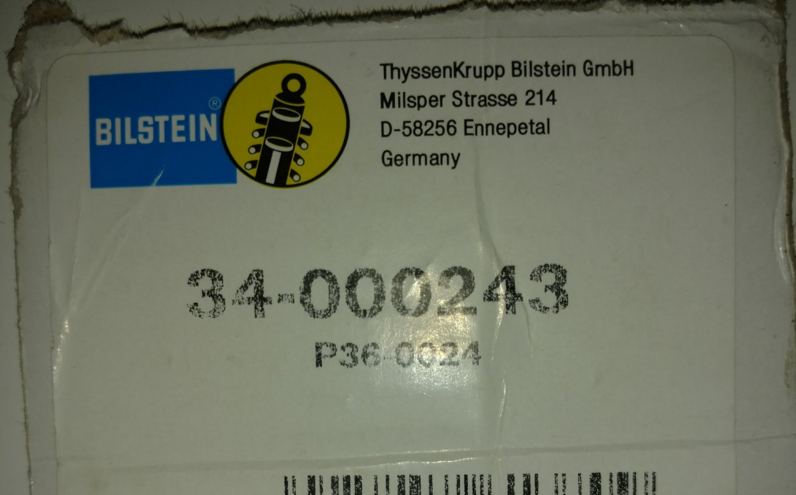

I got these B6
HDs for my 72 Bavaria from some eBay seller for a good price. They are going with stock springs for now that may get replaced or slightly cut. I think I read that they are ok with a moderate drop.
I got these B6 View attachment 115198HDs for my 72 Bavaria from some eBay seller for a good price. They are going with stock springs for now that may get replaced or slightly cut. I think I read that they are ok with a moderate drop.
This helps. What was throwing me off was that some sellers list the part as P36-0024 and others list it as P34-0024. From this package, evidently it is both!
