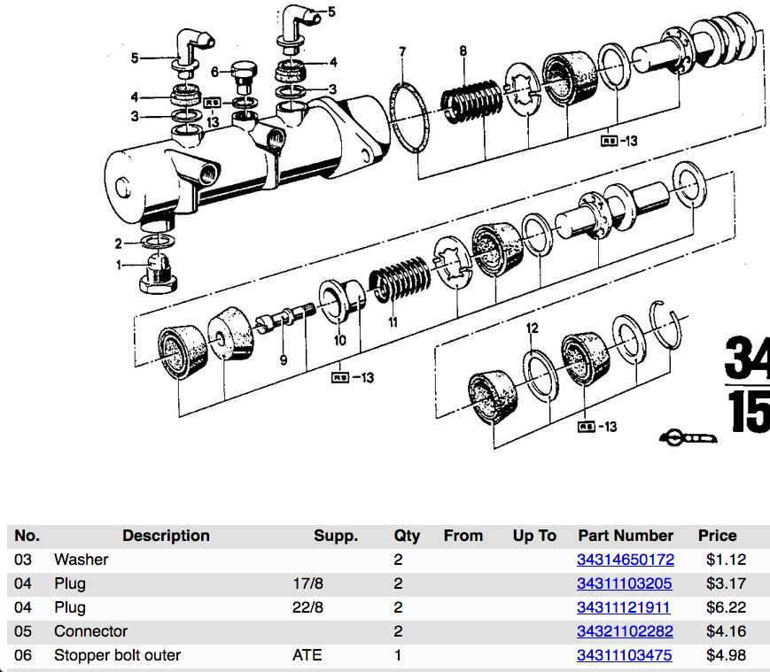

#4 here shows 2 different brake hose tube grommets with different diameters. I am ordering the 3.0cs 22.2mm cylinder for the large booster. Anyone know the correct part number?
The parts book only shows part ending in 205 for both LHD and RHD so I would get that one. As a note, page 34/15 in the parts book has items #1-7 descriptions in the wrong order.
