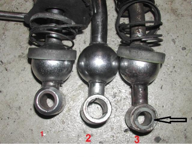

Which cars can this shift lever be sourced from?
Z3 there are 4 or 5 different ones with different fulcrum lengths all dealer available. Or you can cut yours, put a spacer in between the ball and eye, and have it welded for $20. I made my own short shifter this way. A lot cheaper than $60 or so. Also, IIRC, the Z3 shifter does not have a bend in it as do the ones you show in your pictures, put I am sure one could be put into it.
