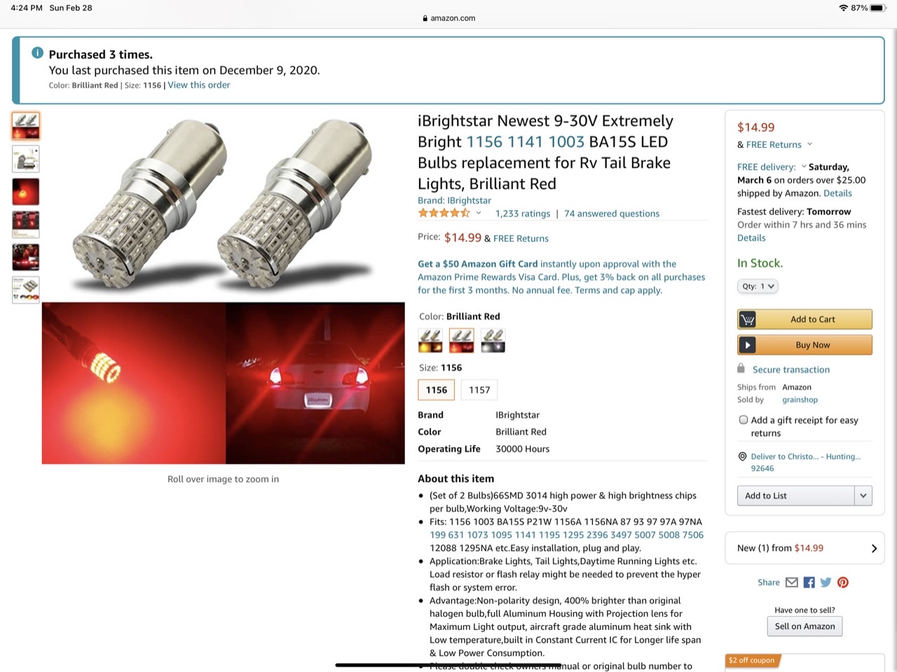

Turn signals are pretty bright with the 21w bulbs and you wouldn’t need to change flasher. I used these LEDs for running and brake on NK and e12 and will put in the e9 as well. 1156 is single filament and I bought red. I followed Gary Waggoner and I couldn’t believe how much better these lights are.

My guess is that any LED bulb is going to draw less current than an incandescent. If I'm finding the same product on Amazon (they seem to have changed the titles and prices since Chris took his screenshot), the specification says: Input Power: 0.05A @ 12V (About 3W). But, if power still equals amps X volts, .05A X 12 V multiplies out to .6 watts, not 3 watts. I think whoever wrote this specification didn't understand that while they may be as bright as a 3W incandescent bulb, these LED's draw far less current. 3 watts @ 12 volts would correspond to .25 amps, five times these bulb's rated current.
The Amazon listing I found was at: https://www.amazon.com/Everbright-4...words=ibrightstar+1156&qid=1614563012&sr=8-20 But again, I don't guarantee that these are the same bulbs that Chris recommended.
