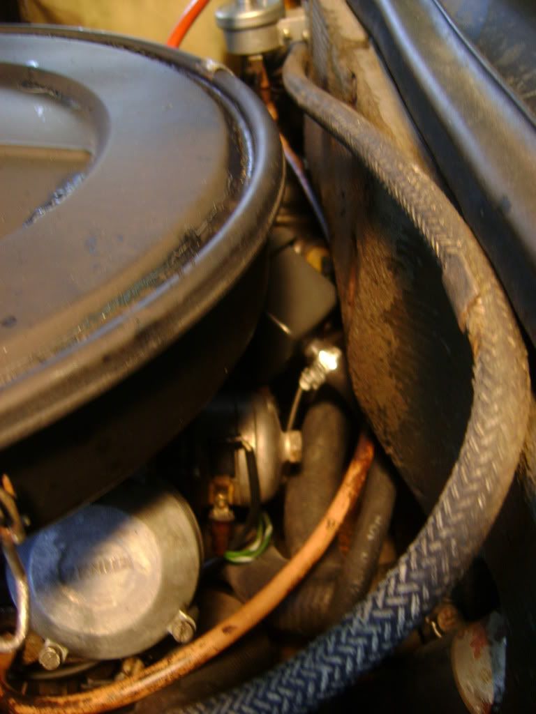

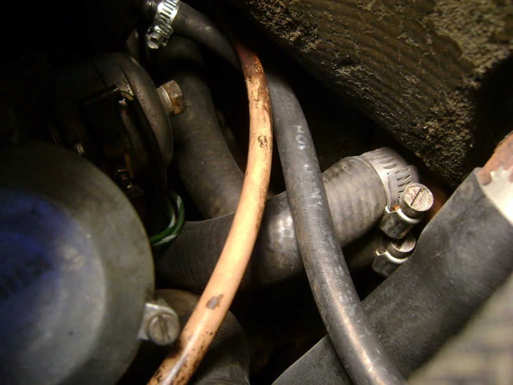

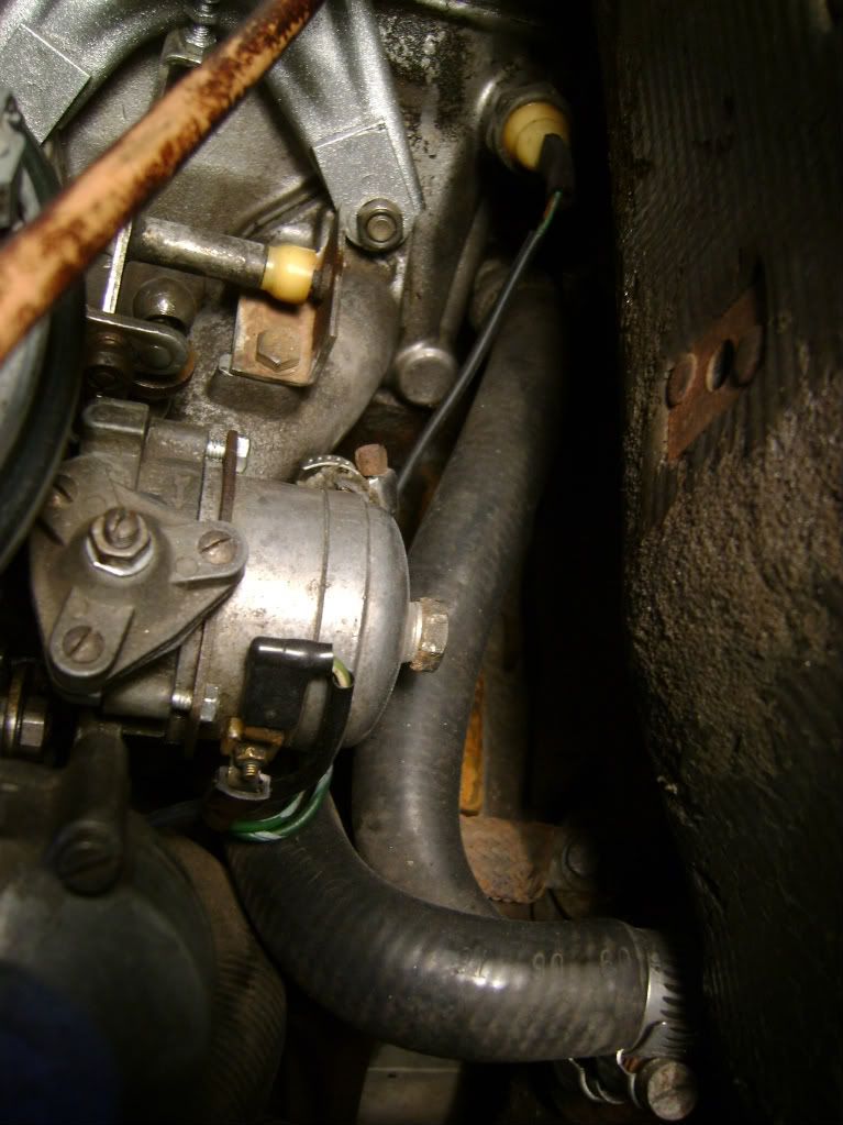

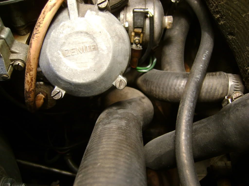

do you see in these two photos?

The pics did help but it looks like my set up is slightly different, both come from under the manifold. One ends at the firewall and the other goes on to the expansion vessel. That seems a little different from you guys? It does look a little homemade though. Not always a good thing.
