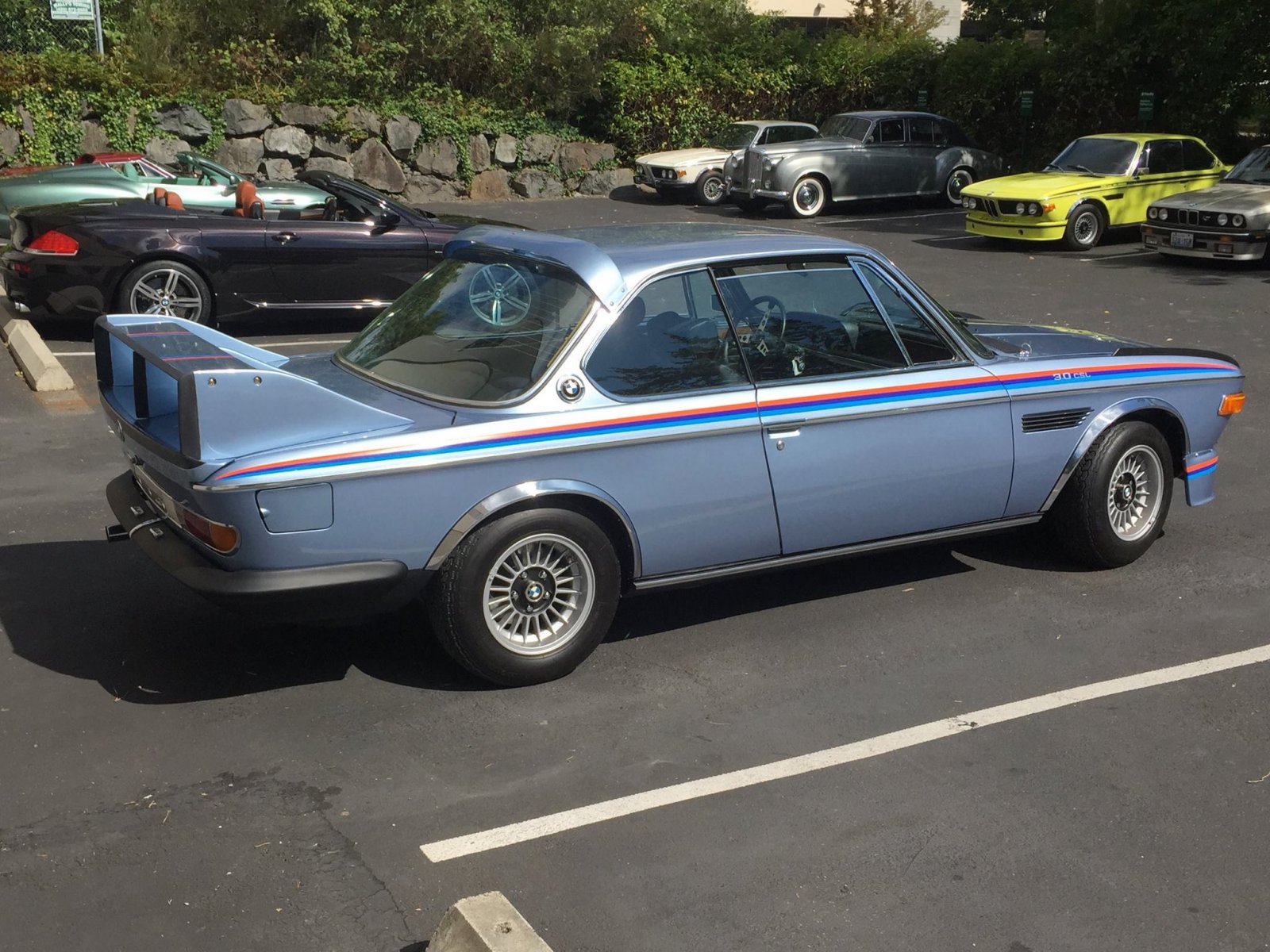

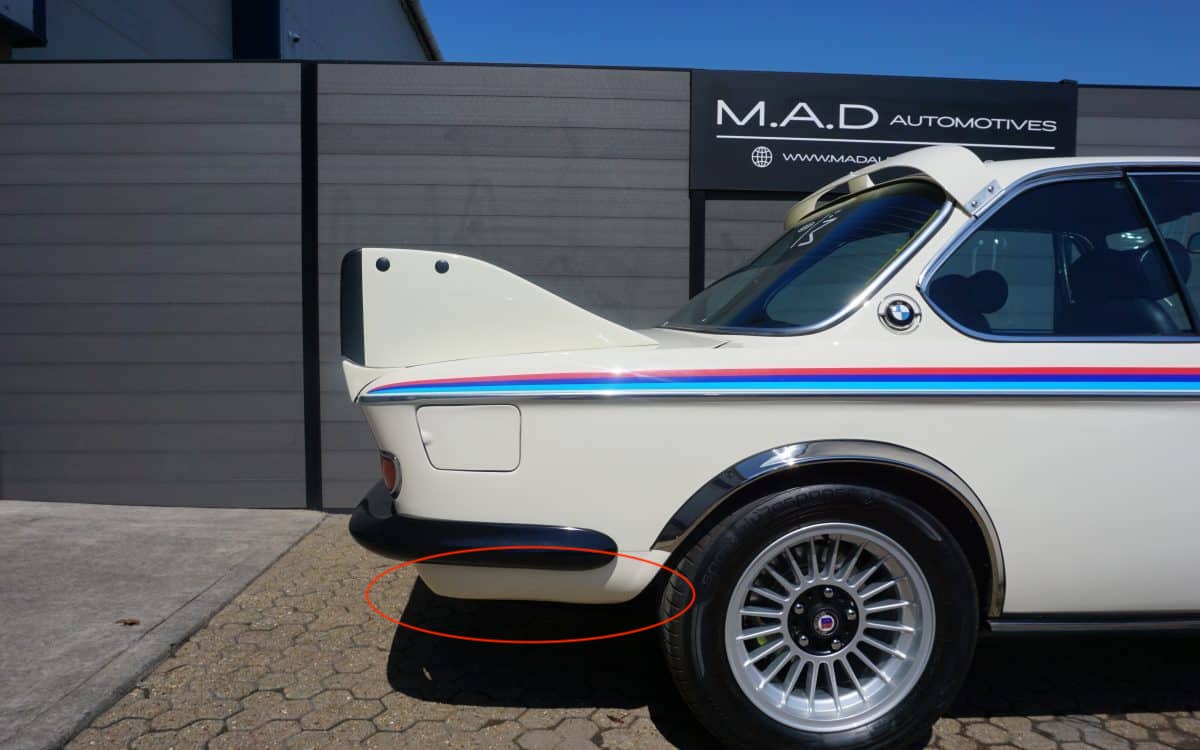

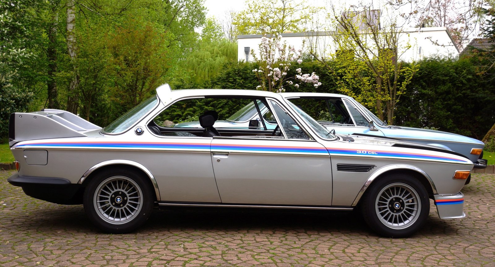

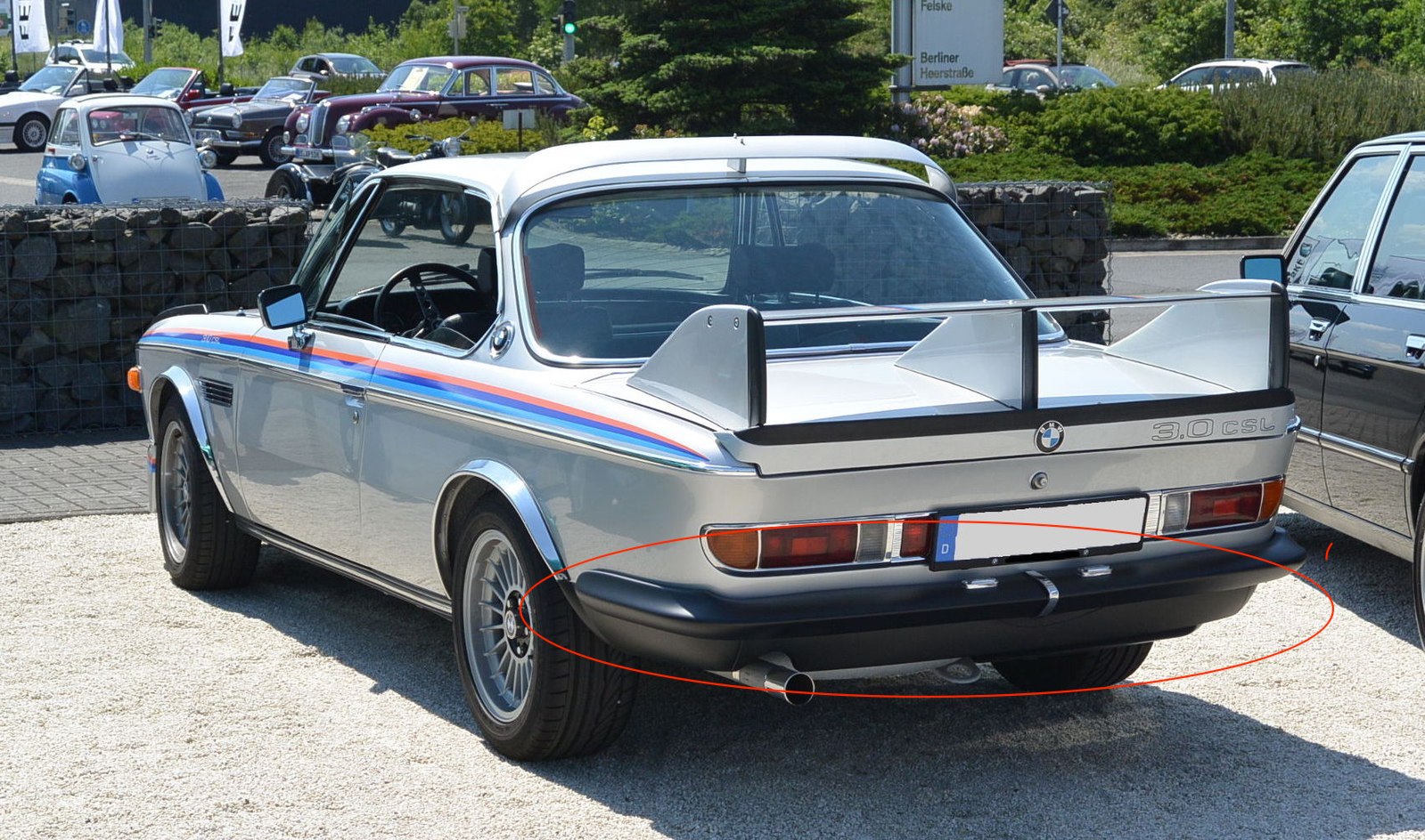

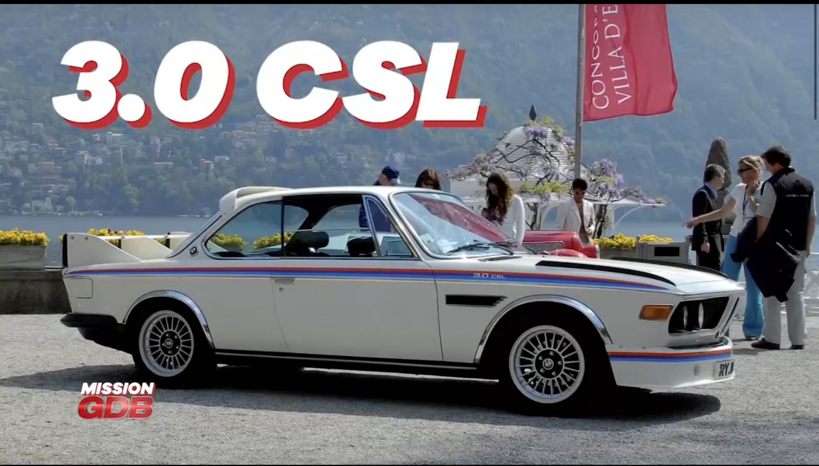

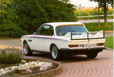

Is it correct or CSL to have this section under rear bumper painted black or it should be body colour here?
Should it be structure paint in both cases?
I thought only the first 169 had black under rear bumper. It should have body schutz or structure as you call it as well.
That’s only CSL insiders info, just kidding! Applies to Csls only and there’s far more to it then just having it blackened or not!
It’s not a simple yes or no…..
I have no idea which is correct, but the body color way is terrible. It leaves the wheel well trim just hanging there.
Yes and No: Lower valance in body color when equipped with the city pack option, black when not. Note: A large number of those nowadays equipped with wings and things started their lives as city pack cars.... That also includes the 3,2 liter cars.
I was surprised to find a picture my polaris CSL in the first post.

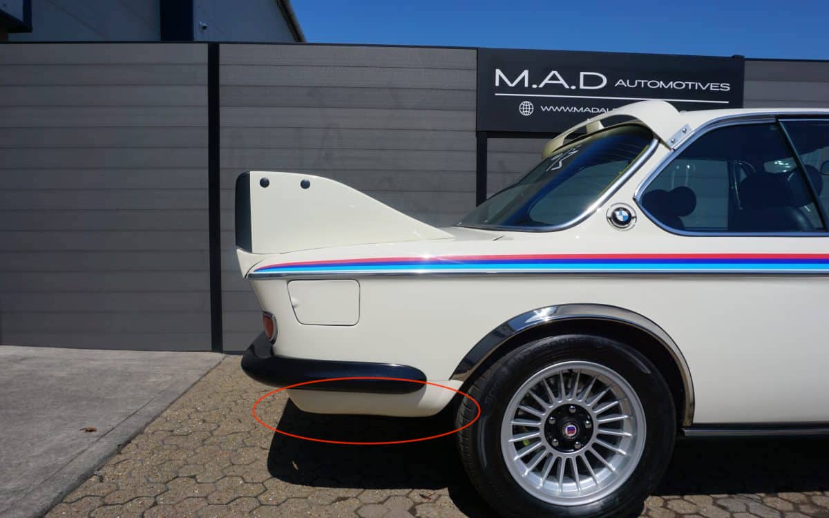

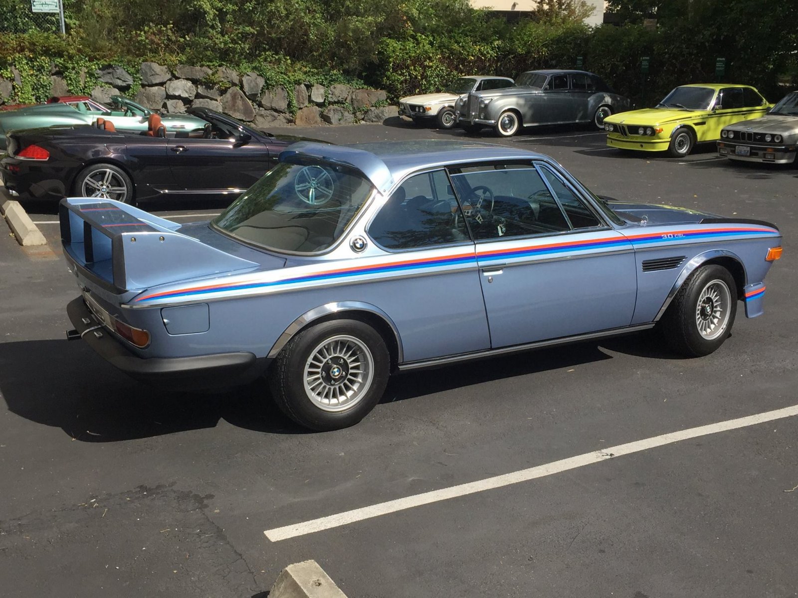

Here’s another one – with the correct black painted under rear section…
