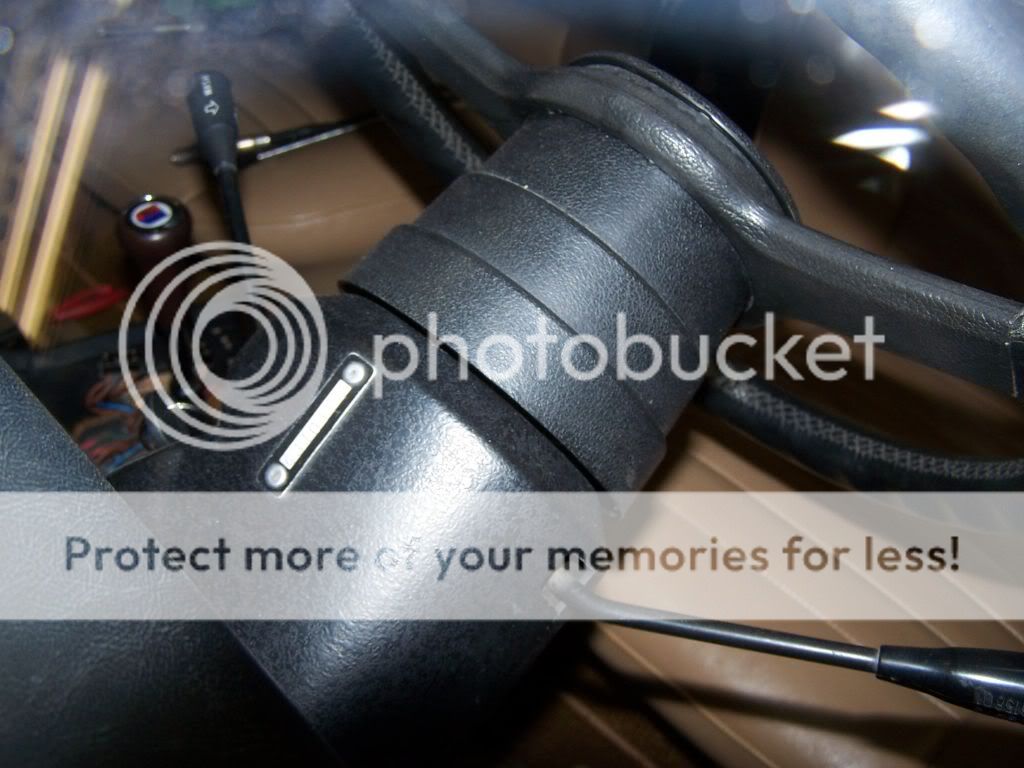

As far as I know, interchange-abilty between wheels and hubs, does not work. This is the 380 mm 320 as installed. 300K on my old 'benz I like leather and the notches, comfort level....
Old guy, what can I say?
Excuse the mess, wiring in progress...

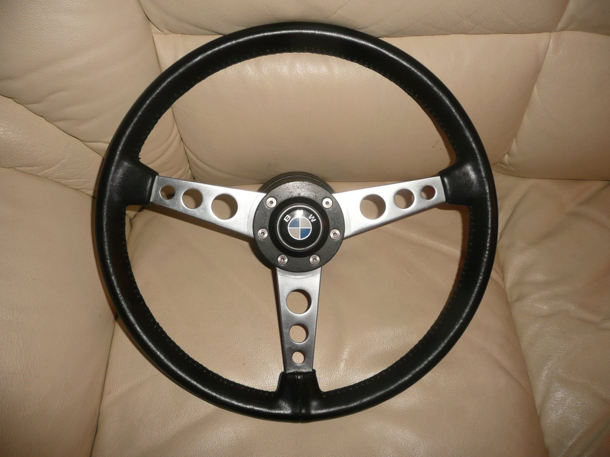

My all time E9 favorite steering wheel is the 380mm leather Petri. It has the perfect size, style, grip and the ultimate in "cool".
Second favorite is the 380mm 4 spoke Alpina. Also very pretty and cool SW, although the fat grip is kind of slippy due to the fact that there are no finger notches at the back of the wheel.

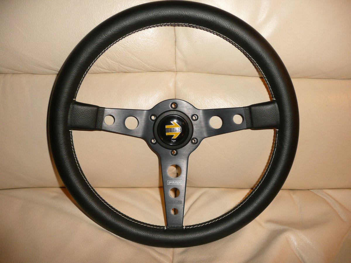

Fitted this 350mm Momo Prototipo for a few days...way too small and look kind of out of place for a coupe.
