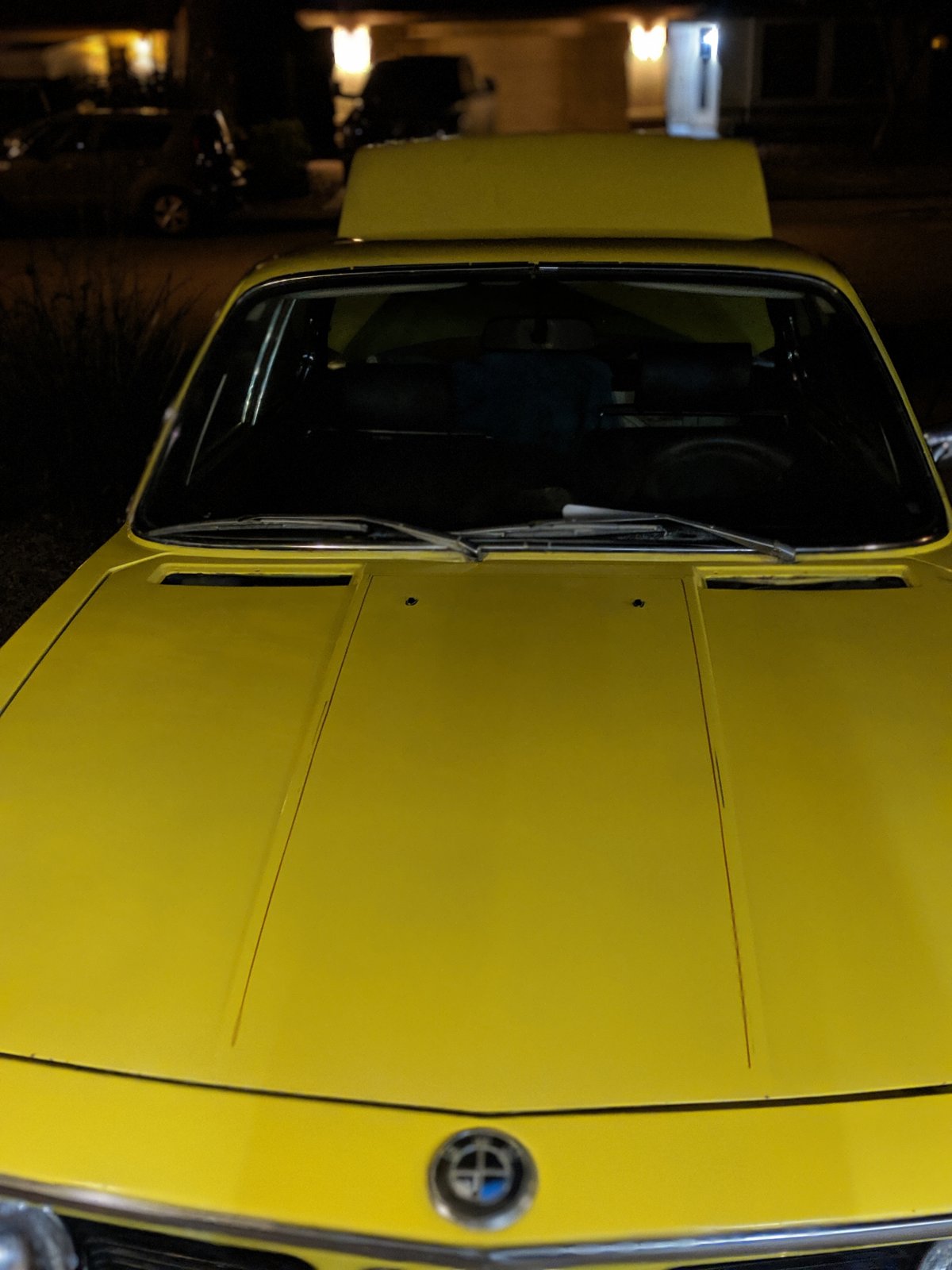

Is this Golf yellow or Dakar yellow?

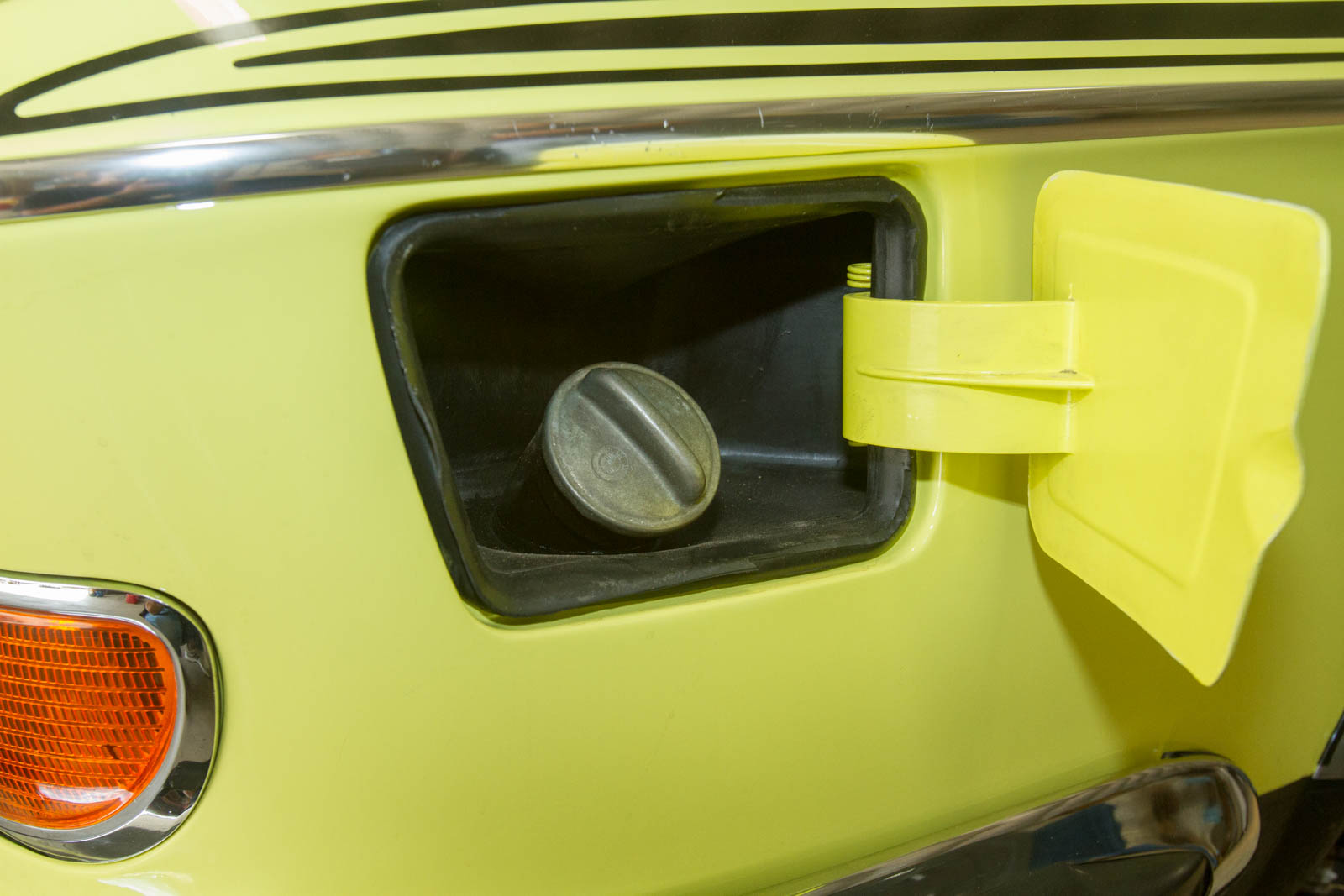

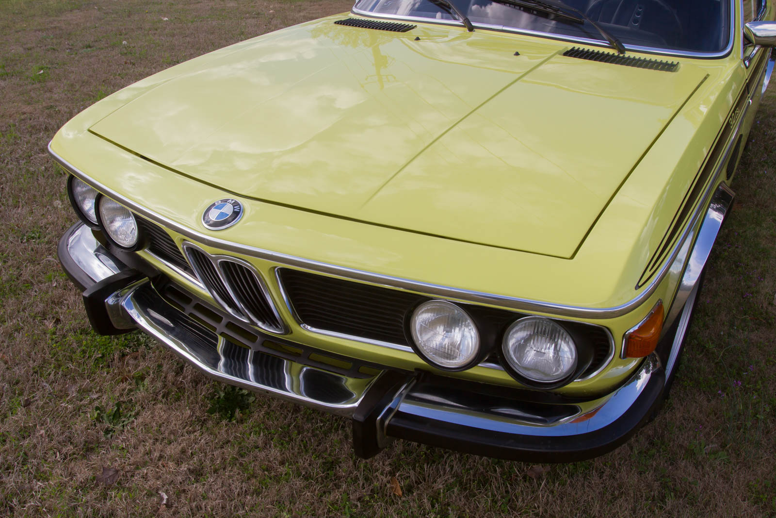

hard to say when its not in natural daylight. here is a detail pic of a true golf CSL that now lives in texas

When you introduced yourself in the other thread my initial impression was your car looked darker than Golf.
Sometimes I also think it's darker or more yellow than golf, but it depends on which image I compare it to. The paint was also badly faded when I got it. What you see in the image above is after a few mediocre attempts at polishing it. I might need to color sand and properly polish it to get the true color back. It's lacquer paint so the original color should come back with a bit more work.

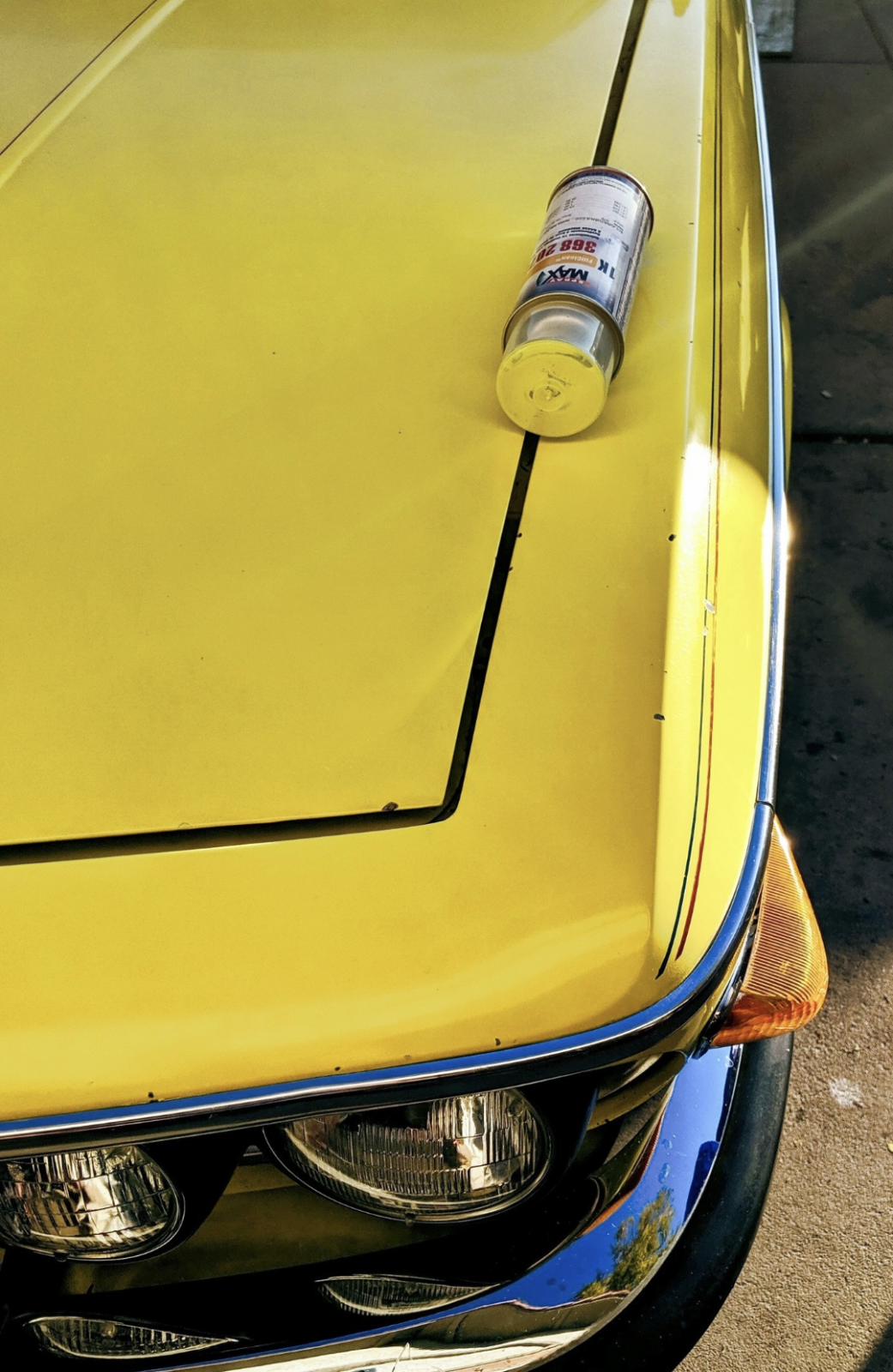

Golf paint can on hood looks pretty close to Golf. Or is it Gulf?

yes - back in the day, golf was known as 'snot' yellow (or green). look at the pic of the trunk above, there is a green flop to the yellow. no idea if there was a clearcoat over the golf paint. i don't think golf was a metallic color and as i remember, only metallics might have had clearcoat
