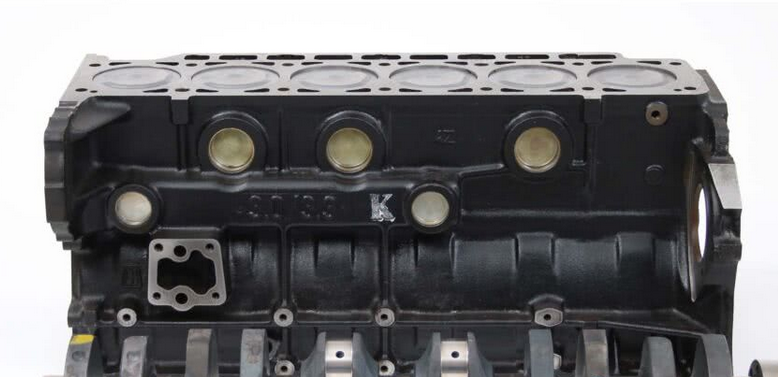

fredel New Member Messages 4 Reaction score 1 Location Netherlands, Utrecht May 29, 2025 #1 Hello, does anyone know what the white K stands for? I found it when I cleaned the engine .... Can't find anything about it. Attachments Witte K op BMW M30.png 339.3 KB · Views: 144
sfdon Well-Known Member Site Donor $ Site Donor $$ Messages 10,172 Reaction score 7,018 Location sfbay area May 29, 2025 #2 To further the mystery- other painted block codes include L, D and B Cam codes include M, 7, 3, K, B
fredel New Member Messages 4 Reaction score 1 Location Netherlands, Utrecht May 29, 2025 #3 Wow!! That’s it. I hele read the article about the camshafts here. Thanks you so much, One less riddle
