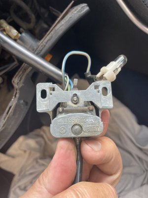

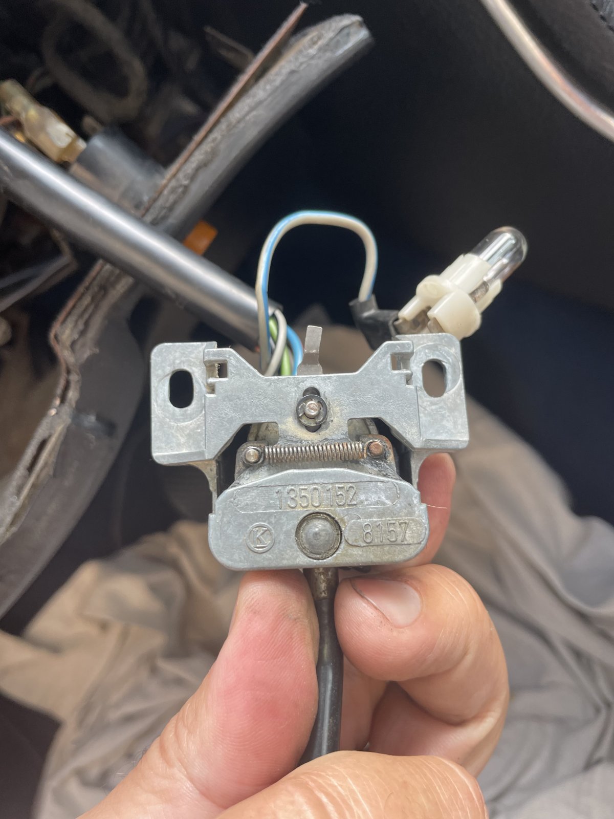

My CS is a 1972
The right turn signal will click once with appropriate dash indicator - then stop Left blinker would indicate on dash most of time - but oddly not always.
When I opened up steering column to see switch , I noticed prior owner had stuck a rolled up piece of paper in the gap of the switch between black and metal sections. Strange.
I’ve read most of posts here on the subject, but have not seen info on who I could send this to for a refurbishing / rebuilding.
Guidance welcomed as my restoration has stalled until I get this switch working properly and consistently.

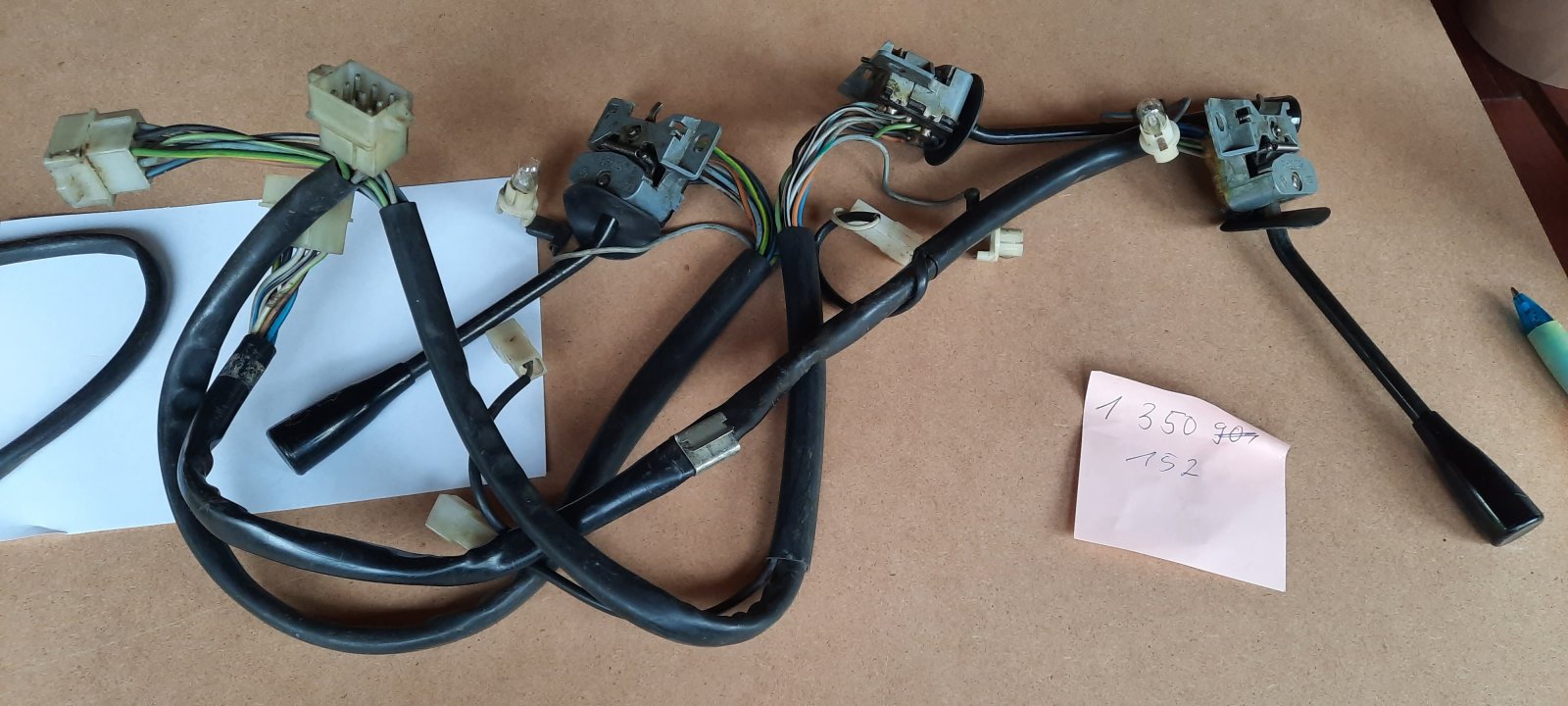

Update: Obtained different used turn signal stalk. Same result ! If I push on the base of turn signal stalk toward driver it works . Hard to believe same problem with two different stalks?
Not sure where to go from here .
