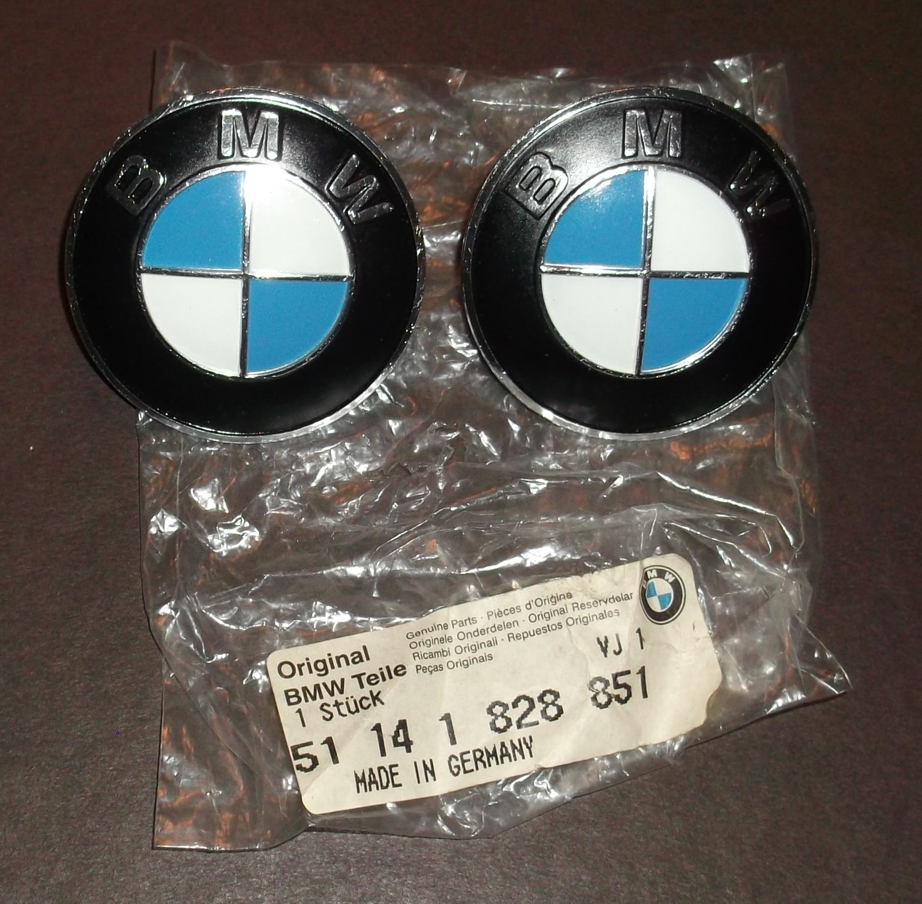

I suspect that Cloisonne roundels ended with the e9 c-pillar badge in 1974, when they switched to raised letter roundels. I've seen '74's for sale with these roundels. Some folks like @adawil2002 have them on their car. Regardless of when the change happened, I believe that it did happen much earlier than the 80's.
Hard to judge scale from this pic, but these are the little c-pillar roundels. According to realoem these started in 10/73 - which would be a 1974 model year.
http://www.realoem.com/bmw/enUS/par...00CS&mg=51&sg=20&diagId=51_3905&q=51141828851

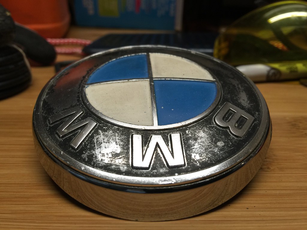

This is my rear roundel. I think the originals looked like this: Soon to be powder coated :D
