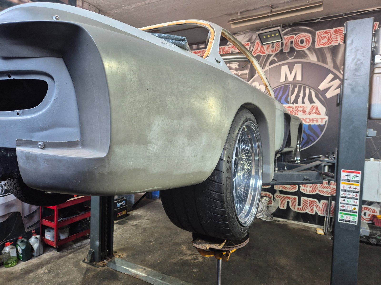

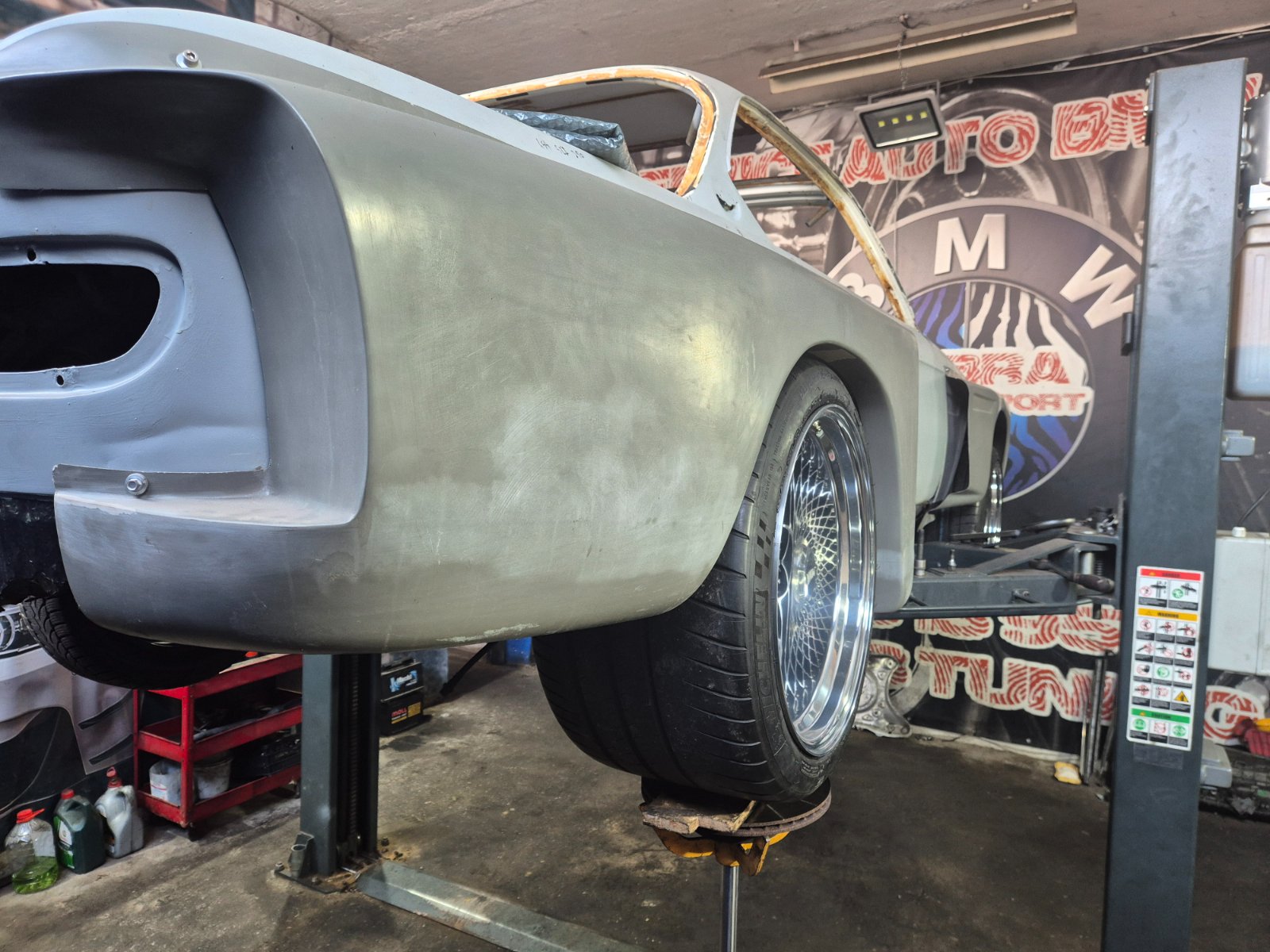

I built some 14x8 Weds bavarias where all the width was added to the outside:
On the rear arches lots of people say they have theirs rolled, but there are two layers of thick steel there. Grind, yes, rolled, no.
Really good to know!
Edit: read through the thread, this is perfect info and I love the look. Did you put a 195 section tire on a 8” wide rear wheel though?

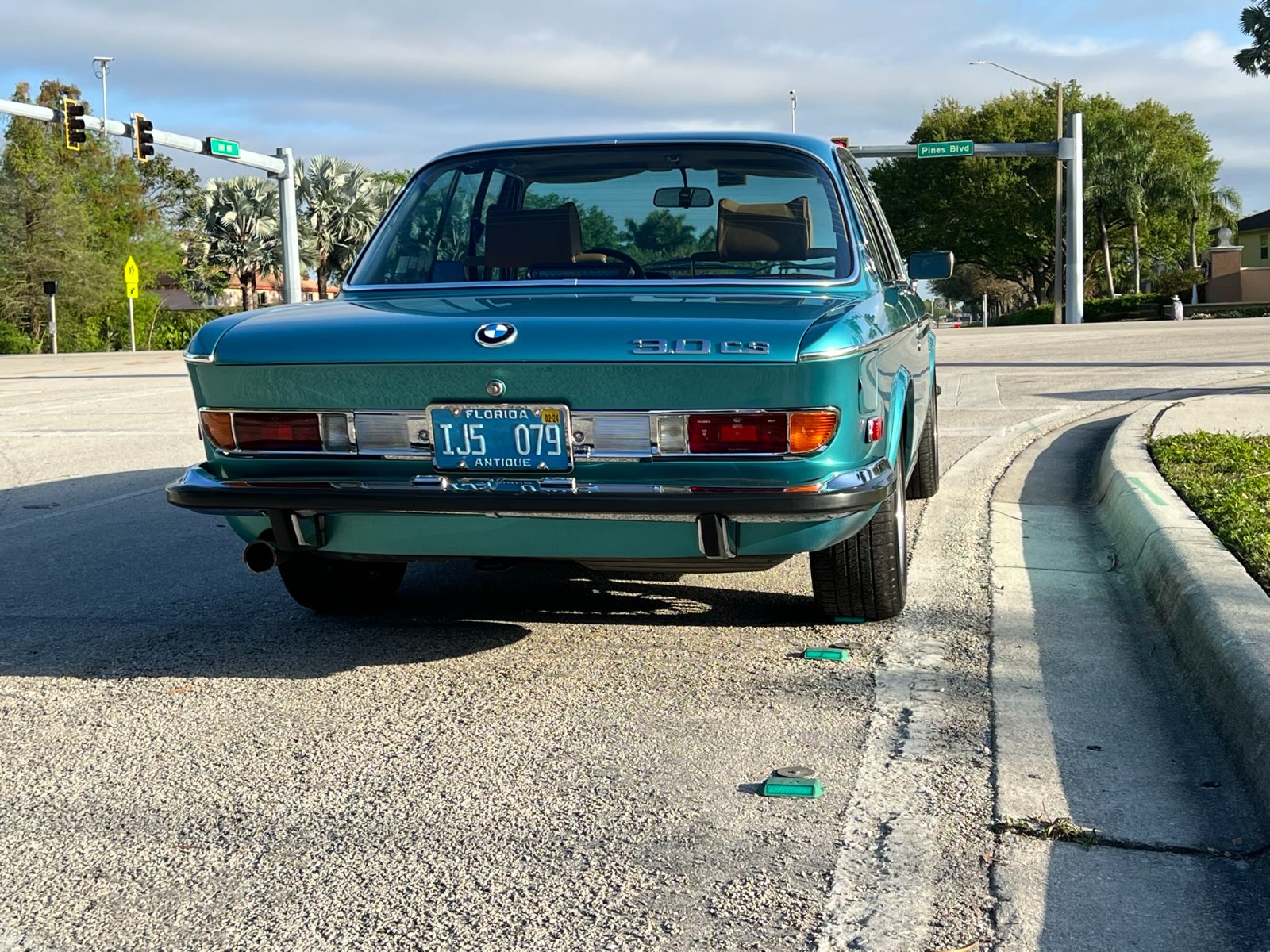

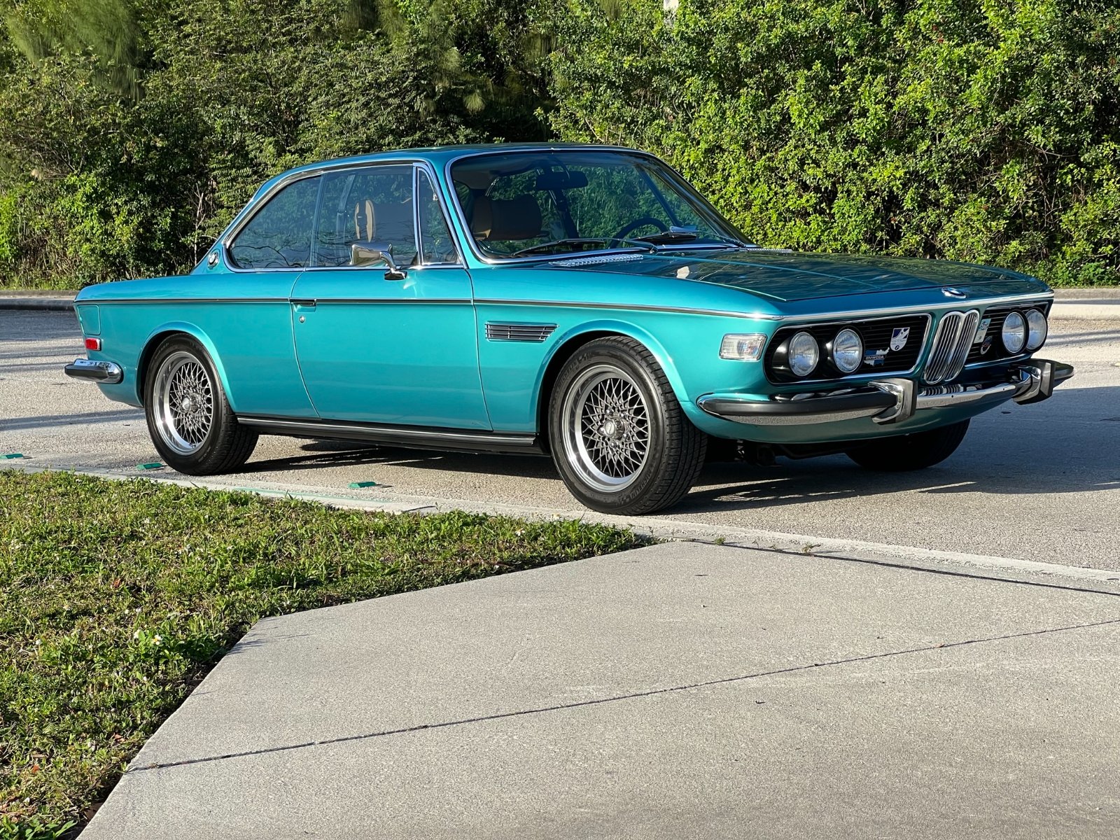

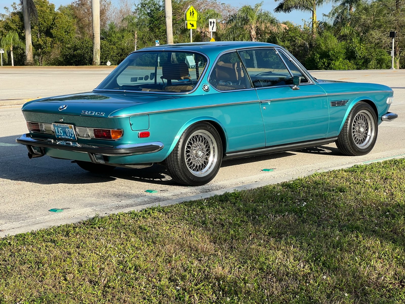

I have 16X7" BBS Mahle ET11 wheels on my coupe. The previous owner I'm pretty sure put Carl Nelson lowered springs all around, big Suspension Techniques anti- sway bars and Bilsteins. The front fender lips needed to be rounded and the rear lips are original. The Michelin 205/55 ZR 16 tires have just been replaced with Continentals after 20K miles.
The tire shop found 2 of the 4 BBS wheels needed to be trued due to slight dents that I never felt while driving. Low-profile tires and a very stiff suspension probably caused the wheel dents.
I'm just adding this to the conversation for help in deciding wheel/tire sizes, offsets and suspension setup. My car has almost no lean when going around fast corners. But I have no other coupe to compare the suspension at speed.
Pics for comparison.
