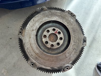

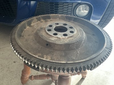

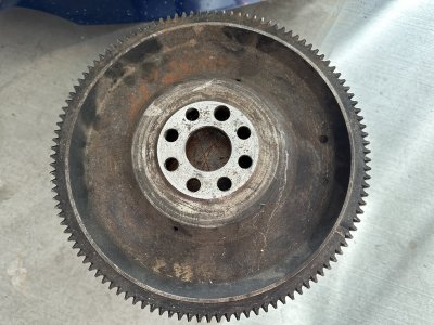

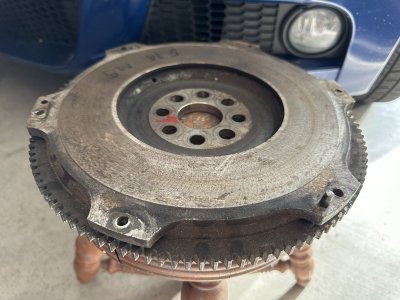

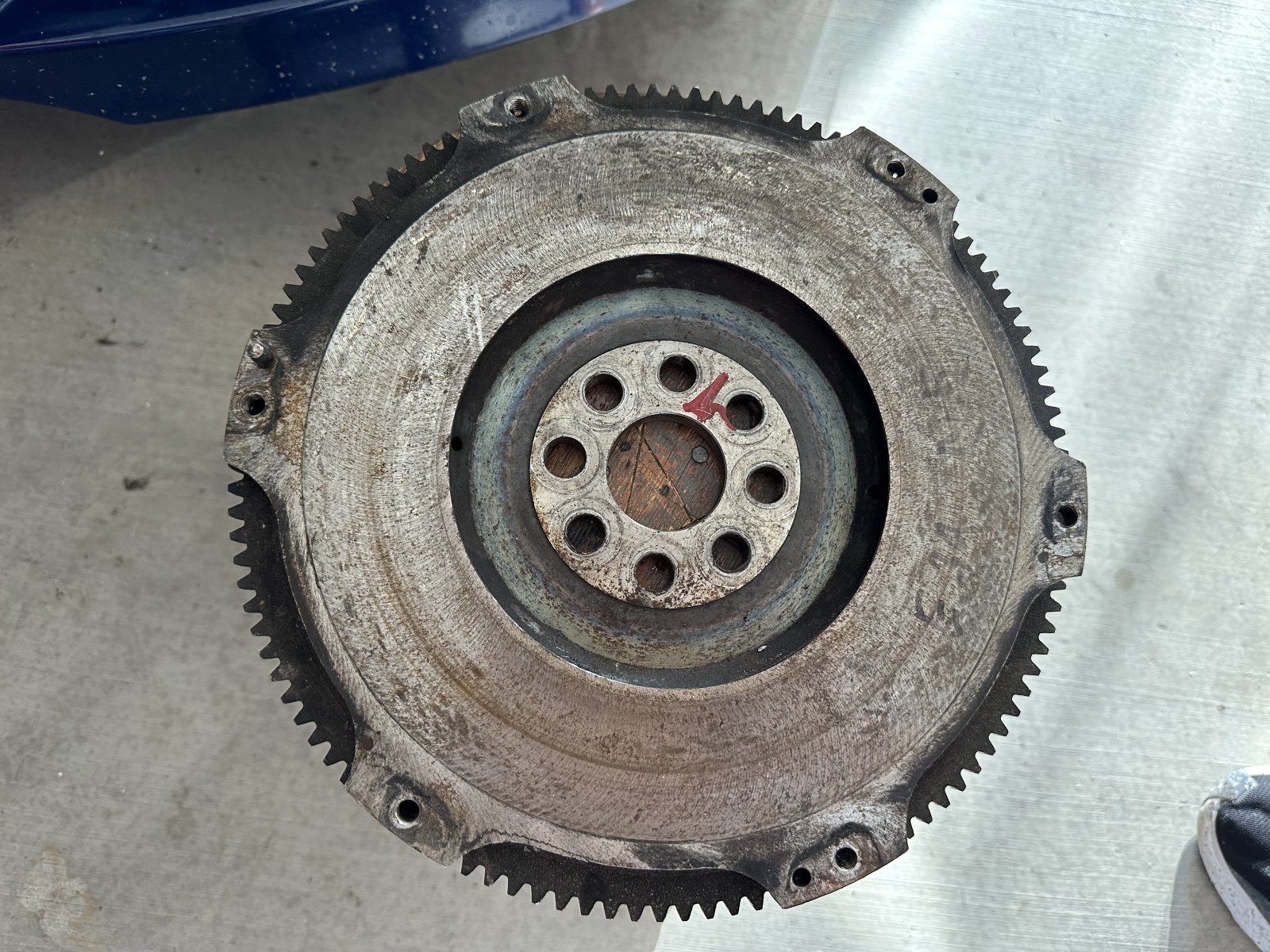

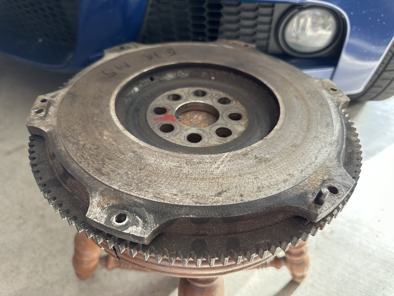

Thanks for reply. See pics, pretty sure this is single mass.

You need 2 more dowel pins
11221744338​
The USA
M5 e34 flywheel is unique in the bmw world.
no other model used it.
You will need a M throw out bearing
21512226729​
