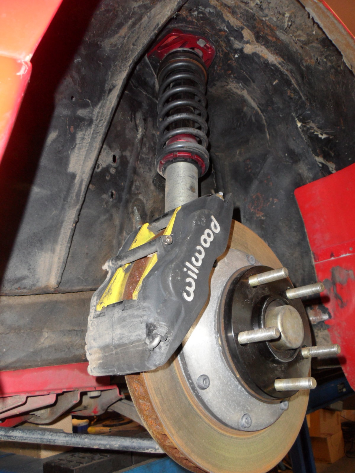

for rally i used the Wilwood fronts.
But with a Tilton pedal box ( easy choice in MC diameters ) and bias valve for the rear. With the oem pedals it didn't work well... not enough leverage.
PS at least 16" wheels needed.

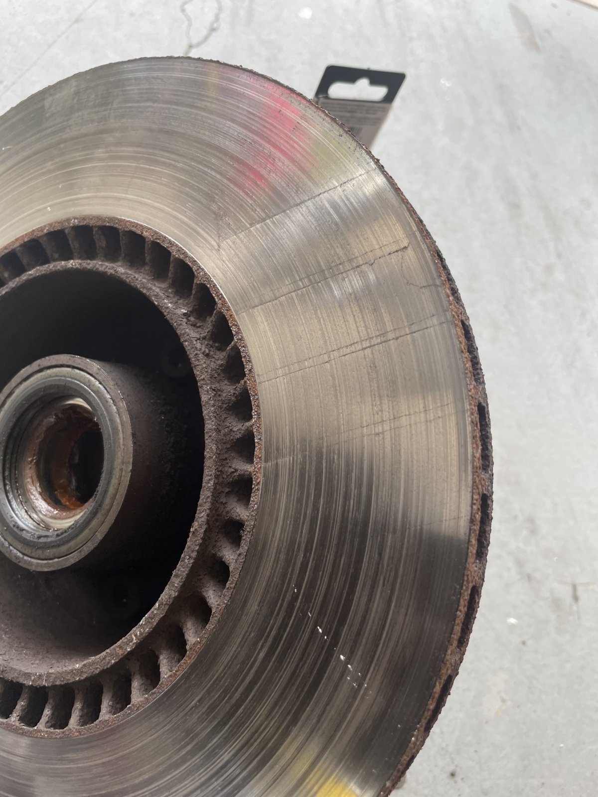

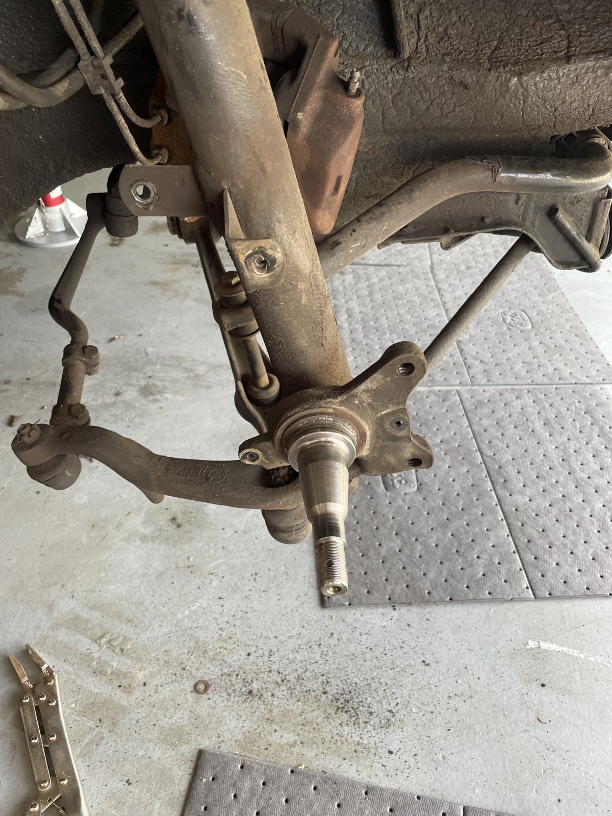

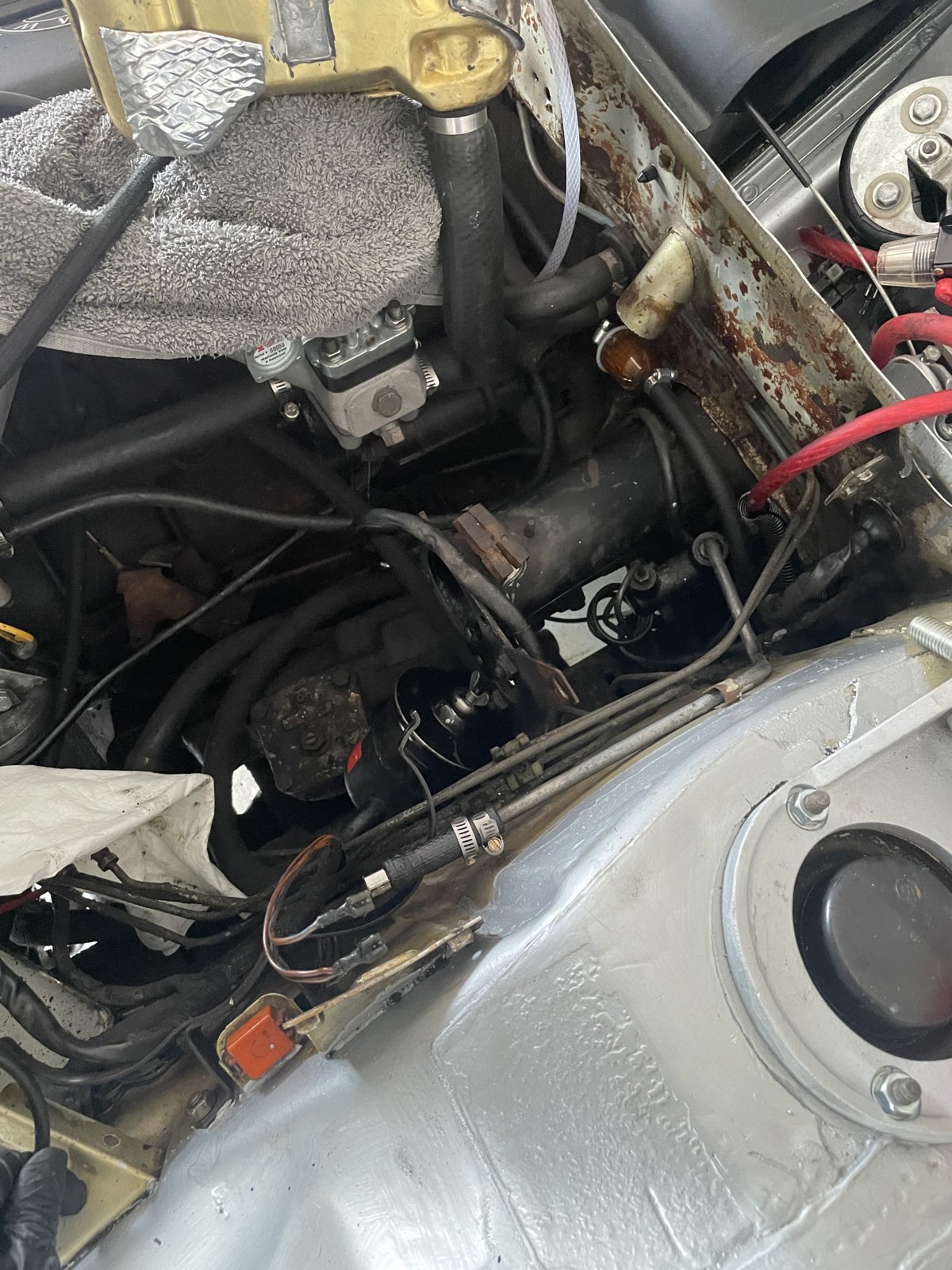

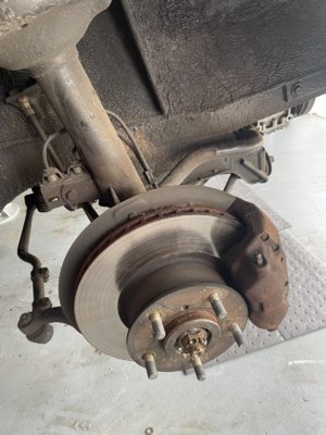

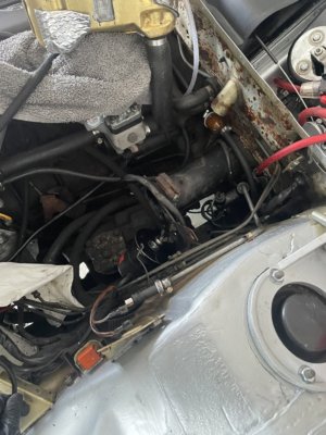

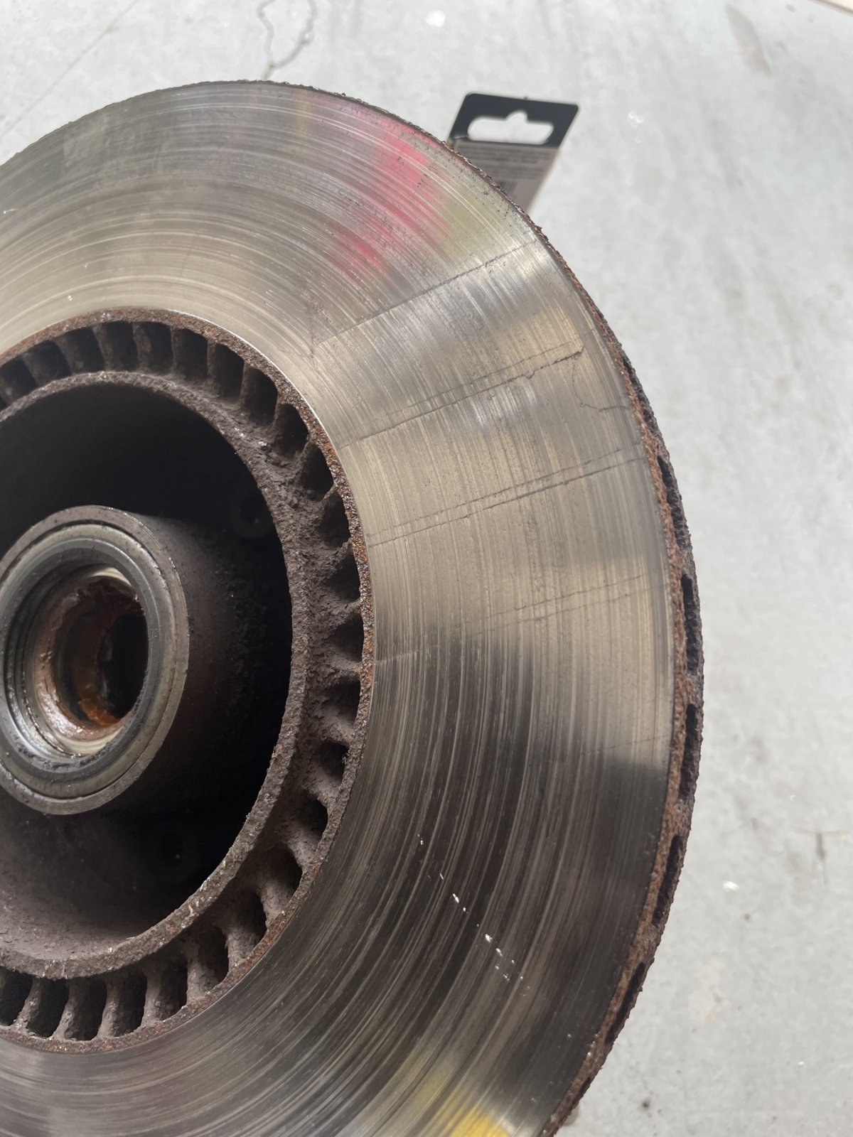

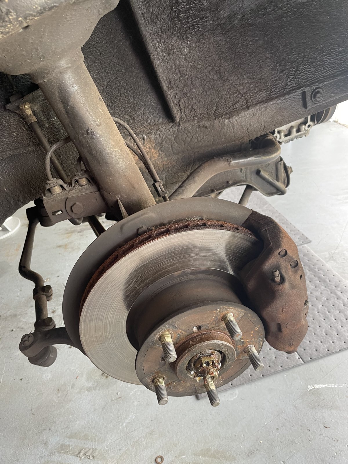

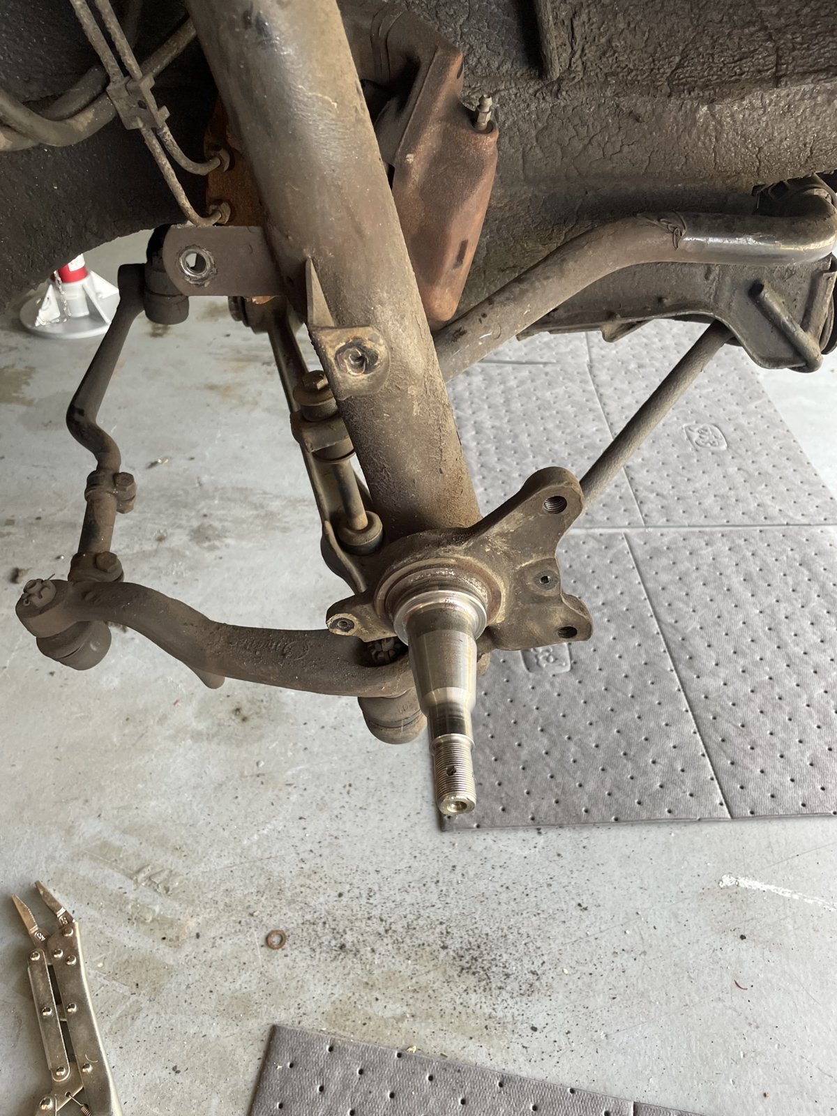

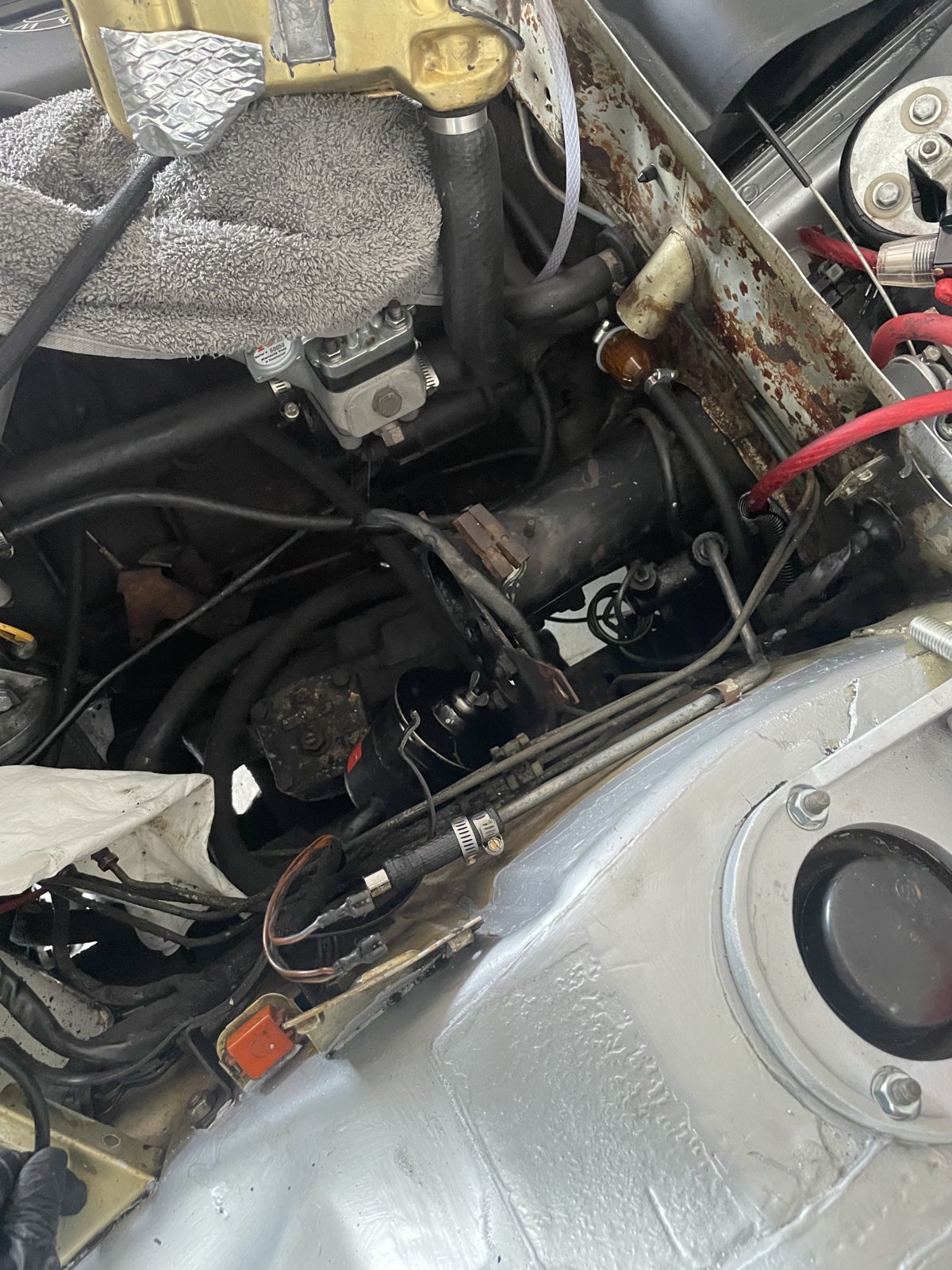

A bit of where I’m at. suspension and brakes on mine have not been serviced in a decade or two. I’m sure I could refurb the calipers but would rather future proof for the chance at engine swap or mods to the m30, so have gone ahead and pulled the booster, master cylinder, struts, and some suspension bits. It’s looking more like I should replace all the bushing while I’m in there. The pads seem to have imprinted themselves on the rotors while parked for years. I would love to open up more space in the engine bay.

I’ve already have the Ireland engineering kits and the recommended MC. Going with Koni coil overs via Ground Control.

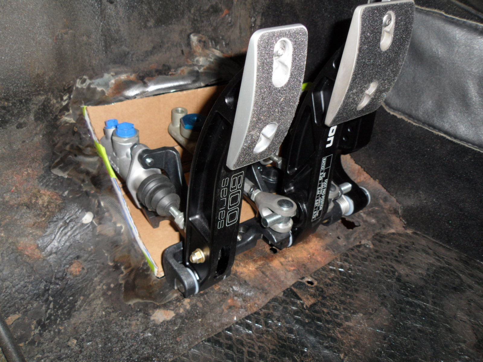

Which Tilton pedal box did you use?

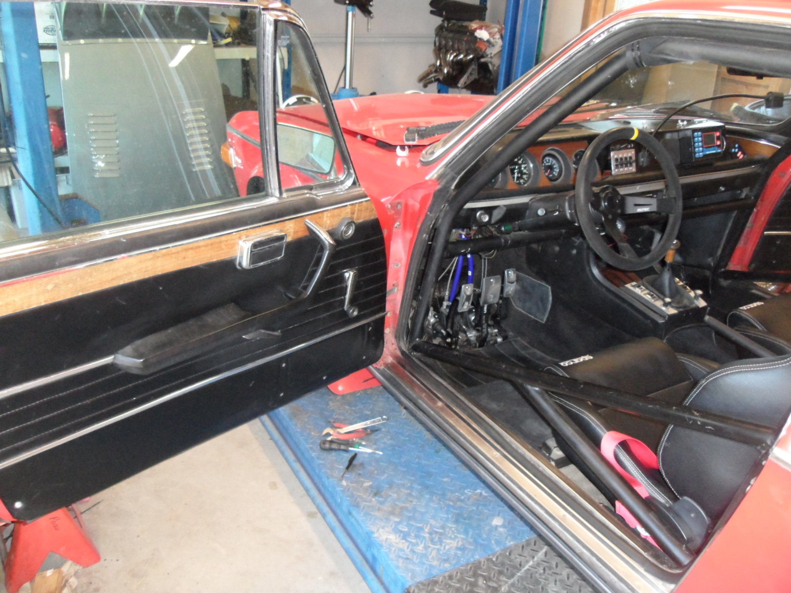

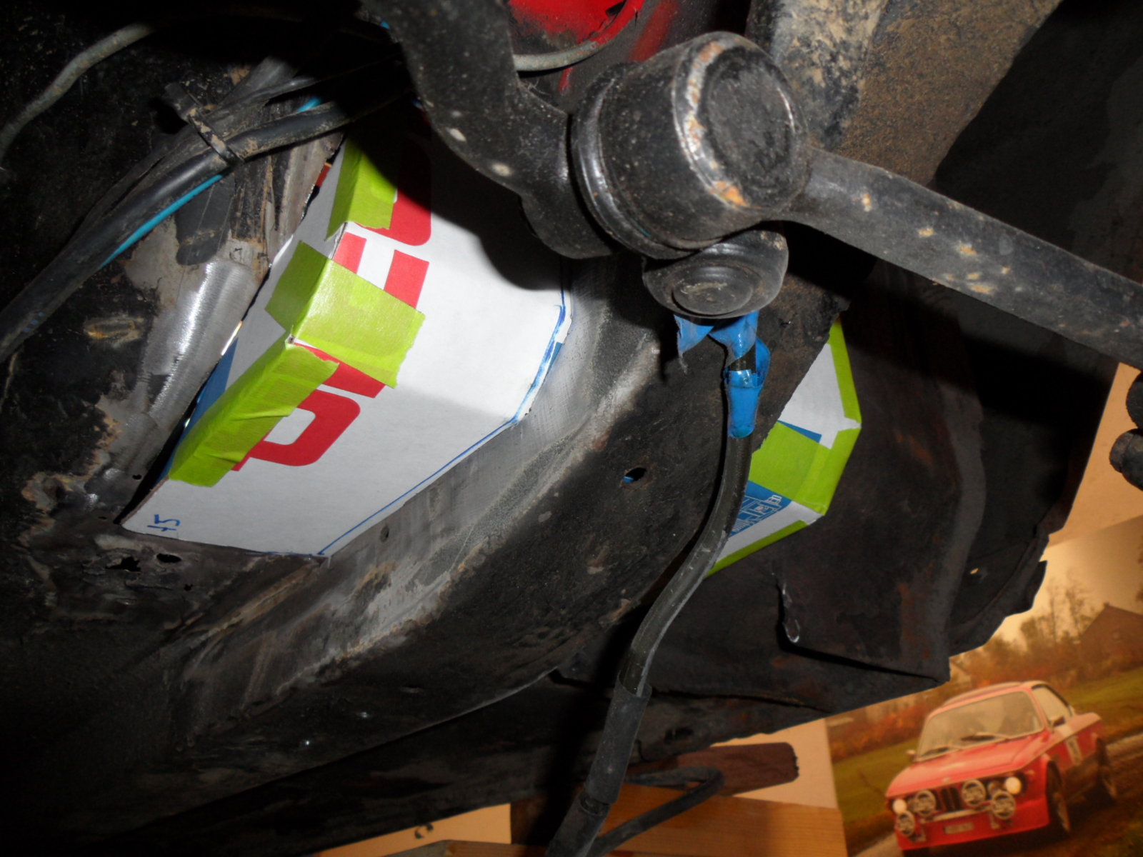

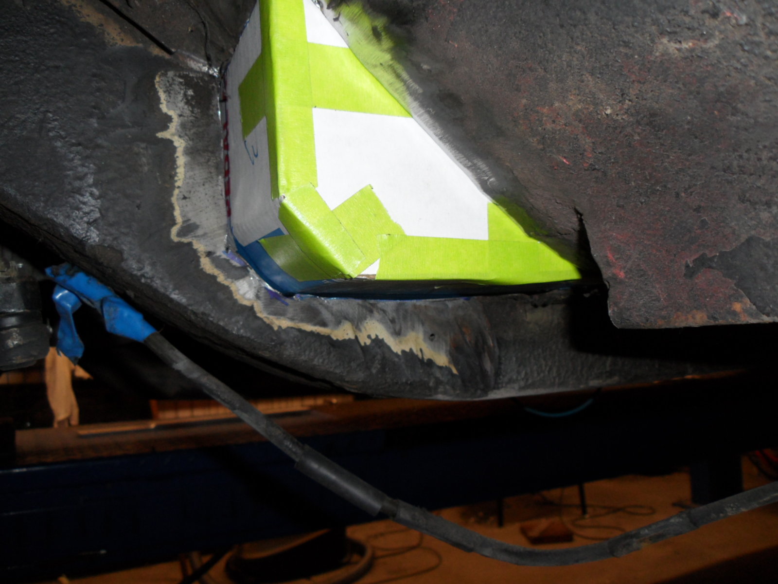

Pedal box is with dedicated MC's front & rear.... and no booster at all.
We needed to weld a extra box in the chassis floor to make room for the pedals.
