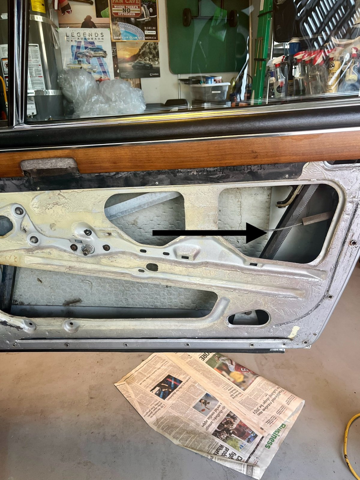

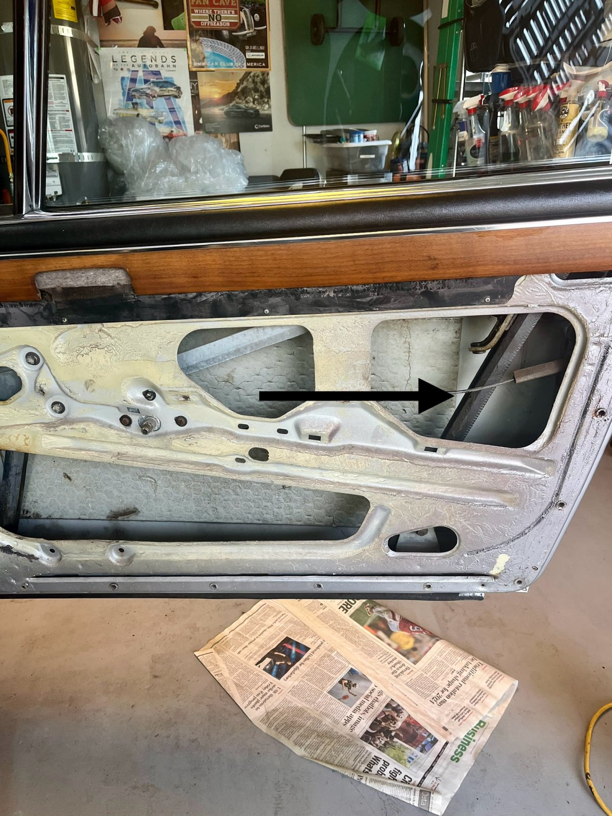

While I have my door cards out I thought I should grease my window channels. My passanger side is a bit stiff. Does anyone have a recomendation of what grease to use?

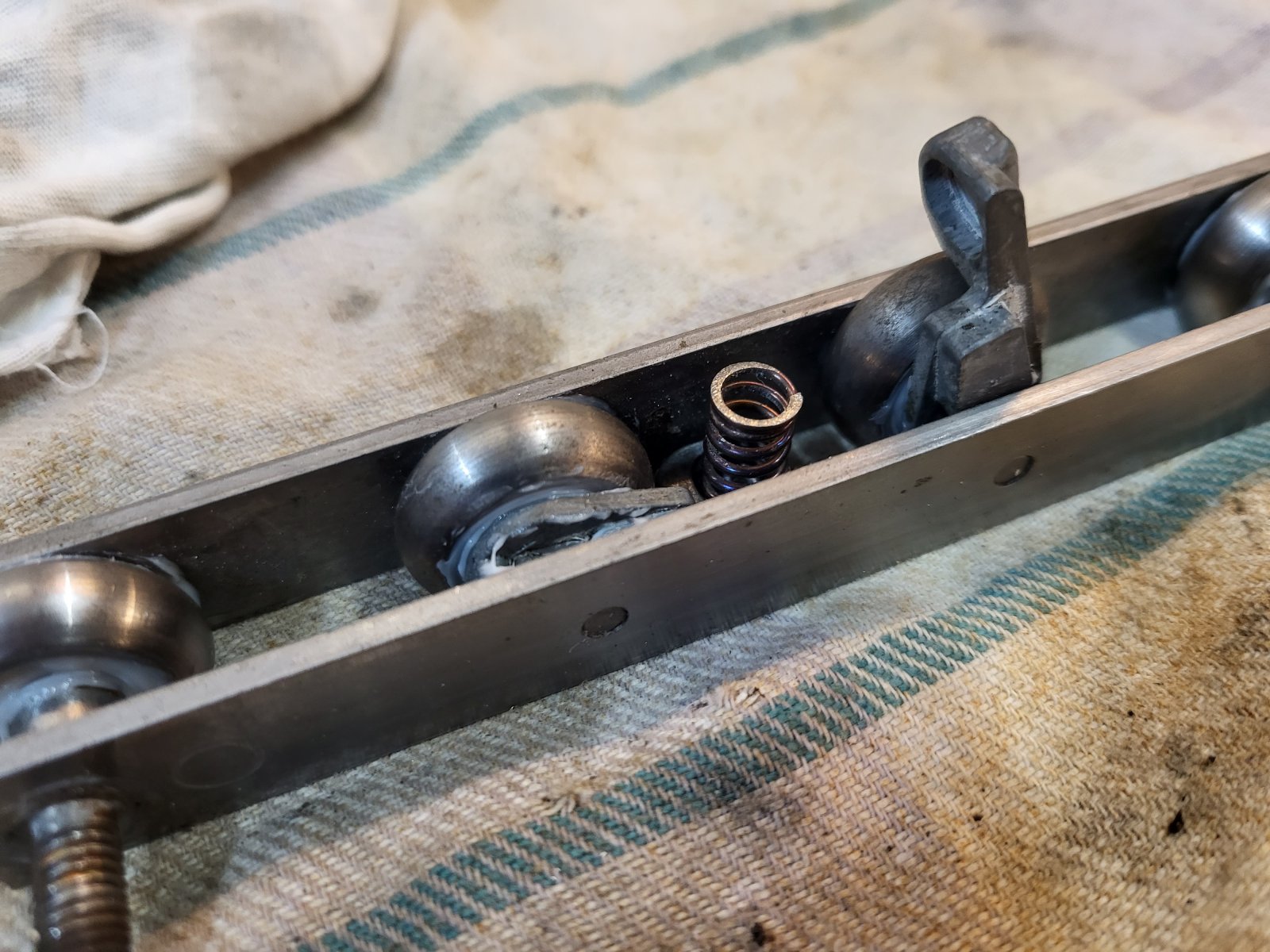

I've just removed my window tracks, and the system is actually quite robustly engineered (It uses a spring loaded bearing sled) and it has the ability to run really smooth.

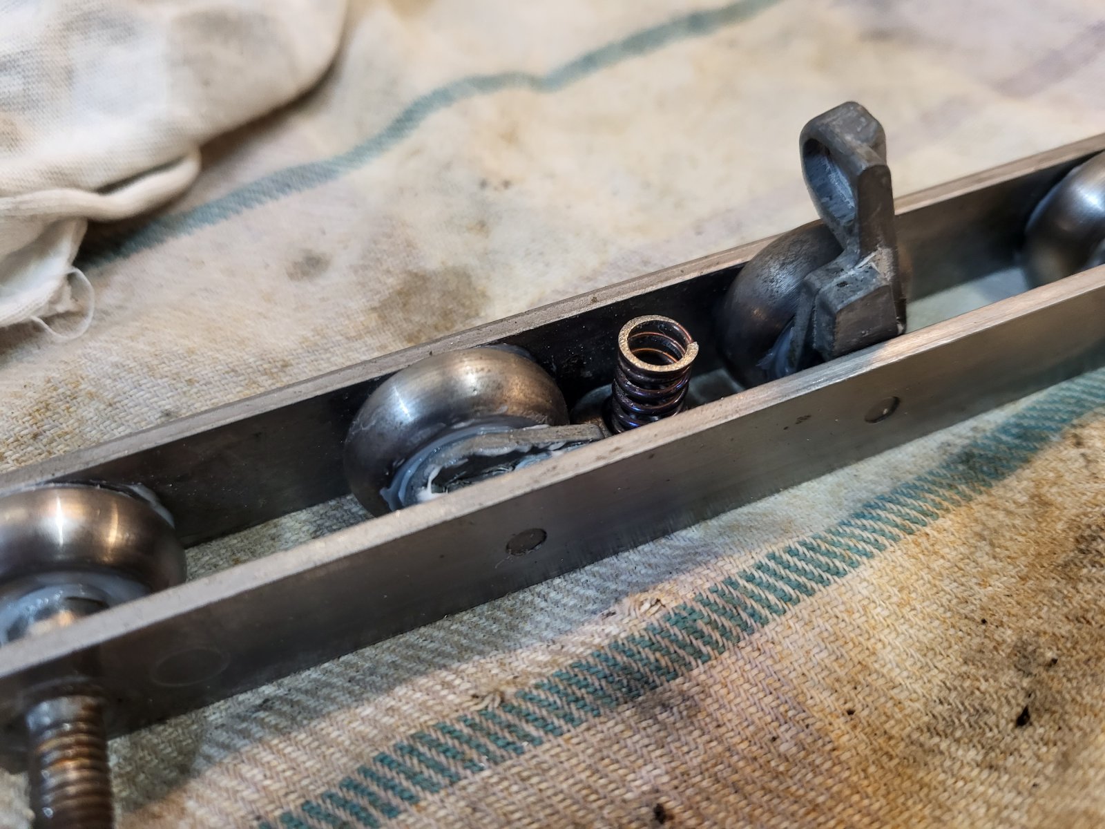

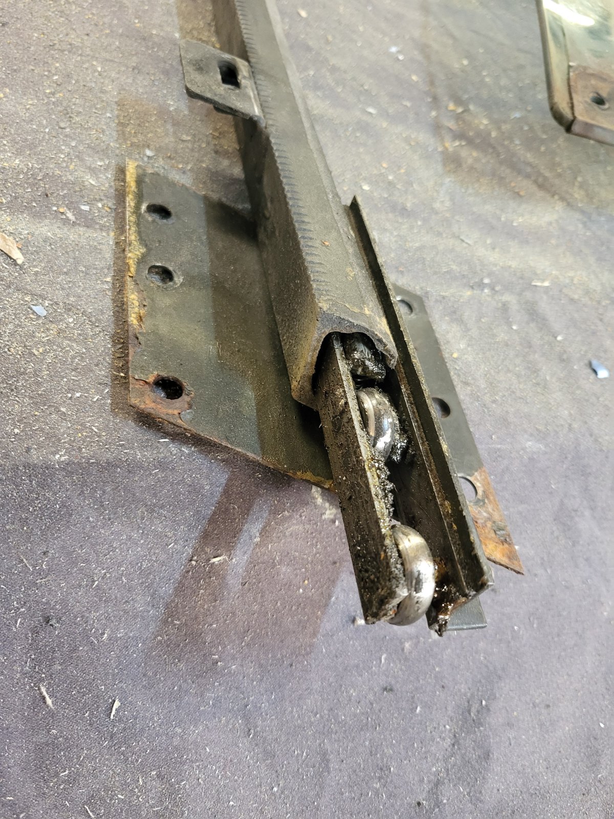

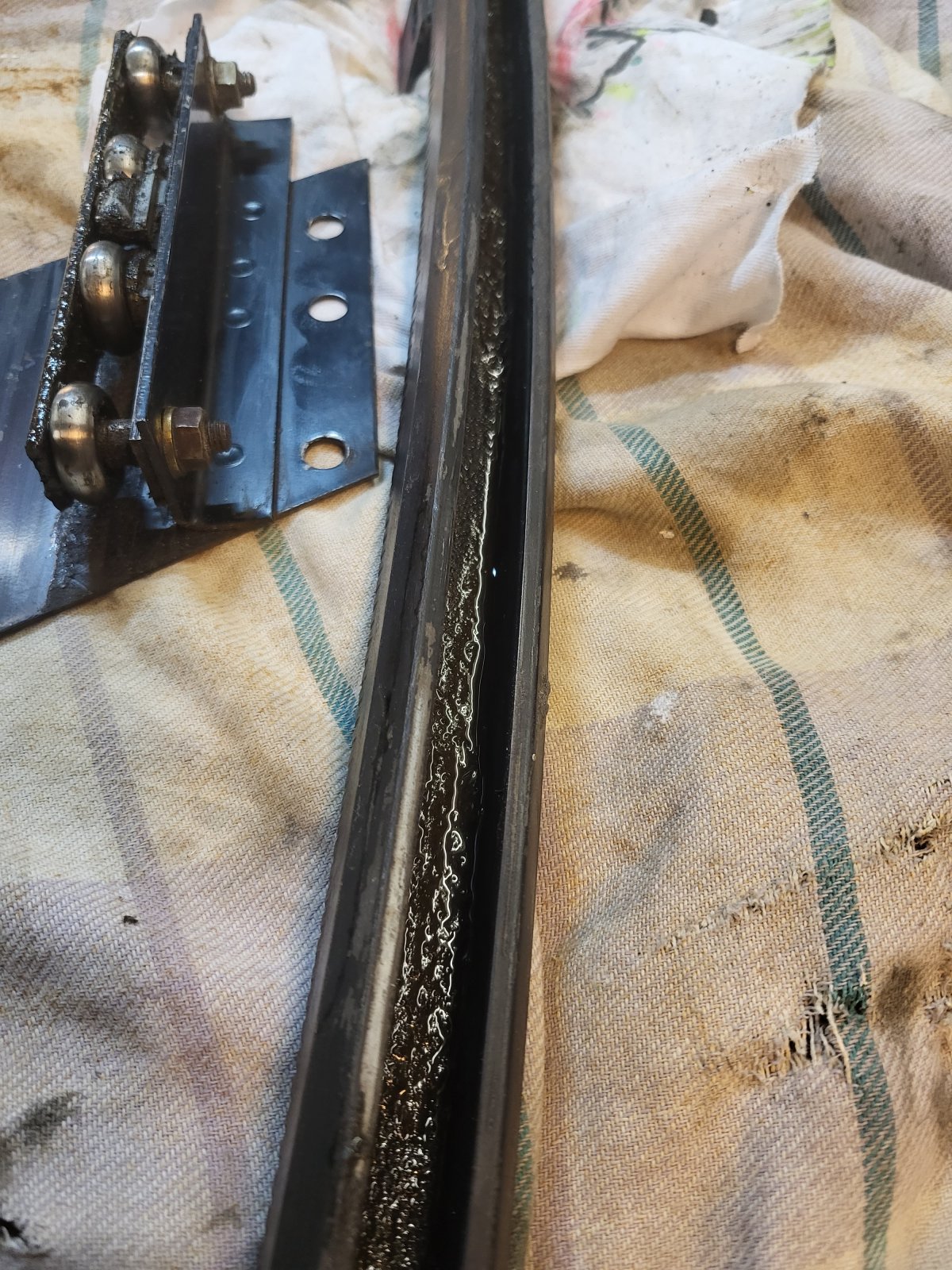

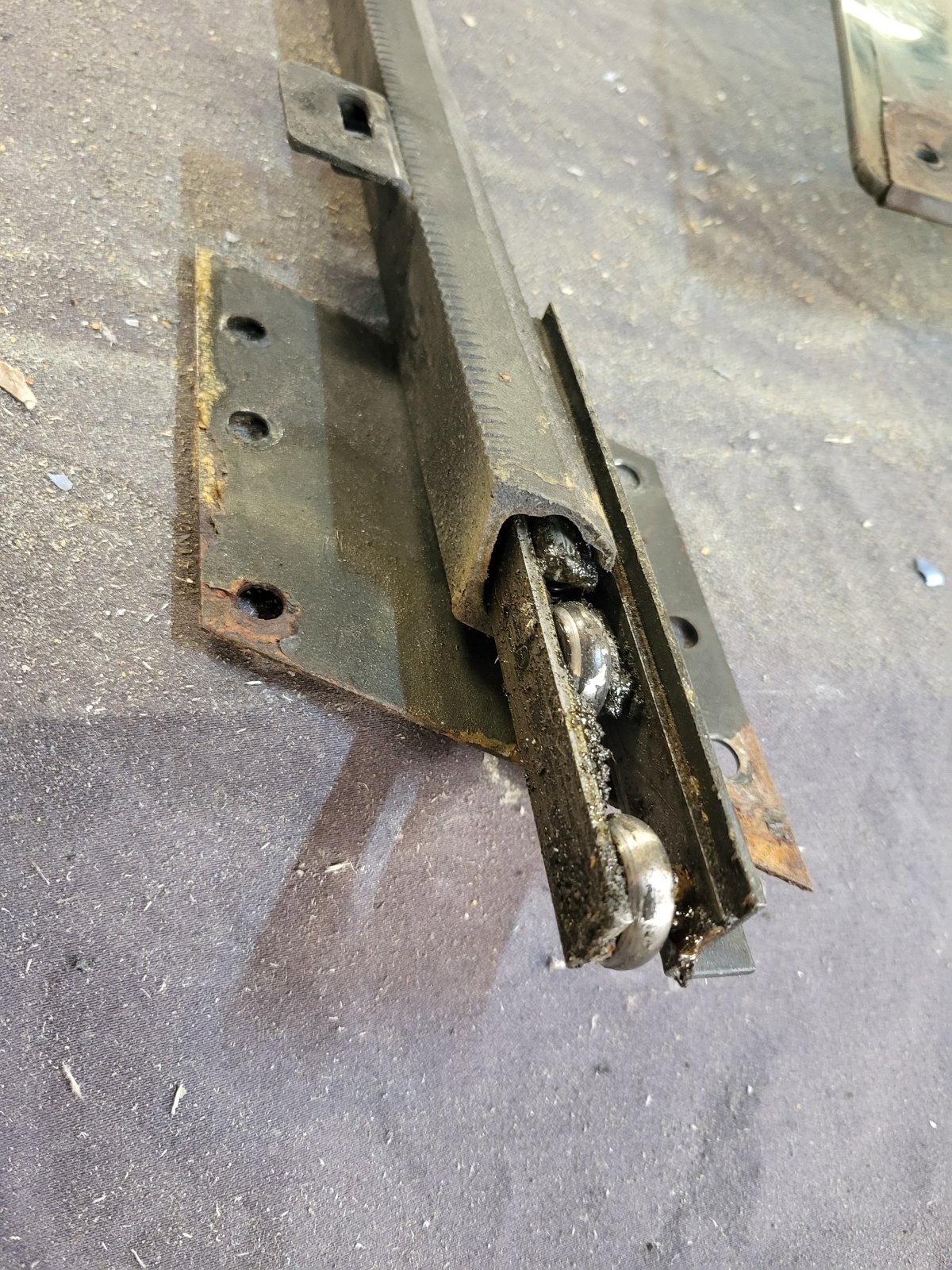

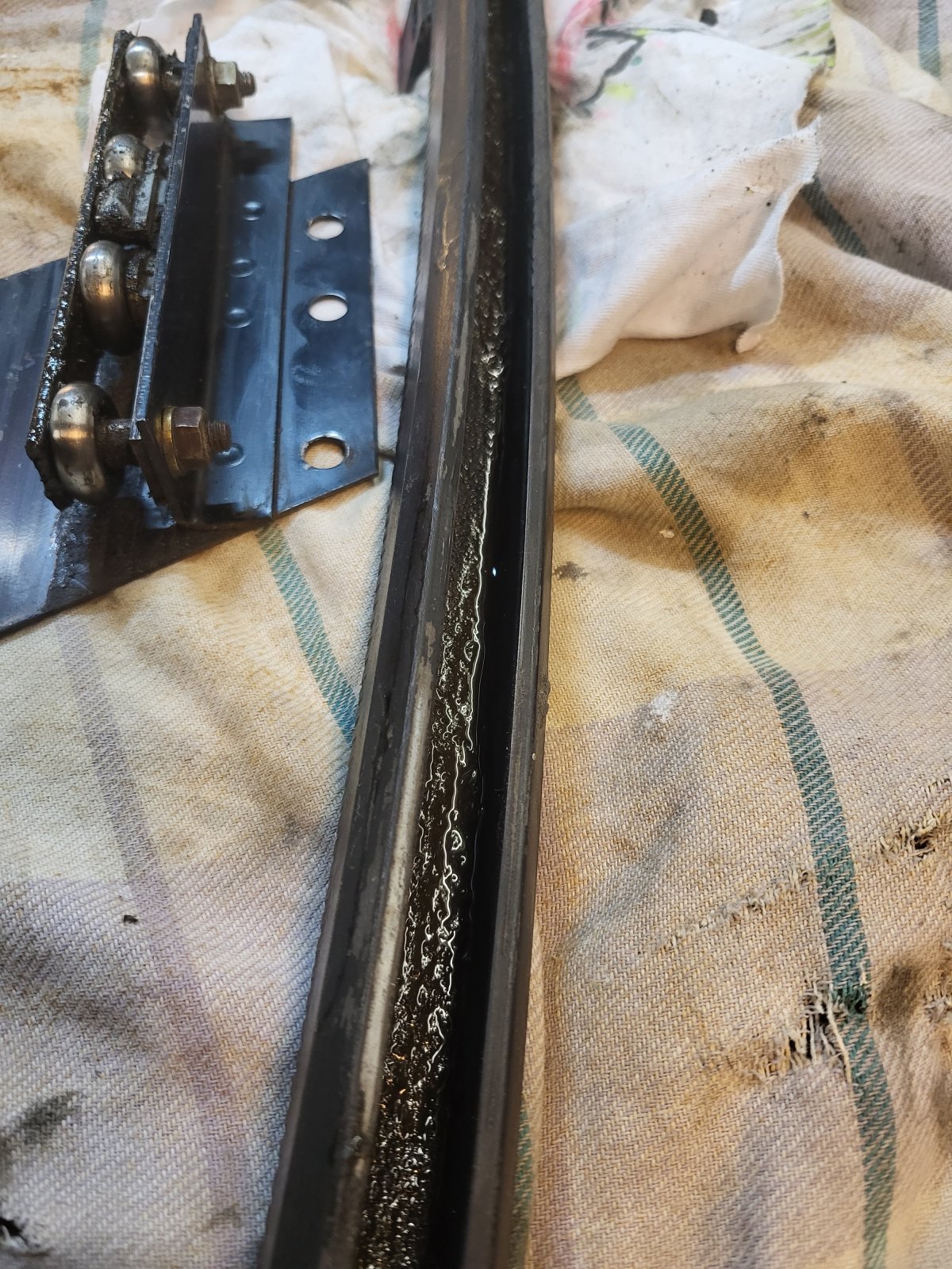

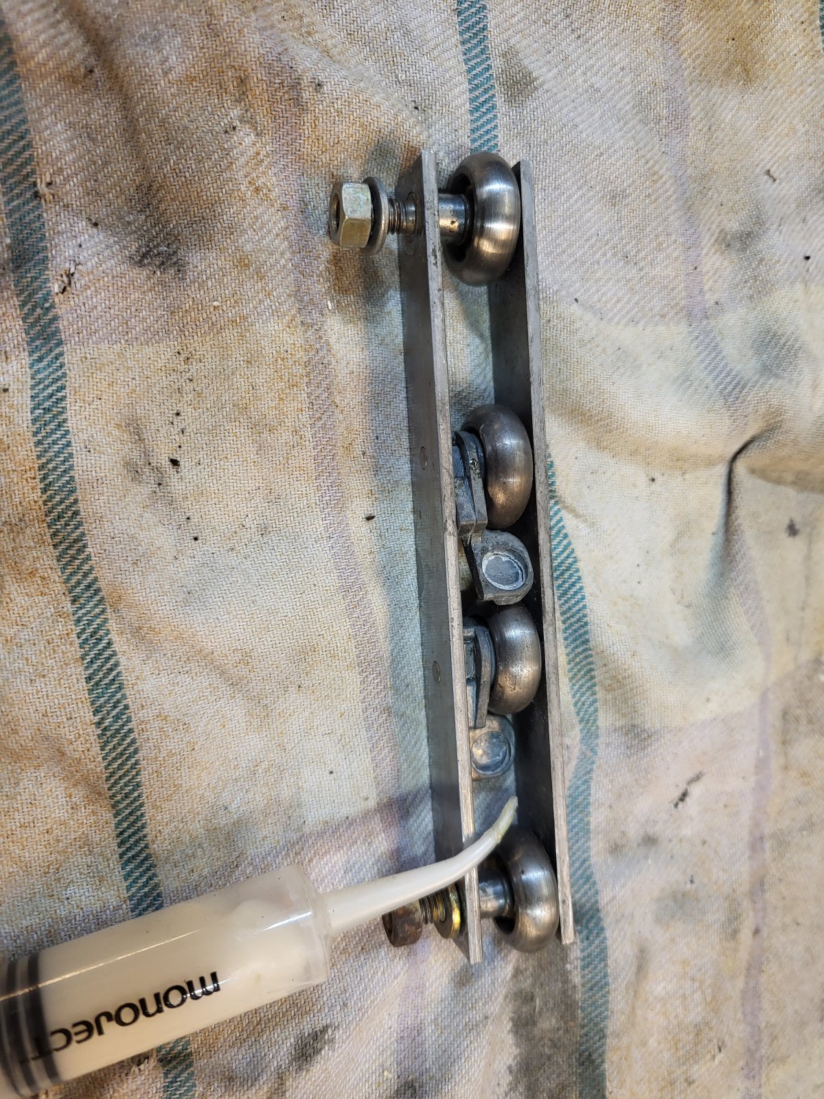

here are some pics of the right door that i just removed from my car. Just adding some addition lube on top of the gummed grease woulnd't have made any difference; the spring loaded wheel bearing sled was completely solidly gummed up. It acted as a sled, with all 4 bearings being jammed.
Also the track was full of gum, in some places up to 10 mm think (close to half an inch).
Herewith some pics to show the dillemma:

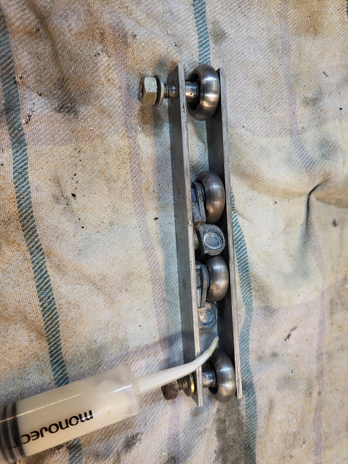

Gummed up & locked bearings:

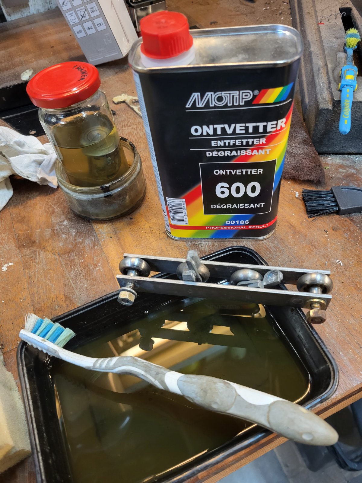

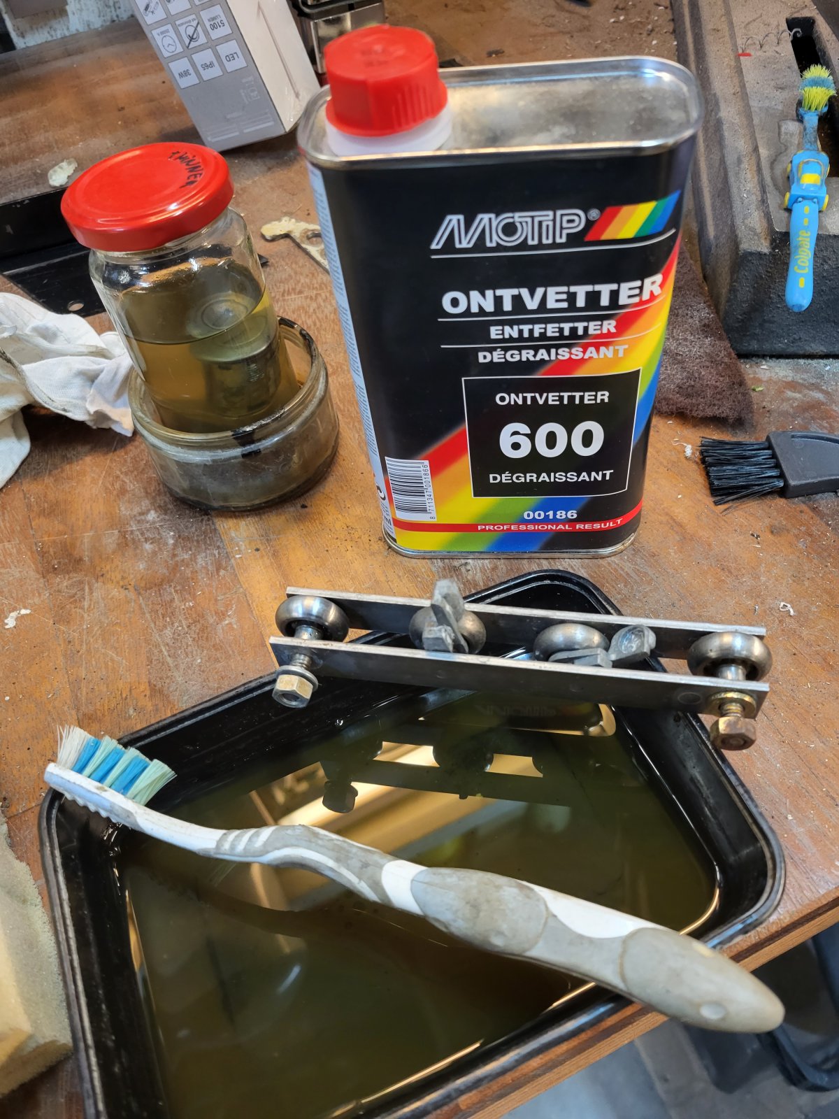

Cleaned by hand firstly to get rid of chuncks of old grease with a screwdriver, and followed by a toothbrush:

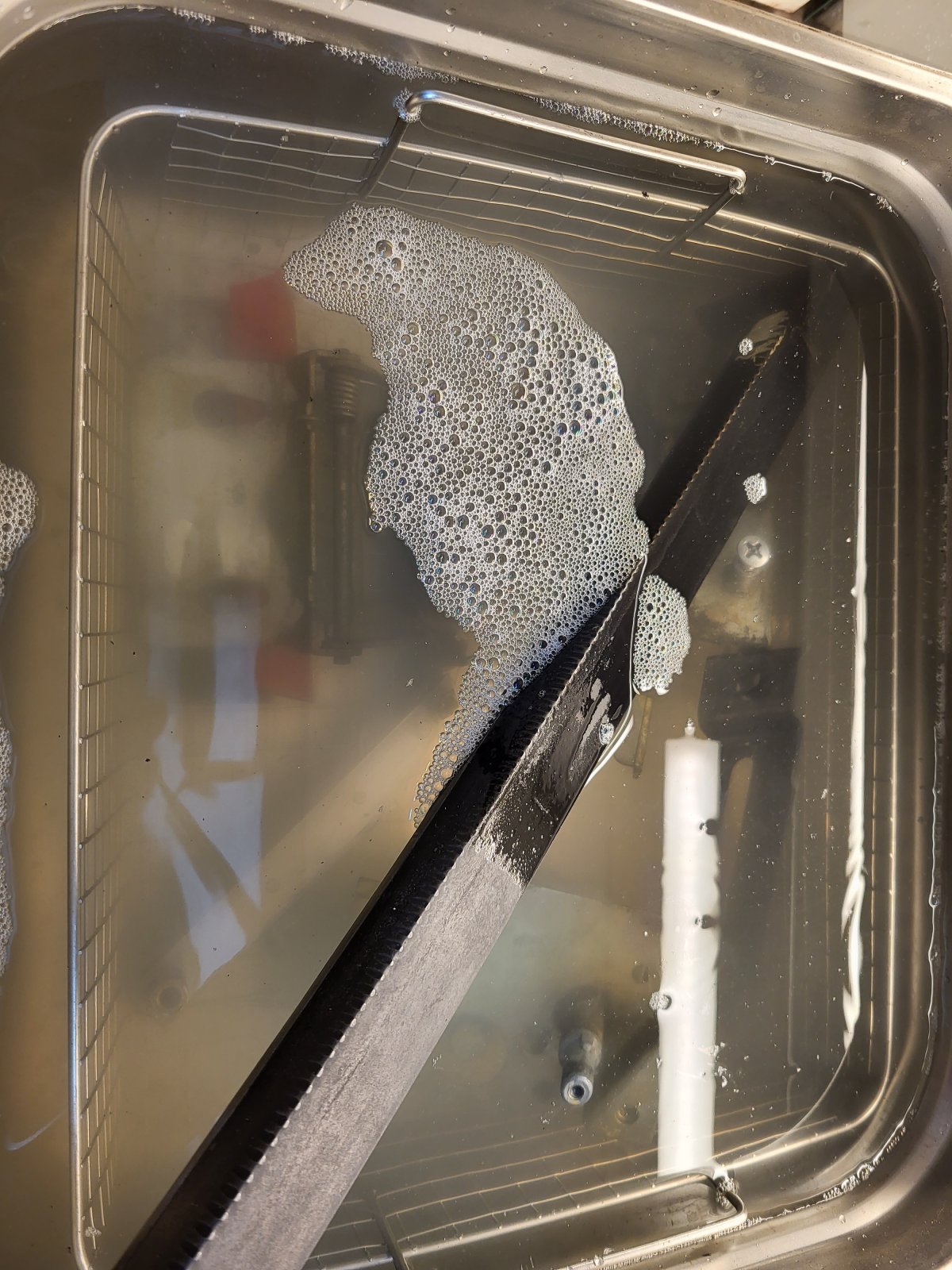

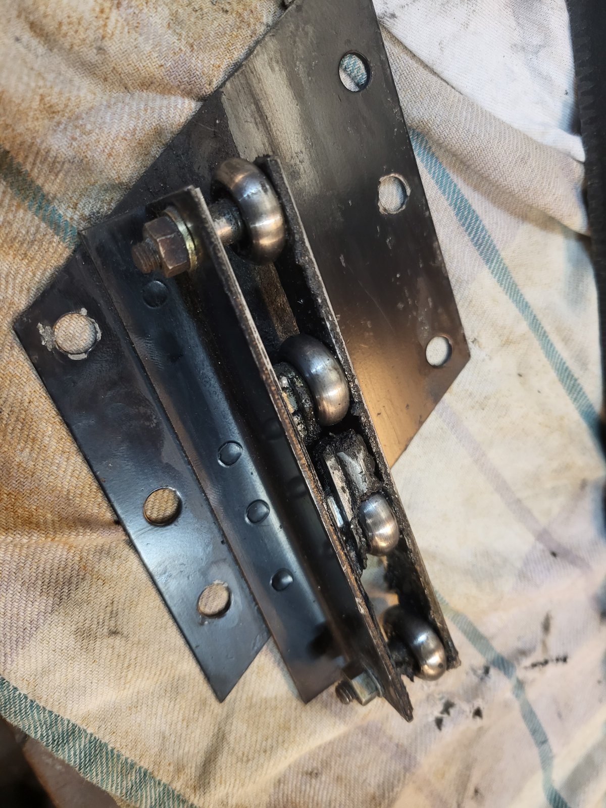

followed by cleaning with ultrasonic bath to get the insides of the bearings cleaned:

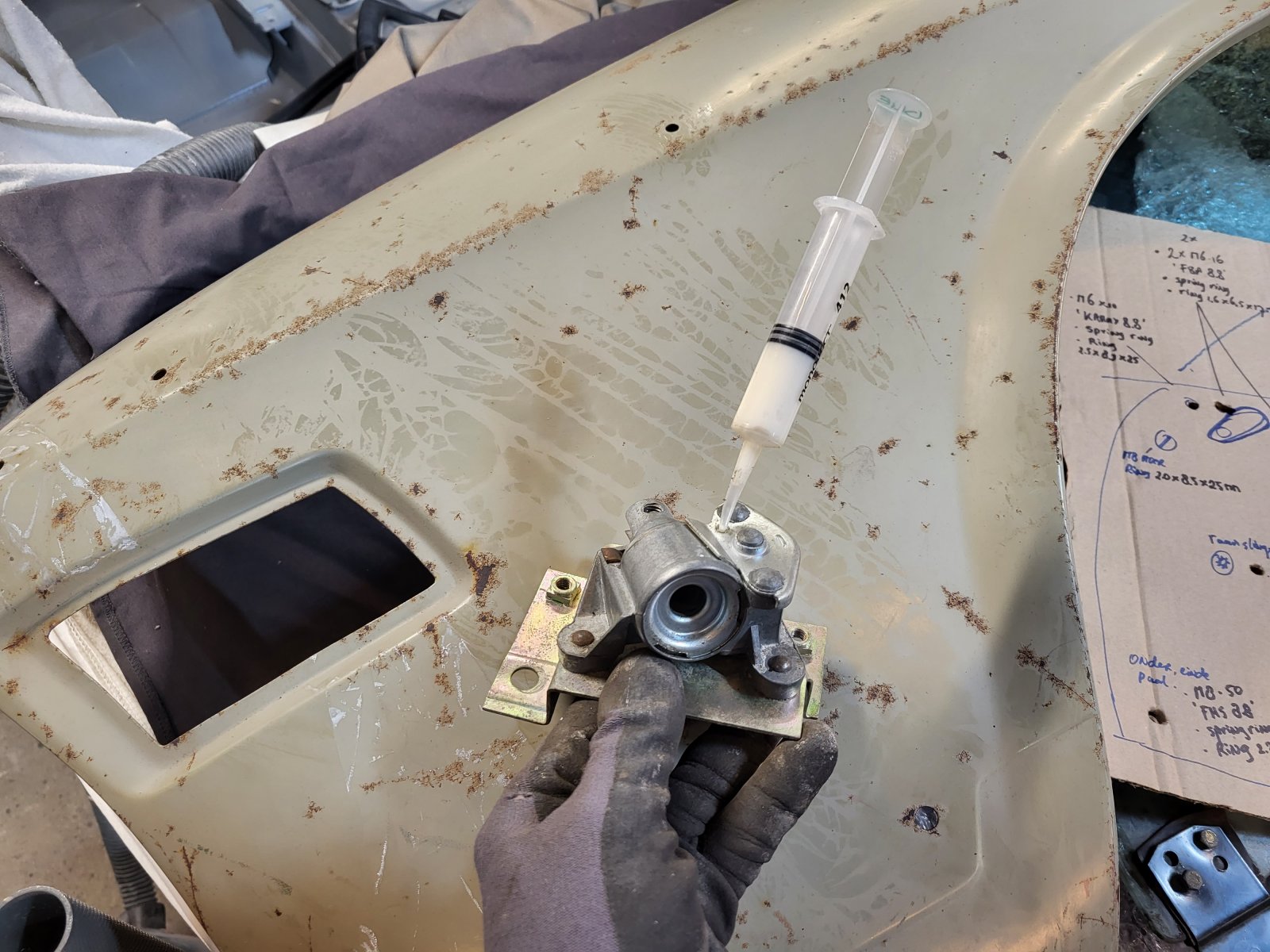

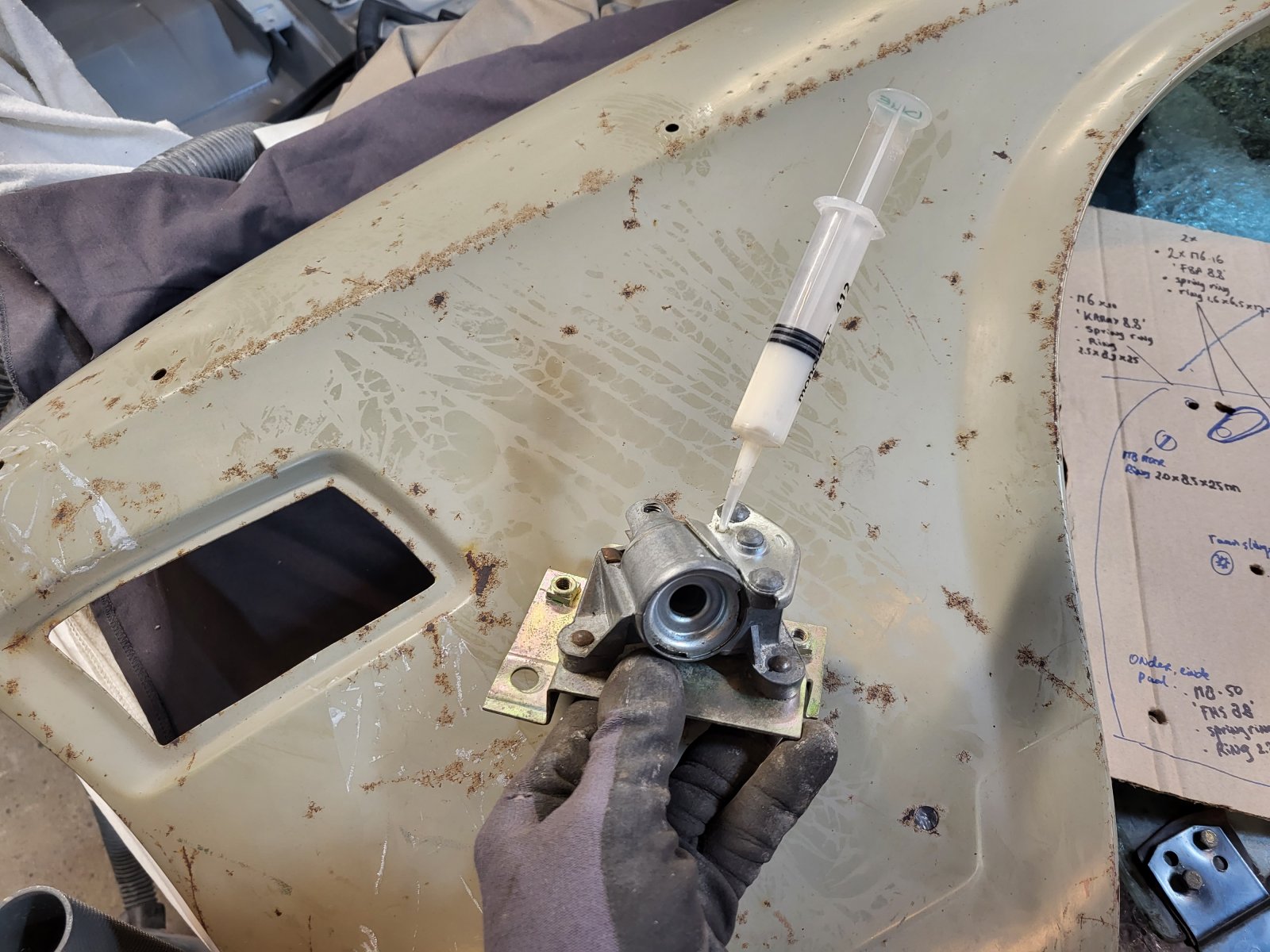

and lubed with Molykote

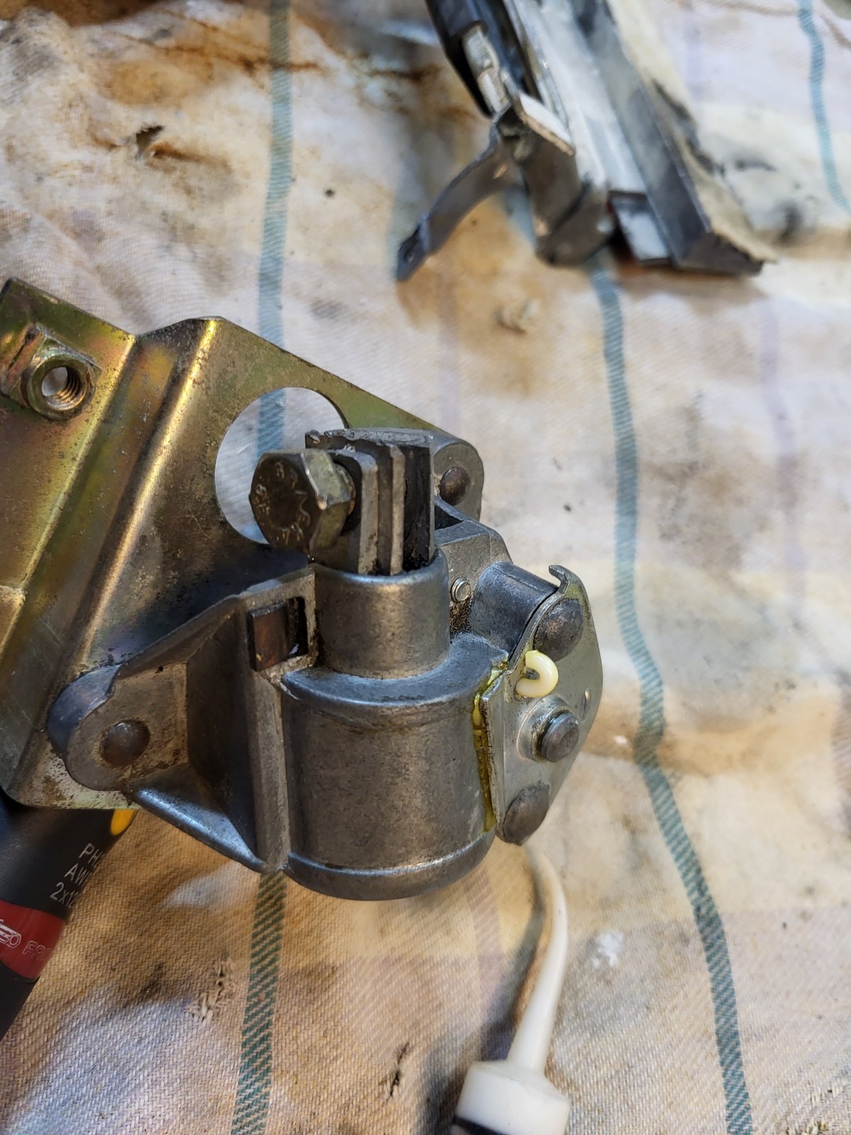

same done with the vent window mechanism;
and funny enough, when you turn it back and forth, it starts to run more smooth with every turn, as the lube starts spreading and forcing itself through small openings., even pushing old the older yellow grease in front of the new grease.

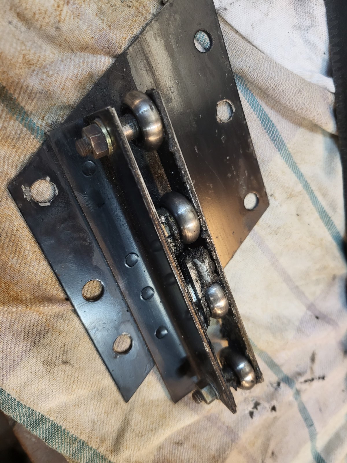

Cleaned by hand and ultrasonic bath

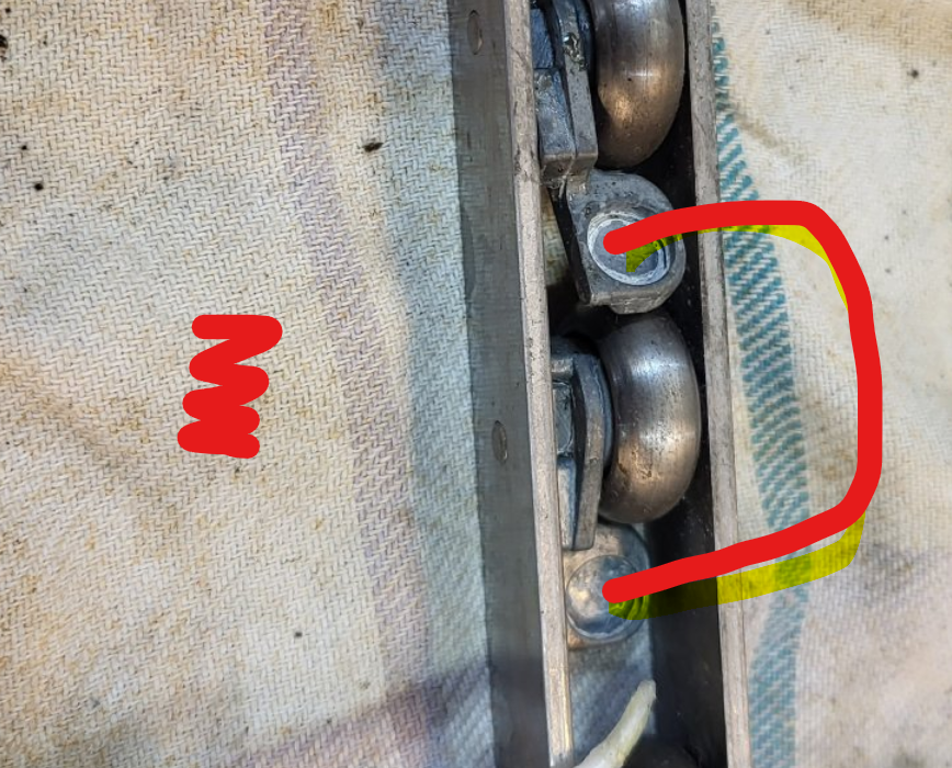

where is the spring ?

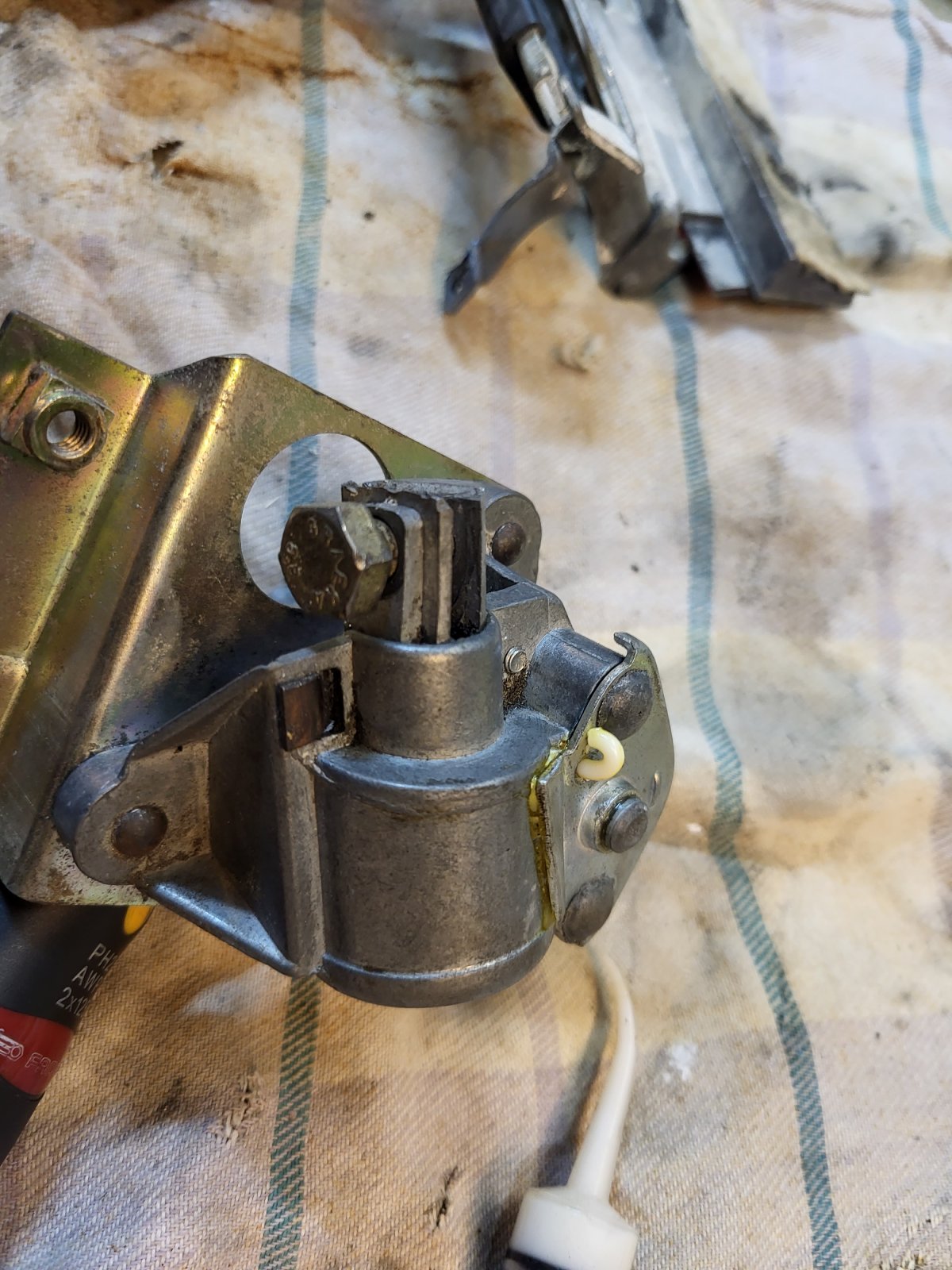

The window winder pushes in the middle under the glass, it does have a litte horizontal slider, but there isn't usually any solidified grease there.
If you have electric front windows, then the innards of that gearbox could be sticky inside as well.

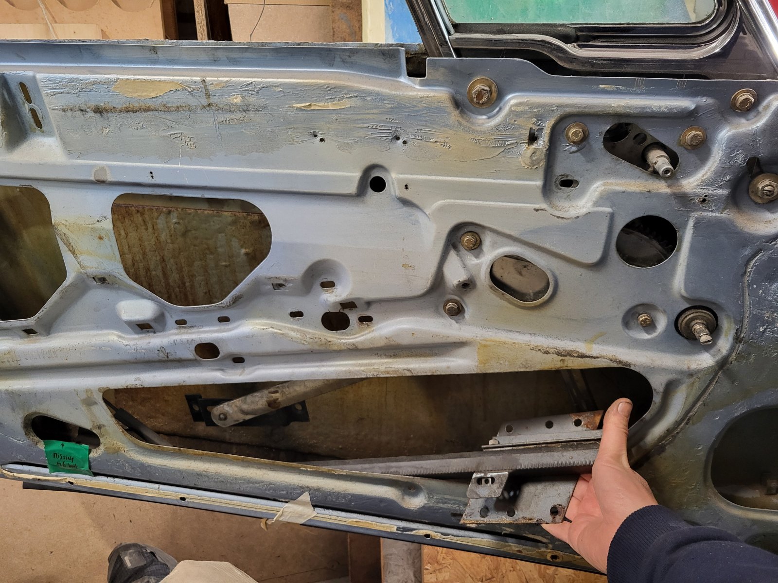

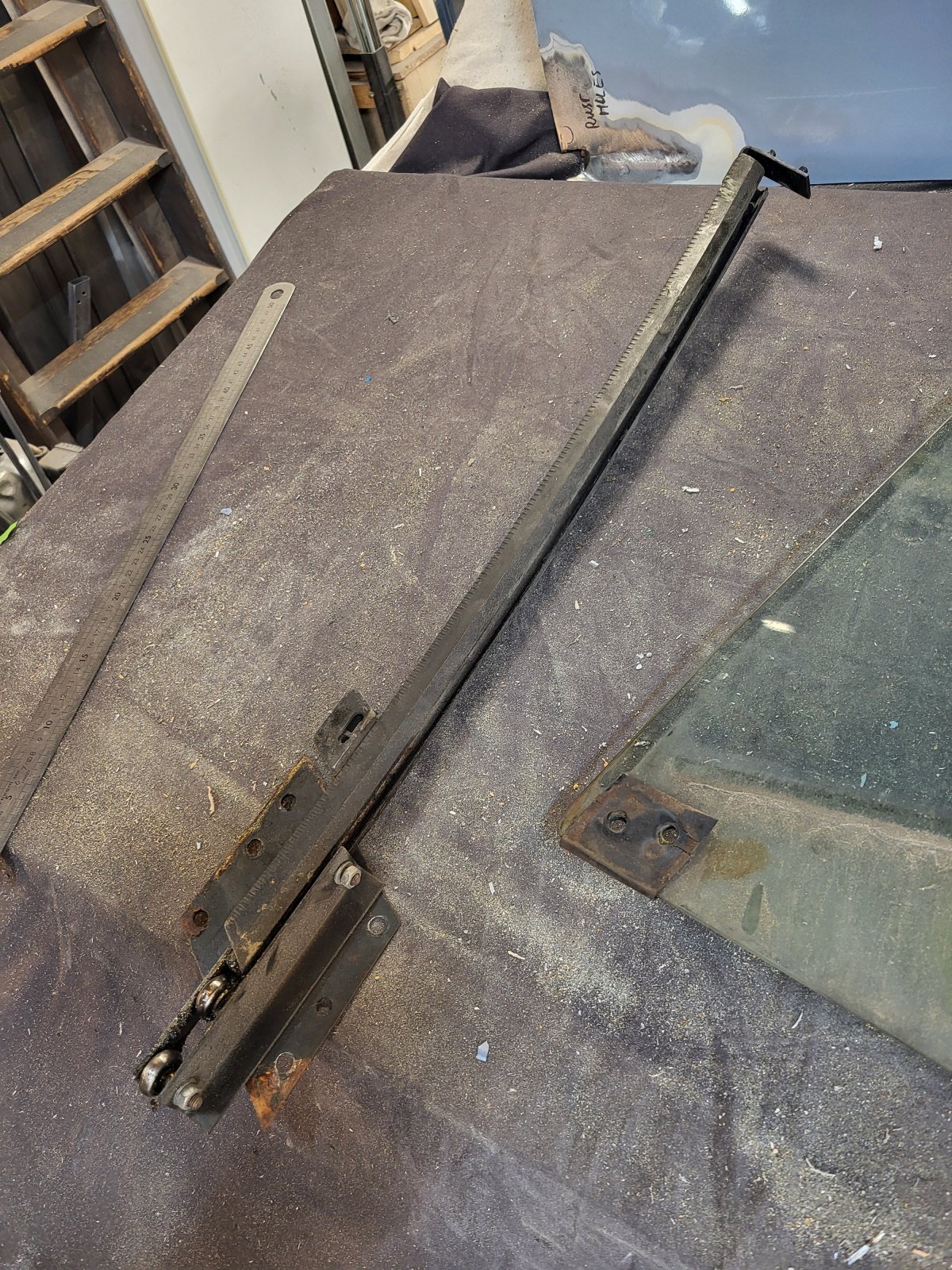

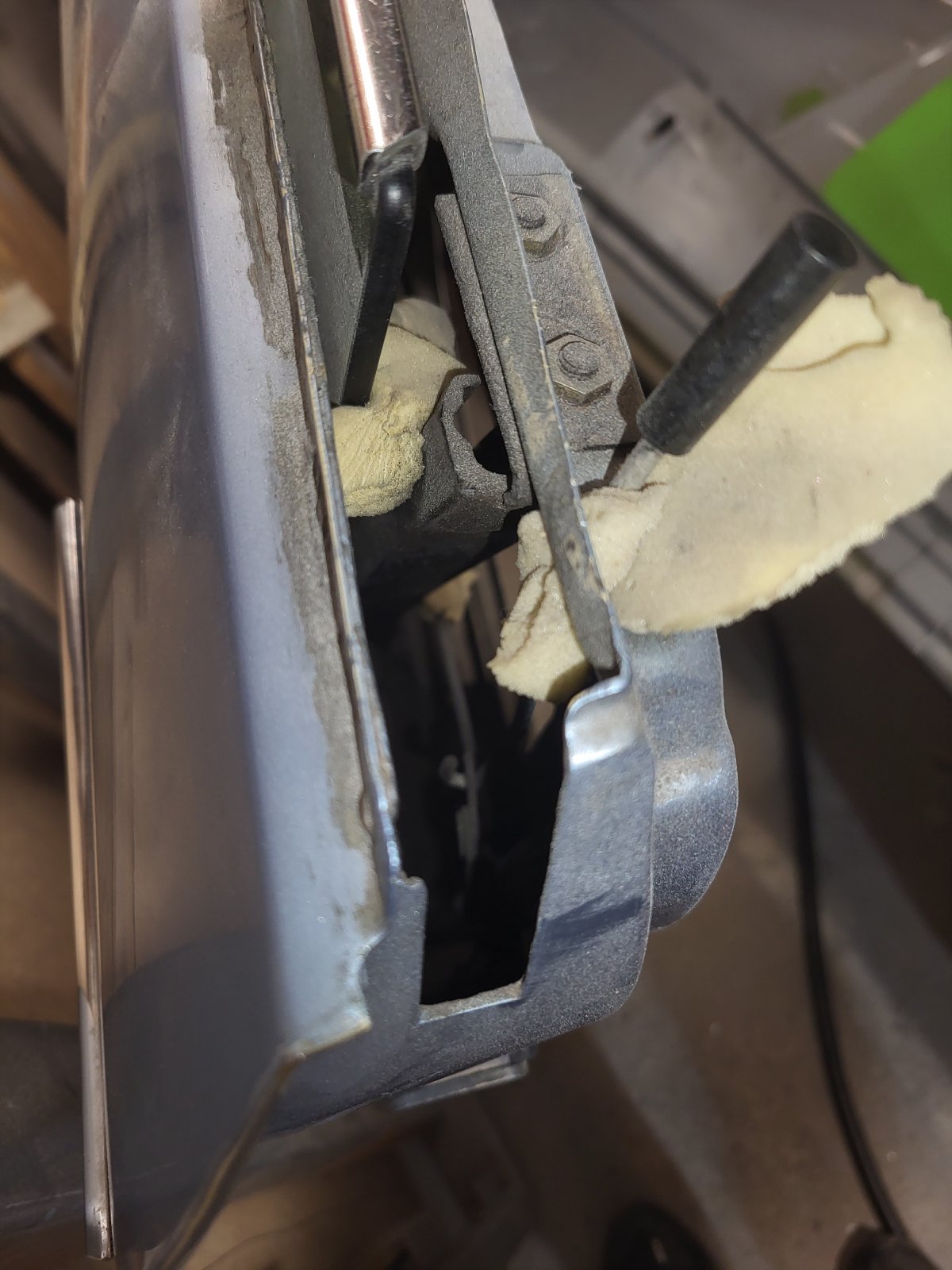

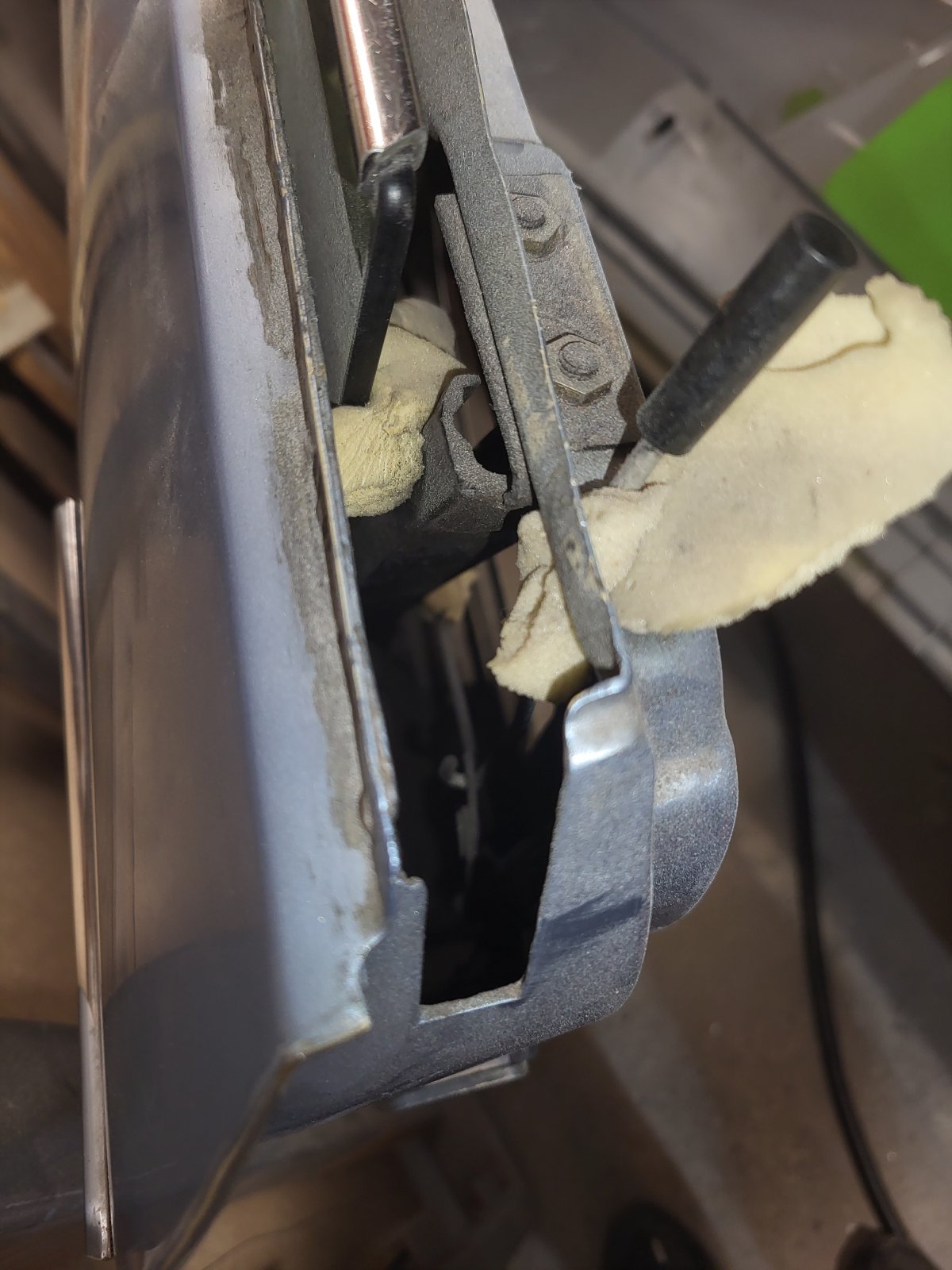

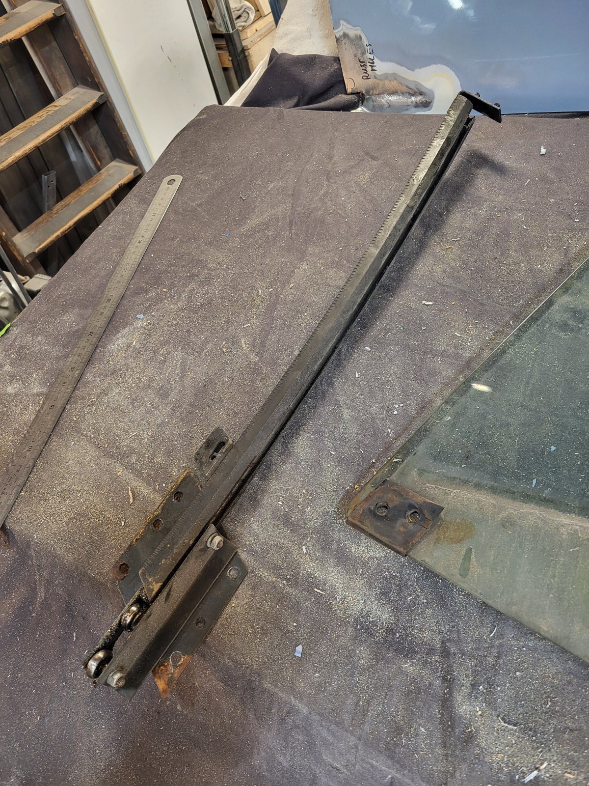

Just checked; you can't get just the sliding block out, as it indeed needs to exit at the top of the gutter, which is blocked when installed in the door. See pics. Edit- see next post: it can't go up; it must go down to exit the rail. And that doesn't fit when still in the door.
Cleaning the inside of the track will also be a chore, as the opening of the gutter is not facing you, but facing the front of the car.

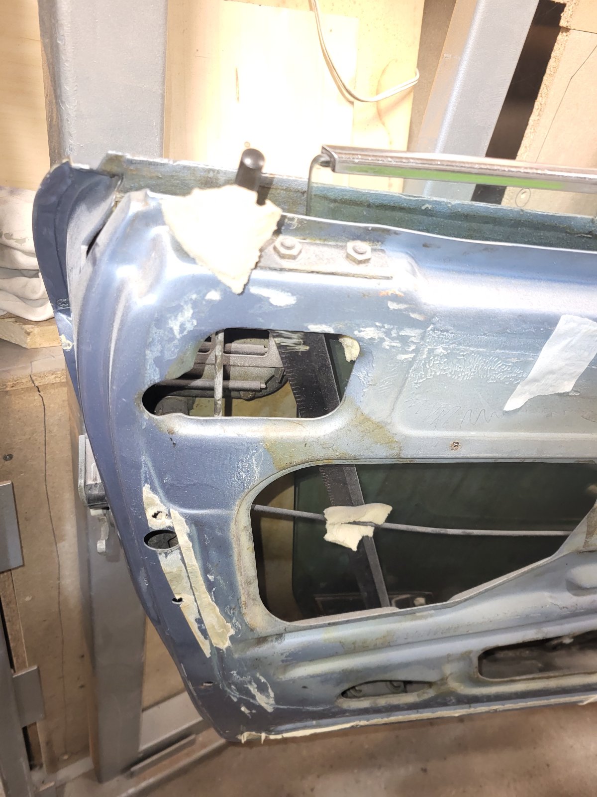

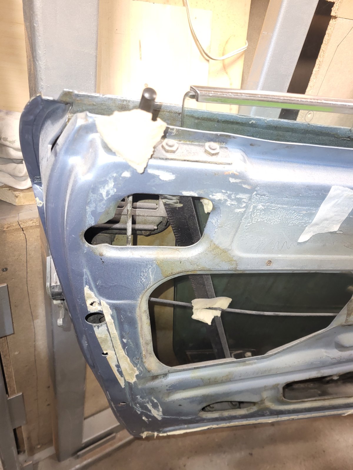

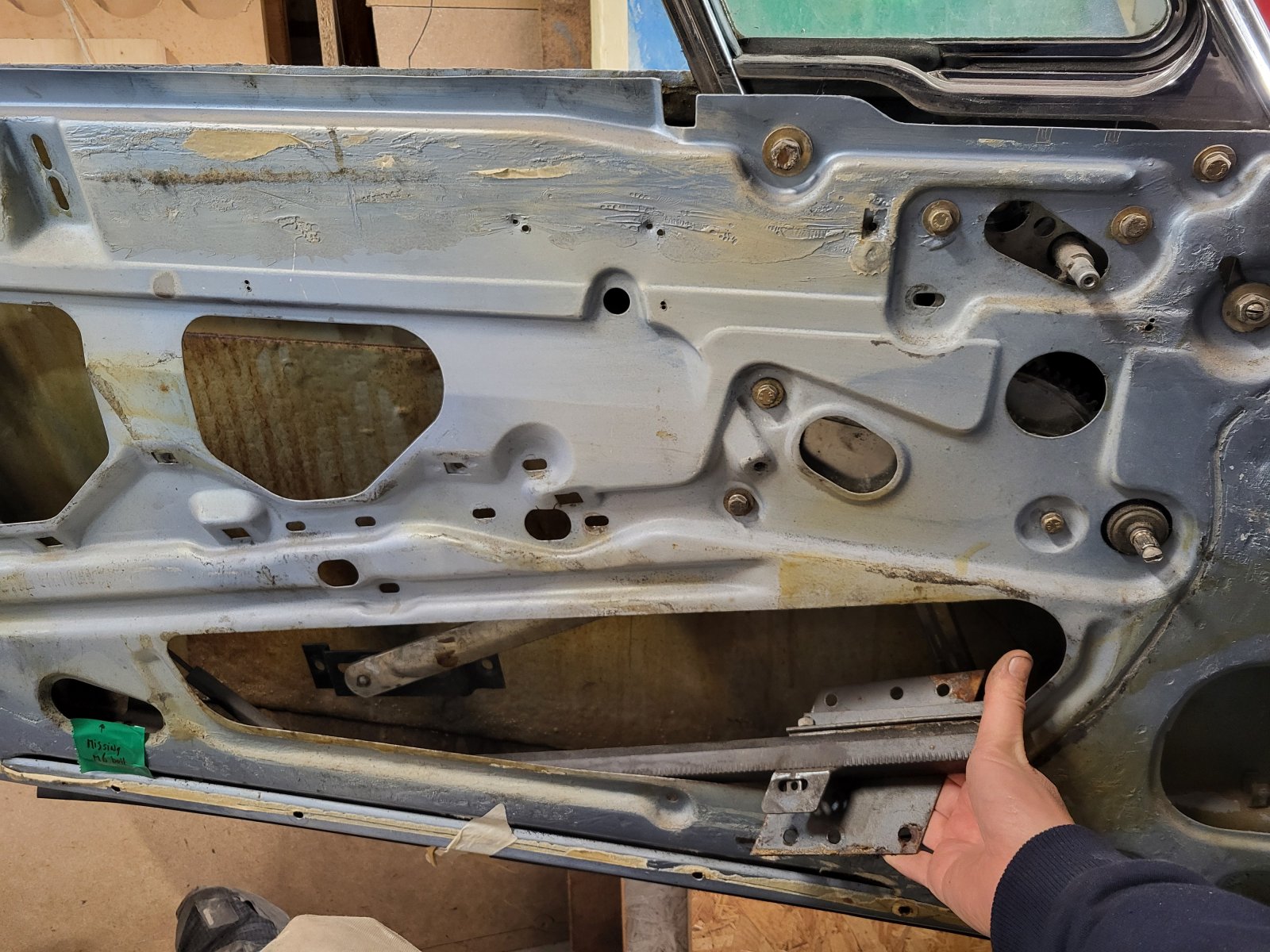

Just disassembled my door and I have to correct my message above: the black rail only has an opening at the bottom.
The top is blocked by the welded on tab with the 2 m6 studs. So the track with bearing block needs to come out the bottom, meaning you have to take out the rail.
I think this is doable however with the rest of the door mechanisms still in place; locks, glass and window winder.
During my dismantling yesterday I had the glass out already, but as the glass is located behind the rail, the rail likely has enough room to just slide out the bottom of the door when the glass is in the up position.
The glass will not fall down, as long as you keep the center arm connected to the glass (the 2 13mm nuts )
