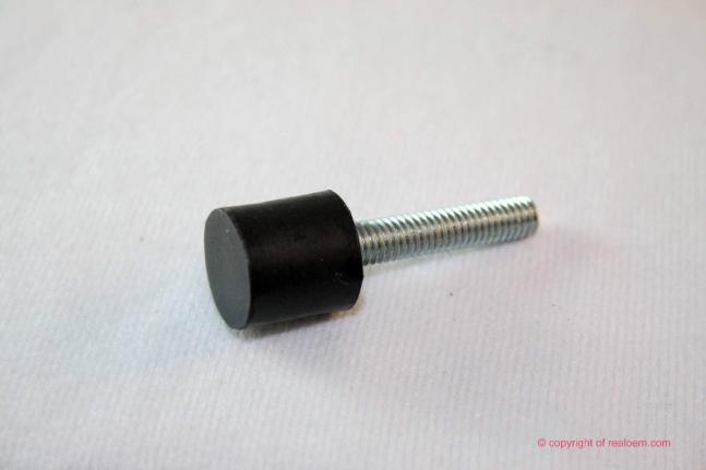

If you have a 73 it may have the later style motors similar to the e28 rear door motors that work well. Does it have two circuit breakers under the dash? As Arde says, a good cleaning can do wonders.
