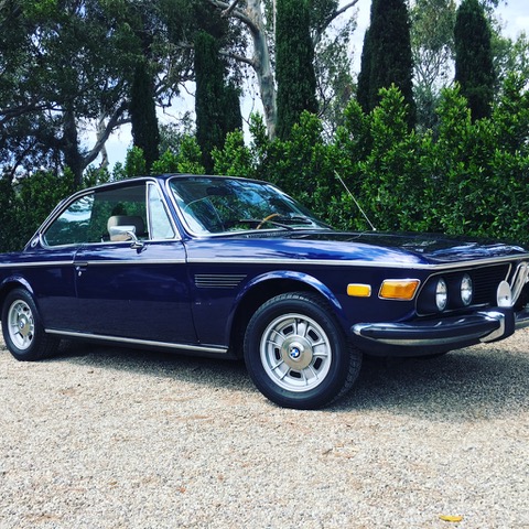

New at working on cars, but game to tackle my e9 window issue. Neither consistently go up and down. Right now they're stuck down. And when they do work which is rare, they're really really slow (which I can live with). I want to solve this but could use some advice, direction on where to start, and what to double-check. So far I've replaced the battery and checked fuses. Still no movement on windows. Hoping I get an as good direction on my windows and I did on the headlight switch issue from you guys (my headlight switch now works thanks to this forum)...
