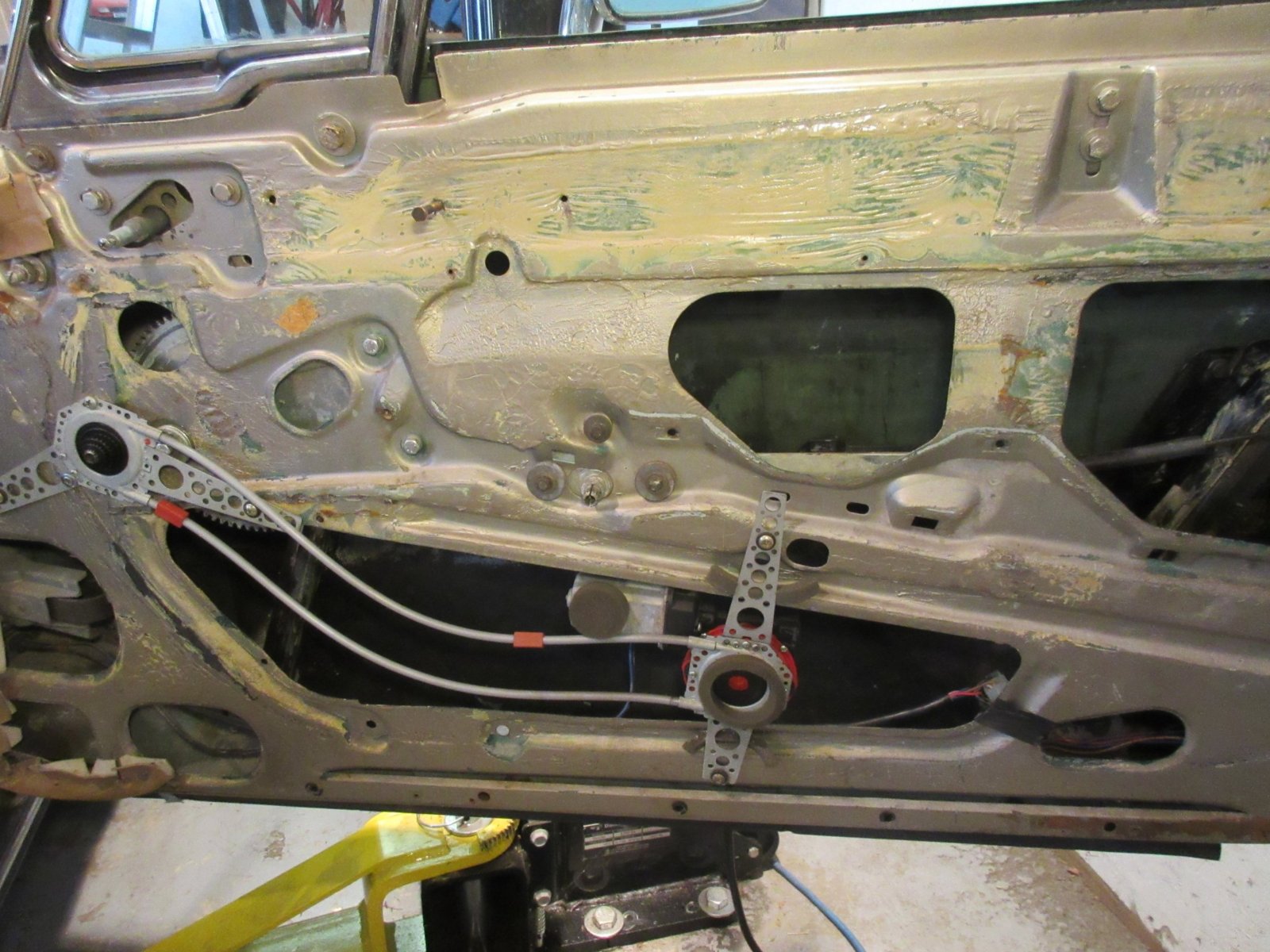

For those of us with cars not originally equipped with front power windows, has anyone here tried the aftermarket Spal electric window kit? https://www.amazon.com/Spal-33000030-Deluxe-Power-Window/dp/B0031Y3VDU
Looks like this installed in a 2002 door
I'm not sure there is clearance at the bottom of the door, under the window...

Ed, There is plenty of room in a coupe down there.
Thanks a bunch, Chris. They are inexpensive enough to give it a try. Otherwise, i have to source the proper e9 hardware and motors. If I don't like them, I can just as easily install them into my 2002.
...add that to my scope-creep :)
Ed
I just spent way too much time trying to realign my window last night trying to get it to seal properly and lift with as little resistance as possible. I was only partially successful... Anyways while the trim was off I took this pic. It is the Spal window lift kit. I did not install it (the car came with it when I bought it), but it looks fairly very easy to do.

Ed,
Generally yes, I would recommend it. The windows are still relatively slow to raise and lower compared to a modern car. My drivers side works wonderfully well and my best guess is that it was installed about 20 years ago (don't know for sure though). Passenger side is working but not as well, it's either a weak motor, extra resistance in the lift mechanism or the fact I'm testing it in my garage at a lower than normal voltage in the cold. I understand that there is a standard version and a heavy duty version from Spal, go for the heavy duty version. Not sure which one I have.
Fabio
Excellent information, Fabio. I'm sure that with freshly cleaned and lubricated window tracks and the heavy duty kit, they'll work well. I'll get to shopping!
