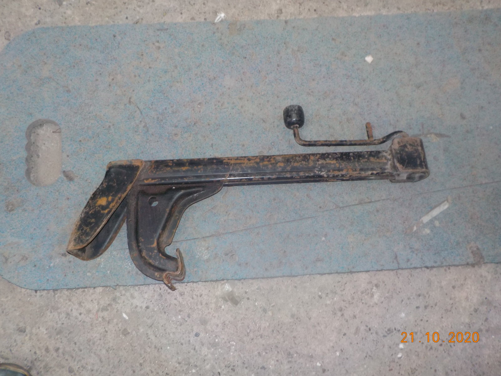

Also I have no Jack – does anyone have one for sale or a picture of what I need so I can go and look on the web?

I've got a jack for you, £ 100, could even deliver for you as we should be working in Preston in the next couple of weeks.
John.
