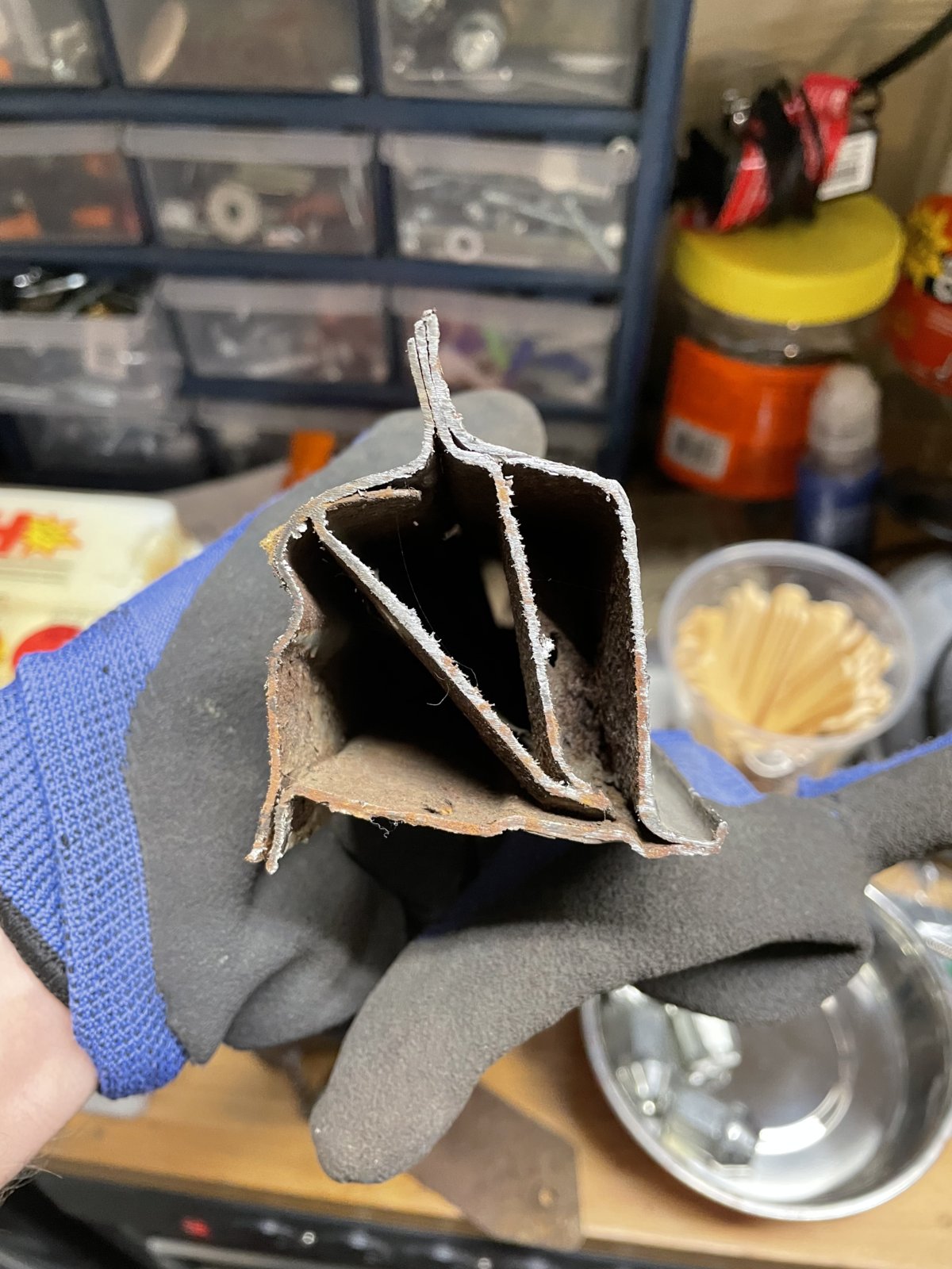

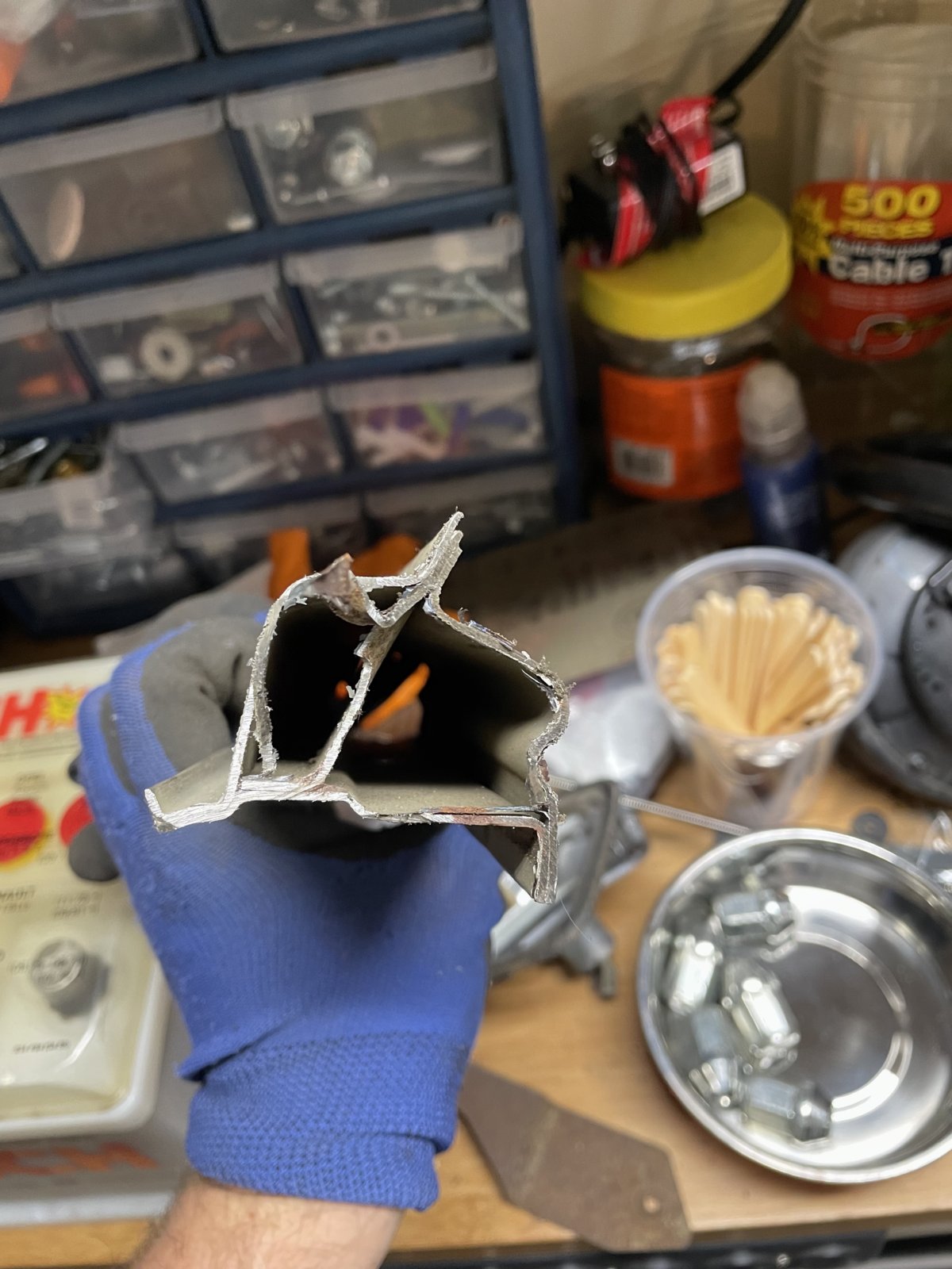

Windshield frame cross section.
Markos
13,506
7,718
Seattle, WA

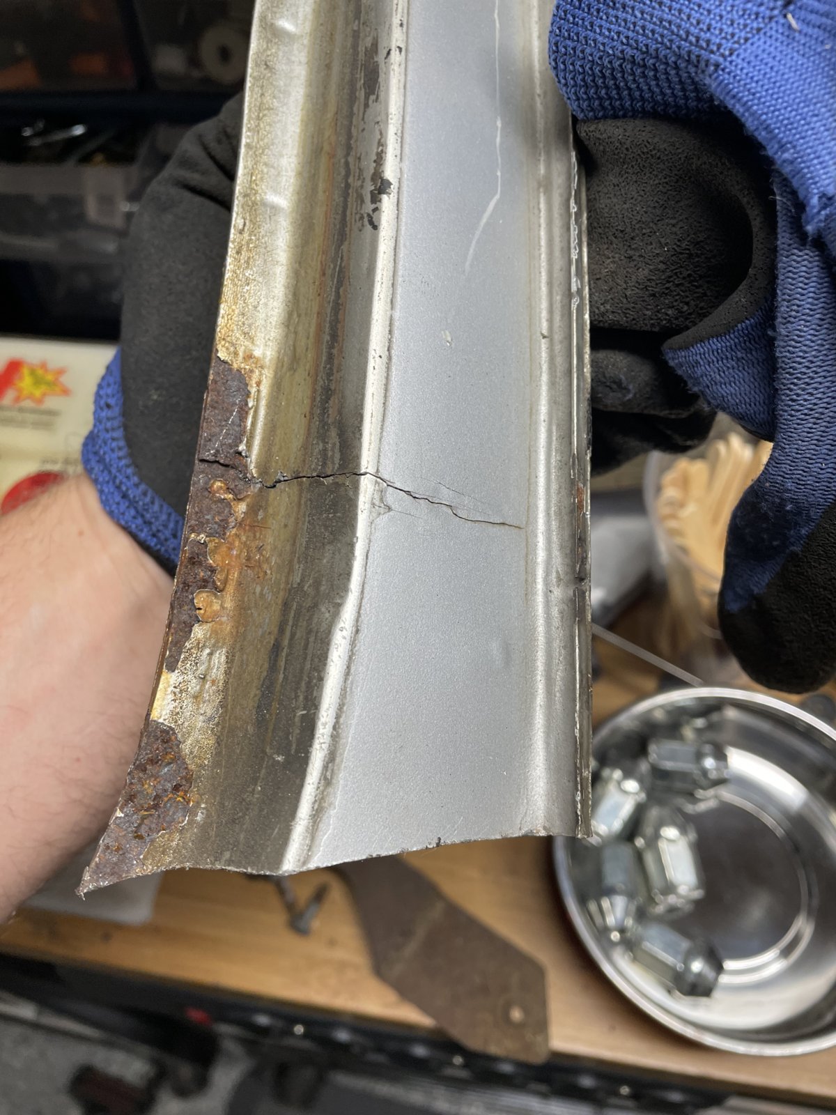

This is where the front fender meets the a pillar. Crack in the paint is the end of the fender. Note the tiny gap in the gutter edge:
Inside. Right side is the actual fender. Everything else is A-Pillar:
Further up the A pillar, looking down towards the fende:
Is that only paint/bondo crack or also metal is breaking?
Definitely paint and filler. The original fenders are seam welded and leaded right there. I never removed the front fenders since they were shot. It’s possible that they weren’t seam welded there after a repair. Likely, it is just due to the fenders flexing. The whole front of the car had no integrity.
