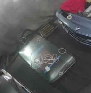

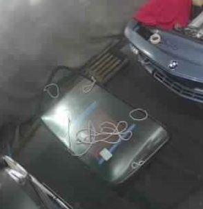

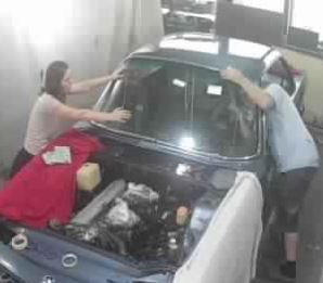

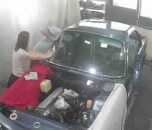

Don that is a mistake. When installing a windshield in a classic, the gasket should be installed with the trim on the glass first and then "roped" in Essentially once the gasket is on the glass, a rope is inserted in the gasket channel starting at 1/2 way on the bottom and then contuing around. The glass mounted in the gasket is laid against the windshield frame, and the the rope is pulled out evenly on both sides opening the channel and allowing the gasket and glass to slide into place. I had someone help me and show me how to do it and it is not difficult once you see it done The method you described will work but I think it will be very difficult to get the trim in

Use soap water and brush the seal and the frame nice wet short bevor you start.
I use every time 4 loops at all 4 straight inside in the rope.
Have a second guy (or girl) pushing the one side you pull in, hold in place with light pressure.
Than go to the other side.
With light slaps with your hand you slip the rubber in where it won't slip. Please soft, not as you treat your wife. ;-)
If the trim don't sit on some place after install, you kann push that in place with a 4 x 2 wood with a cloth between and a small rubber hammer.
