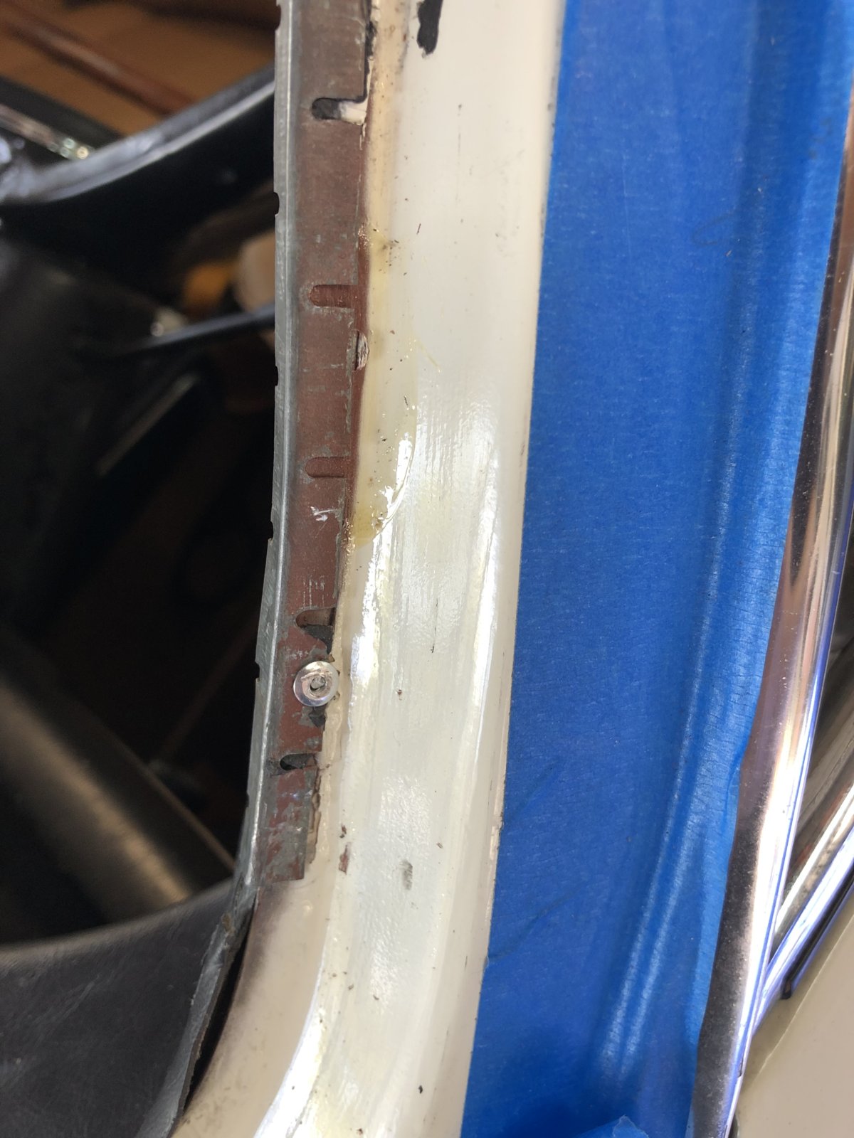

One of, if not the only, challenge is that the W&N gasket does not fit over the affix the upholstery on the header and sides (see picture).

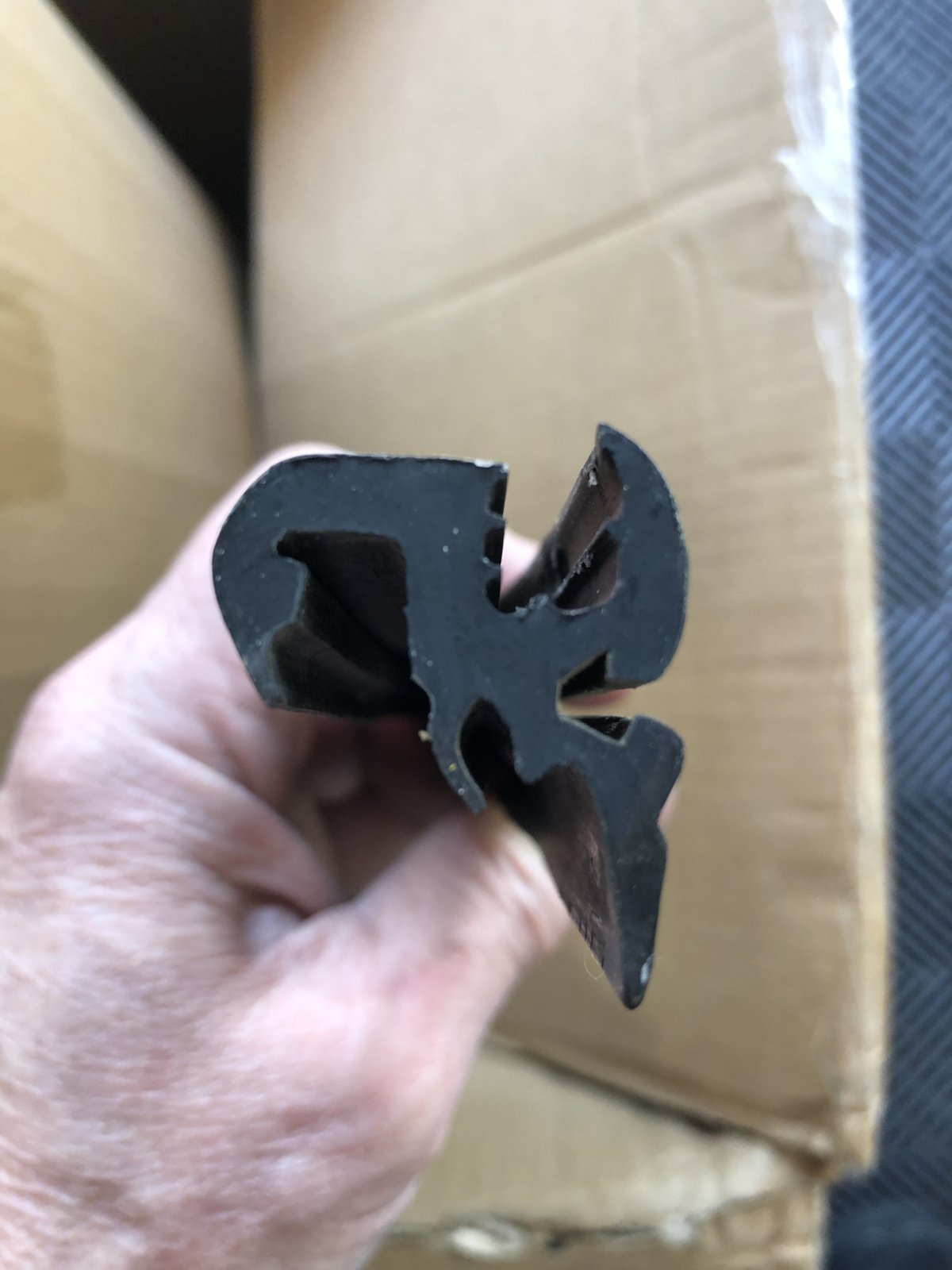

The new gaskets are substantially different profile. I am curious to know if anyone has suggestions about a different source for gaskets That might have more room than the one from W&N.
Here is the profile of the gasket that I removed. Unfortunately it was too badly deteriorated to use again.

I would also doubt that the rivet in your picture will be a good thing. It may help to keep the metal clamp in place, but it will make it challenging for the rubber to seal tight around it. Is it original?
I would be worried that you may get a water leak just because of that rivet.
These metal strips, do they not have teeth that bite through the paint into the metal, like the clips on the tops of the door, gripping the chrome trim?
If no teeth, and if you want to keep them, then perhaps squishing them with pliers in place may help to keep them seated.
I have a special flat beak parallel pair of pliers , that leave no bite marks. Perhaps something like that could work?
(Just trying to help to get your coupe as dry as possible)

The upholstery clamp strips really don't clamp by themselves, I found them riveted as well and replaced two rivets that were missing. I tried to clamp down further on the driver's side pillar, but the clamping action is insufficient to keep them in place, particularly as we tried to rope in the gasket.
The clamps also have a lip that further impedes the gasket from reaching a position where it can capture the metal seam. We found the gasket could be worked into position, but would not hold around the upholstery clamp.
Today's task will be to drill out the rivets and use some Wurth glue to make sure the upholstery is well adhered to the pillars and roof then try again.
Neither on mine, never saw them before. No issues fitting over glued vinyl. As I am sure you have seen, these are perfect for glueing the pillar vinyl

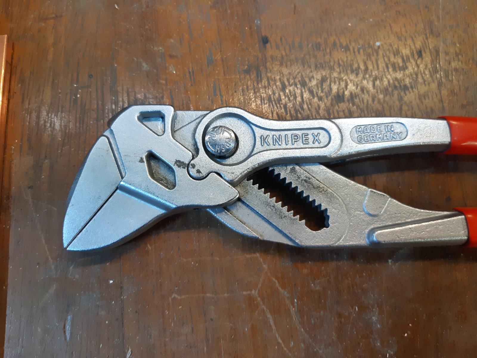

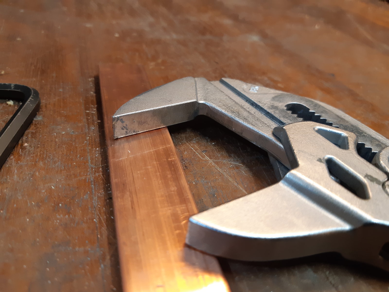

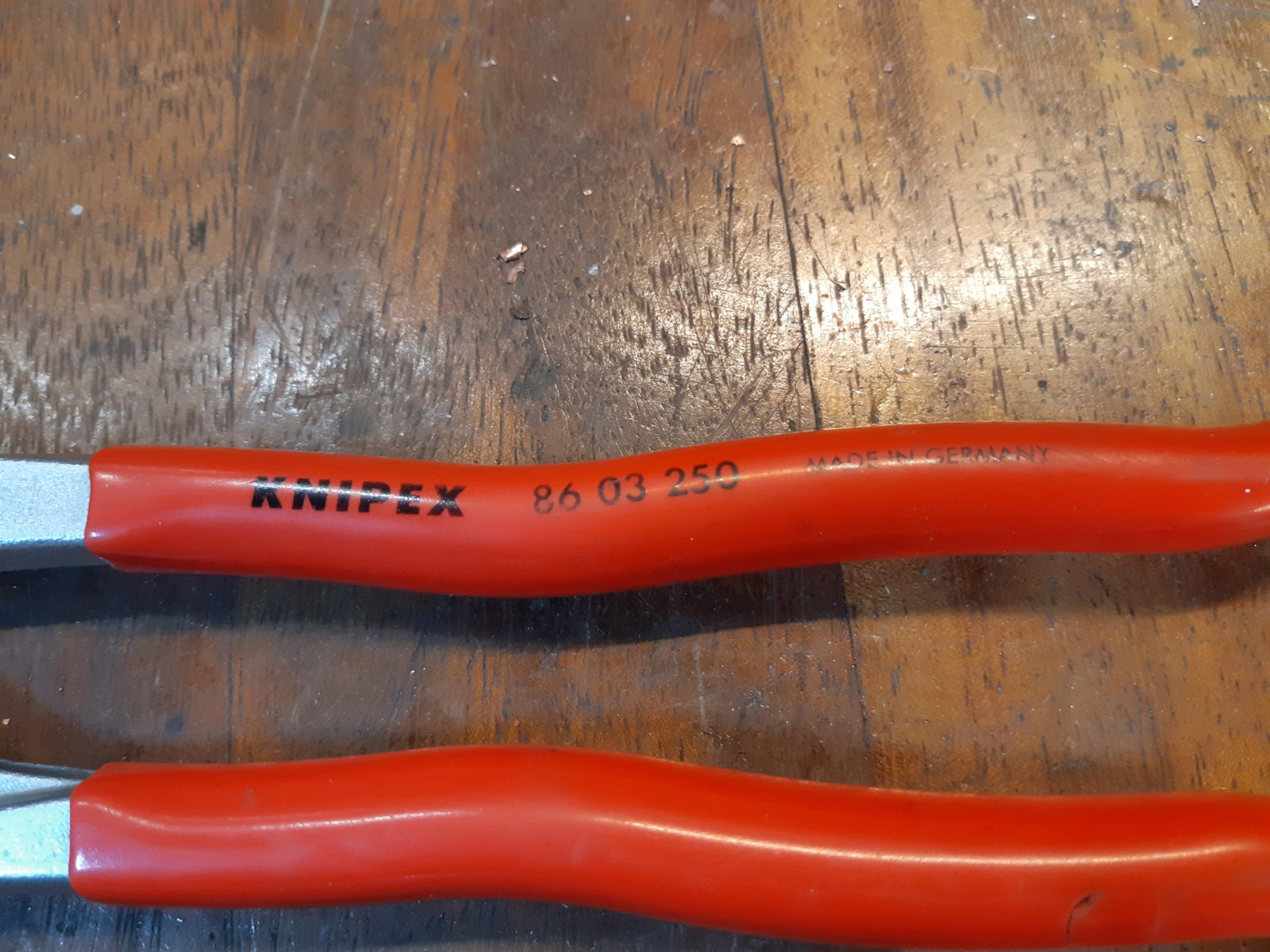

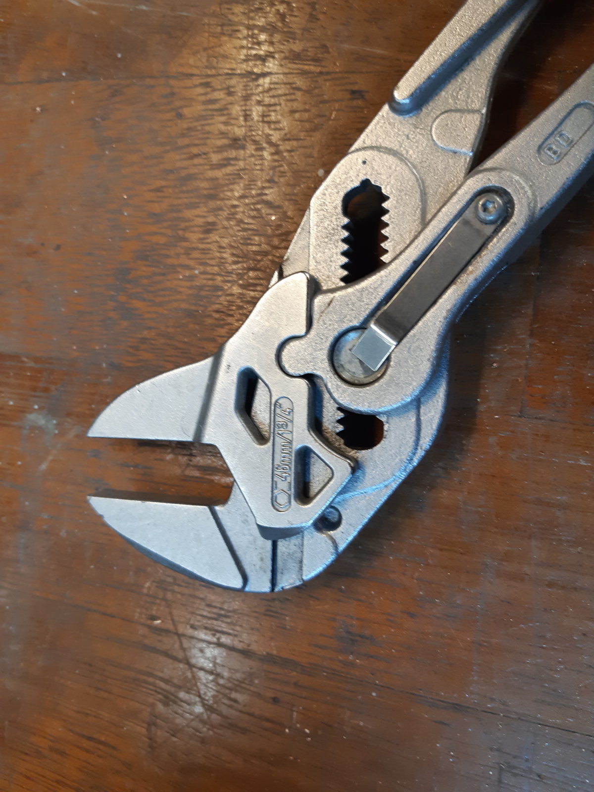

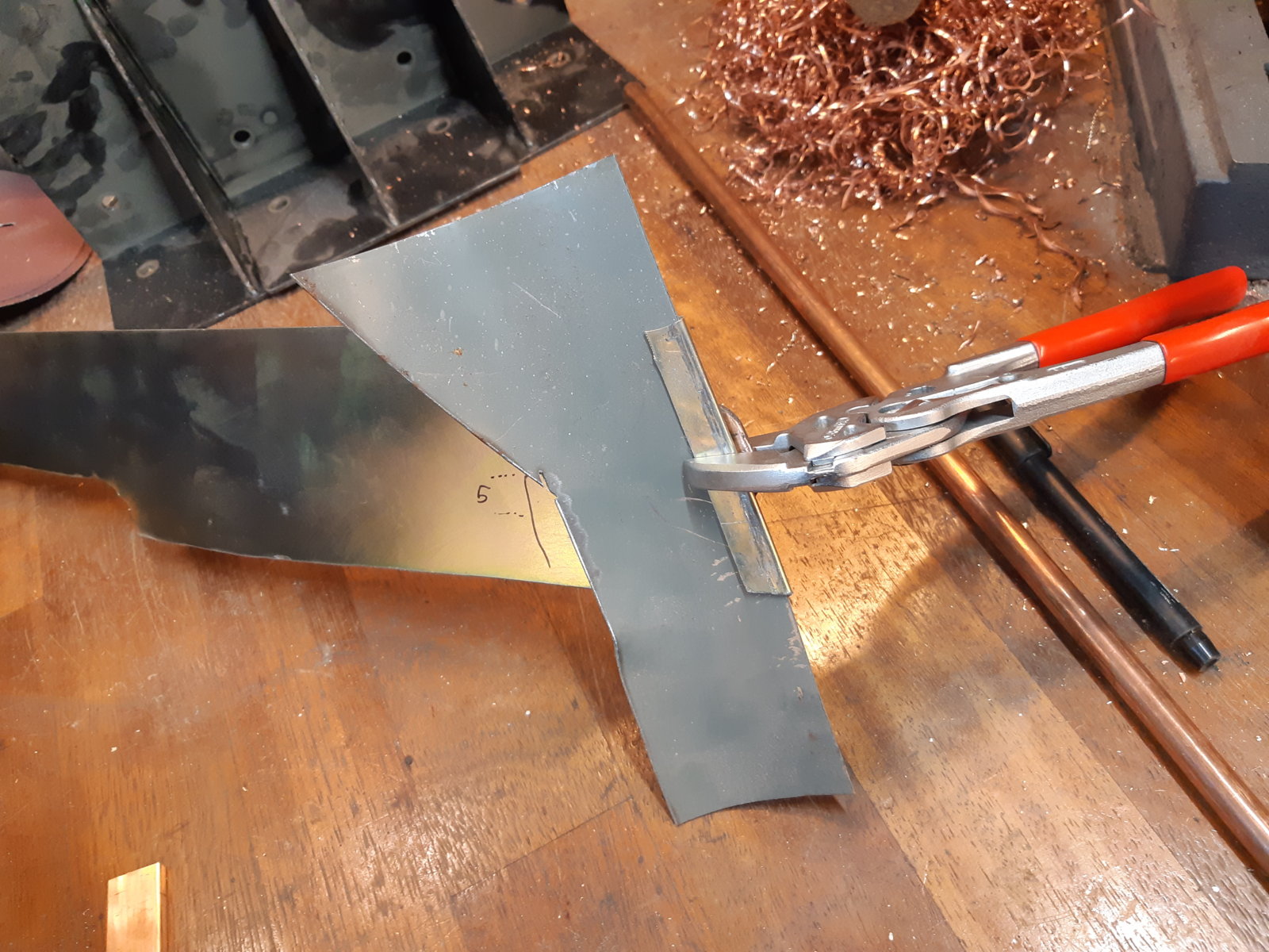

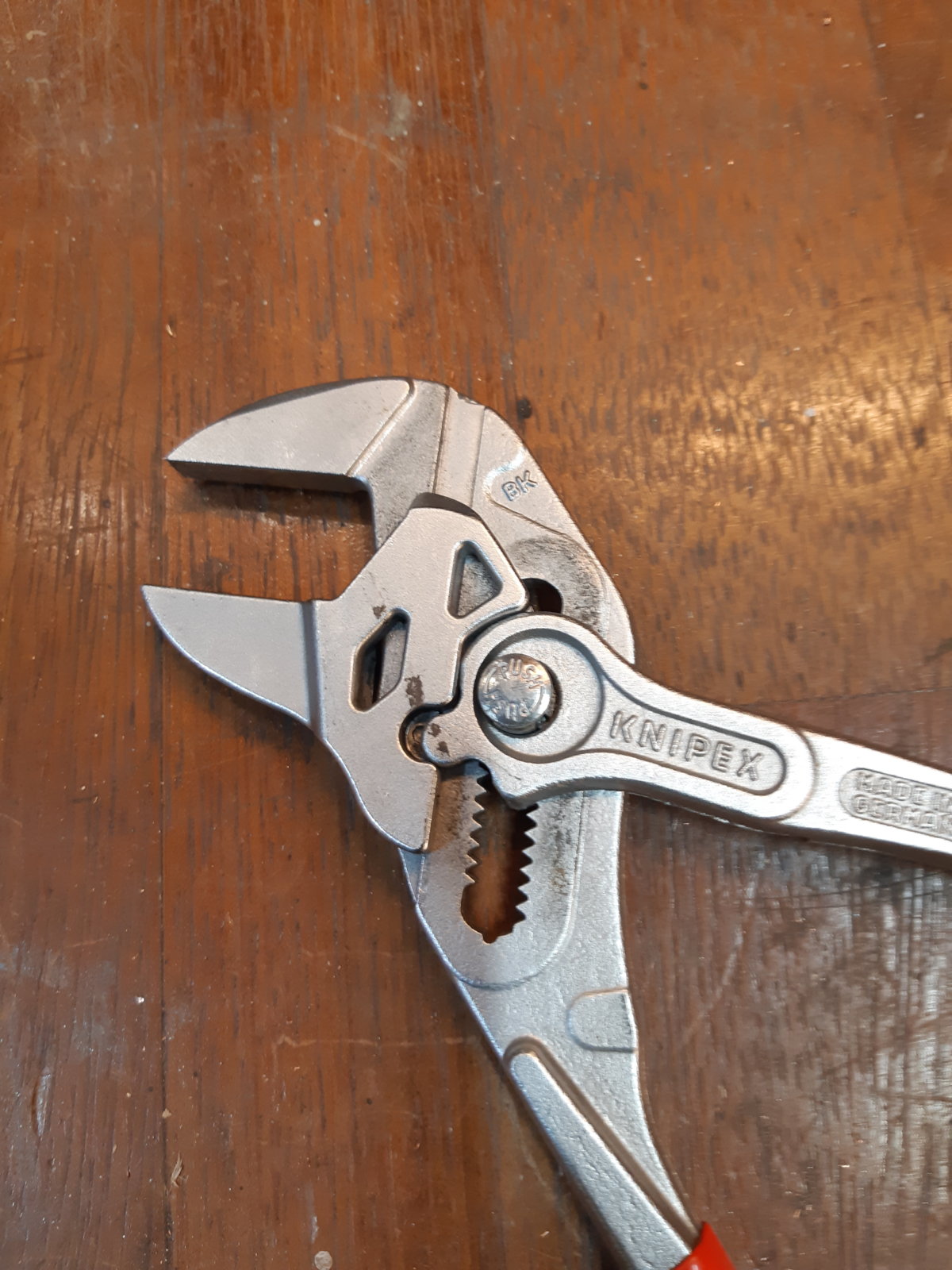

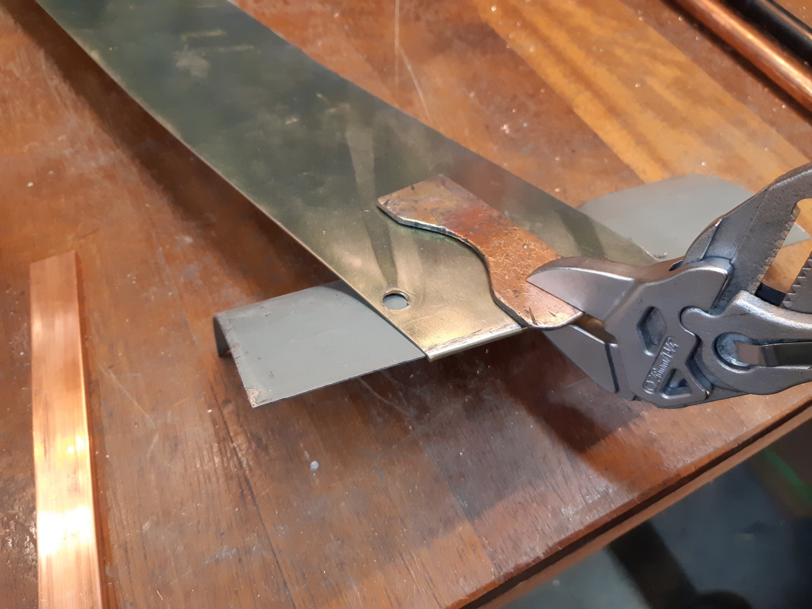

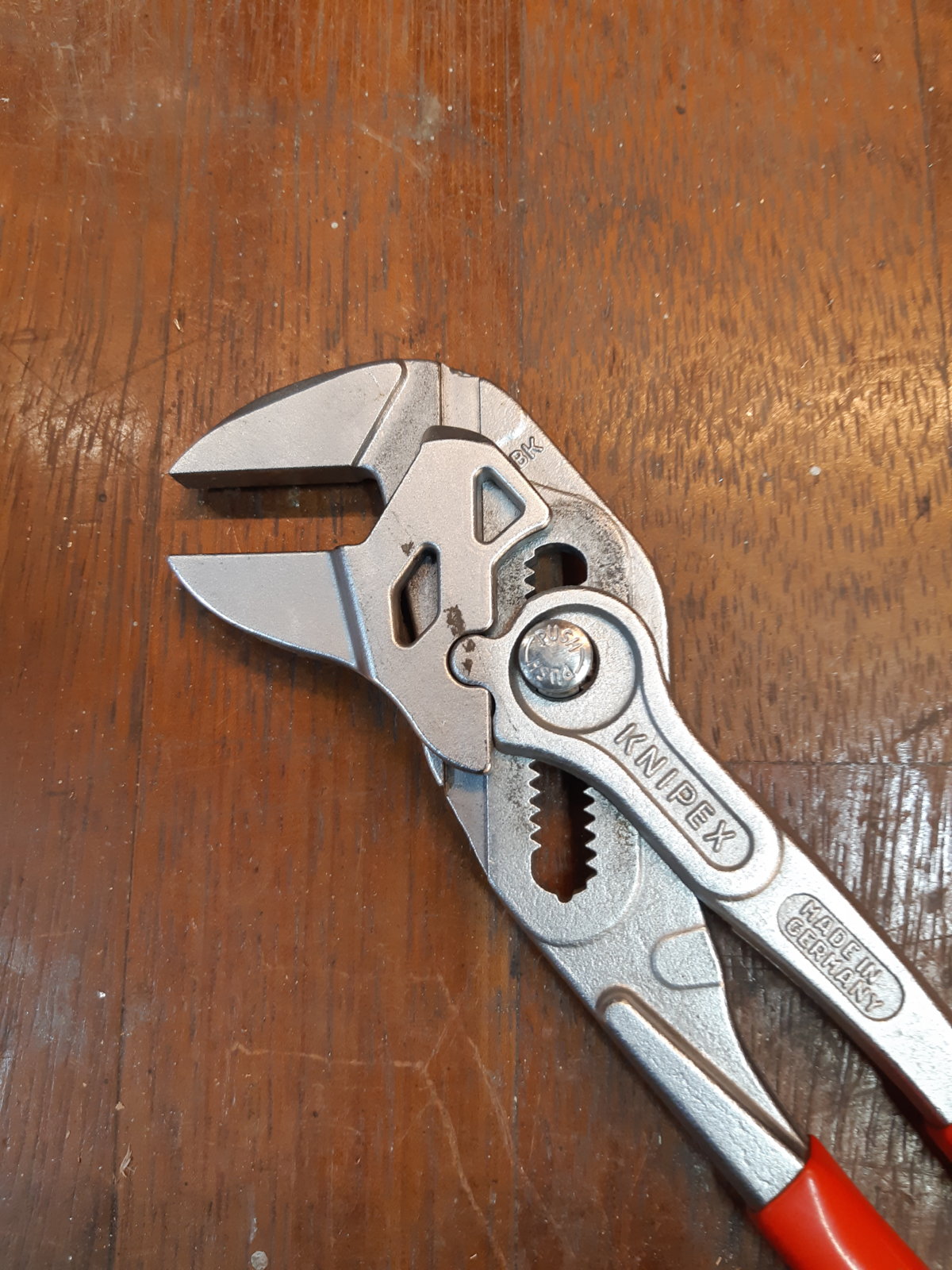

Eric, Do you have a picture of the flat beak pliers? Thanks.
Threadhijack warning...
It's a Knipex brand, type 86 03 250,
I think it is actually used for plumbing, as you can tighten those chromed fittings on shower faucets etc perfectly without 'bite' marks
