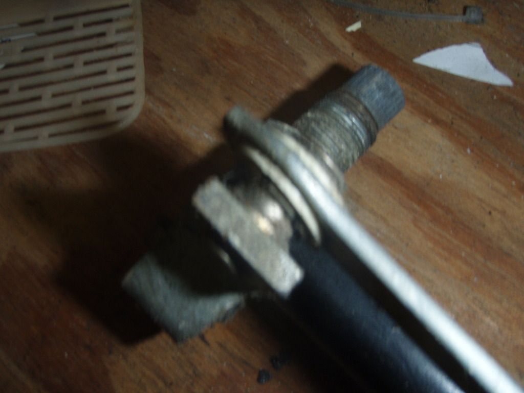

do not forget that you will need a small extractor tool for removing some of the parts
the small arm that is fixed to the motor is usually stuck in its place, so after undoing the hex nut you will feel like it is soldered to the axis, the extractor will free it away
same thing when you go through the other two pivoting axis in the blades, not easy for me to explain which part it is the one that needs to be extracted, is the cylindric head on top of the axis that engages to the wiper blades (t is not flat surfaced, it has tiny longitudinal channels on the surface, well that part needs to be extracted too
do not try to force it with screwdrivers or similar, remember if you break it is NLA !

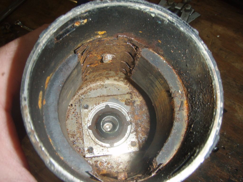

How to clean?

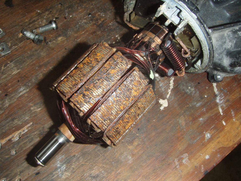

Everything looks OK except for the 40 YO grease and rust ;) . The magnets appear to be in good shape.
So how do I clean this all off? I've got a tank washer but is it OK to simply dunk the whole assembly into the solvent? I also have a blast cabinet, can I blast the inside of the motor without tearing up the bearing at the bottom?
I also figure I can take the rotor out of the upper frame and touch up the copper on the armature with fome fine sand paper.
The wipers work (they were running when they stopped :lol: ) so there are no electrical issues.

No parts washer. You can use electrical cleaner. Don't dose it though.
But clean off the rust. From the looks of it, that's what was grinding. I'd use a dremel and a fine wire wheel. A little clear laquer/ shellac to slow up the process. Easy does it.
Just dig out the old grease and repack the best you can. There is some electrical cleaners out there but for the life of me it's been 20 years ago, then you have to let it sit and air dry for some time.
Look for the cut out contacts and clean those up a bit too. Stay away from the resistors- those little curley cued wires. They get real hot and brittle under use.

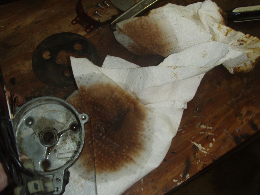

Spot on as usual, thanks! I had to use my "puller" (English for extractor) to remove the arm.

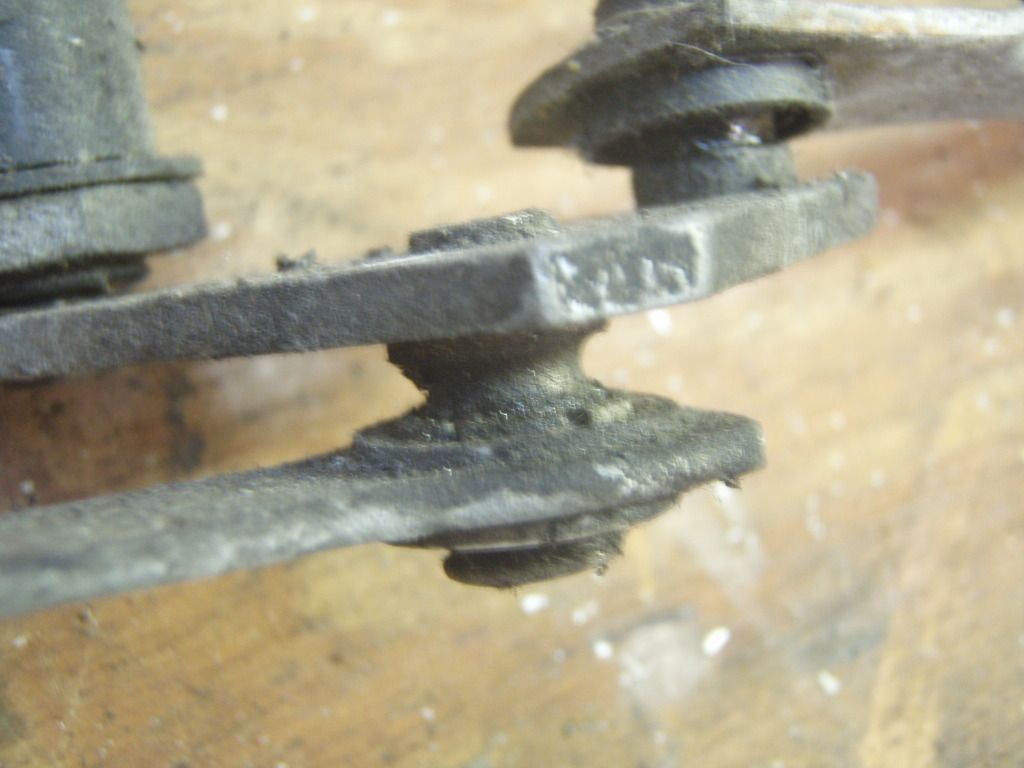

And yes, I found the pivoting axis I think, I assume they are these:
Is there a method of cleaning them?
What is the best type of grease to go back together with all this? Wheel bearing grease (heavy), or something like bicycle white grease (light)?
BTW, I washed more 40 year old $hit out of the center bore than I could believe!

hi
the pivot axisthat i meant are the ones that can be also seen in thta pic, the aluminium ones that fit into the wiper blades, if i remember well you need to dissasemble them for accesing the main axis cylinders for cleaning and regreasing the inside of those
as to the other pivot axisi that you present, no doubt it is very risky to try to dissasemble for cleaning, so i used a light oil spray to loose the dirt and a cloth to clean while moving them in every direction to access the most part of them
regrease those ? not sure if there is a real need for a grease as it is a metal-plasitc frcition, the light oil spray will do for a while, otherwise i would use a castrol red grease that is compatible with plastics and rubbers
