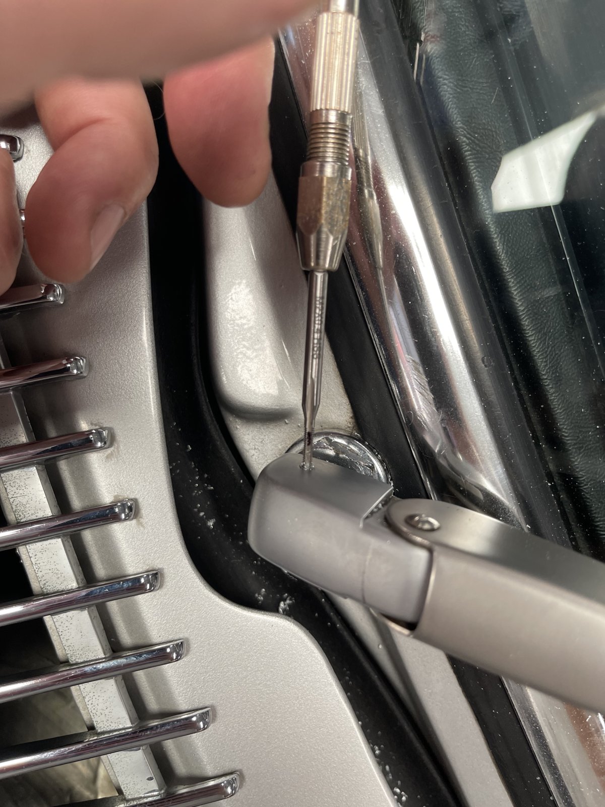

First I marked the position on the arm that I wanted to drill, it's on the underside so you won't notice the hole without really looking for it. I used a spring loaded punch to mark the drill bit location:

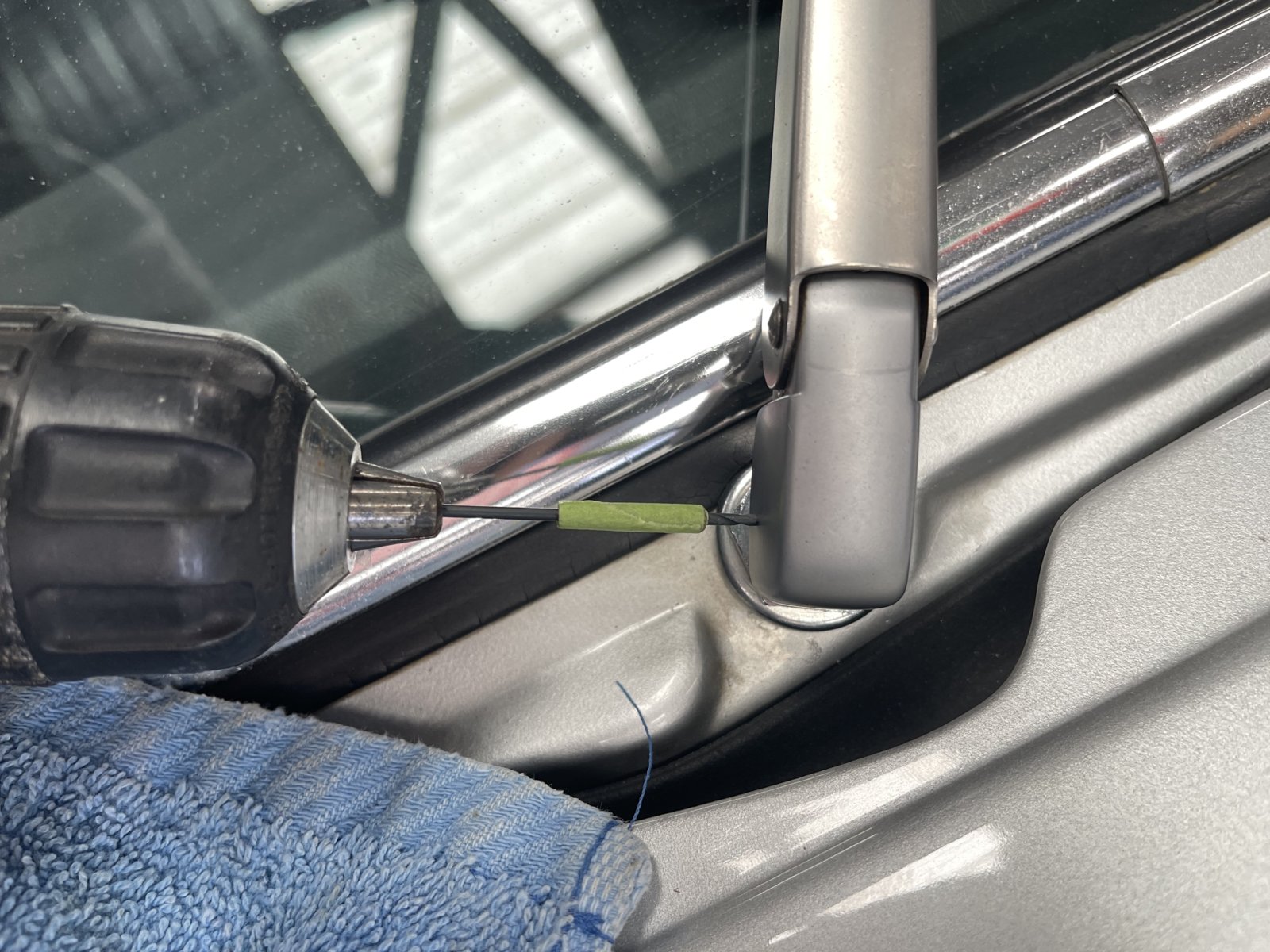

Next up is the drill, I stopped the wipers in the full sweep up position on the windshield, marked off a little over 6mm on the bit and made sure it was square going in (it goes about 3mm into the spline, not just the wiper arm). Dicey operation #1:

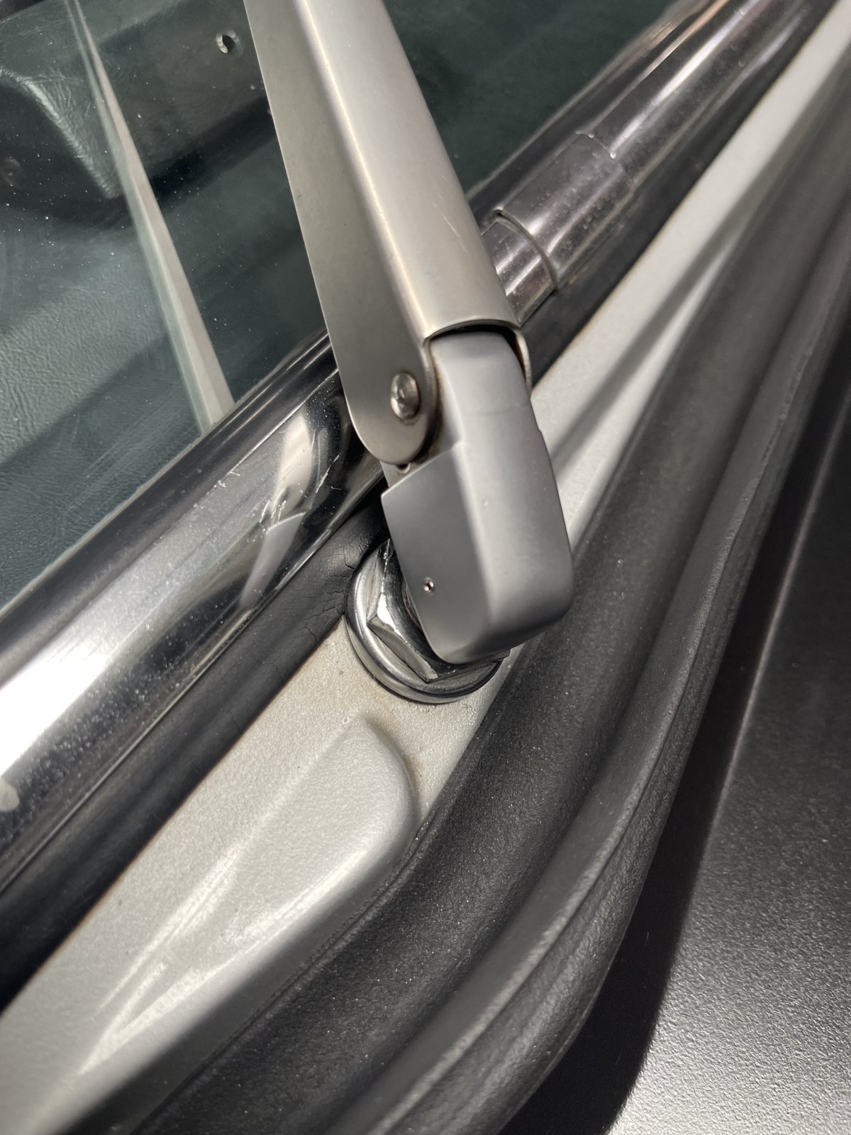

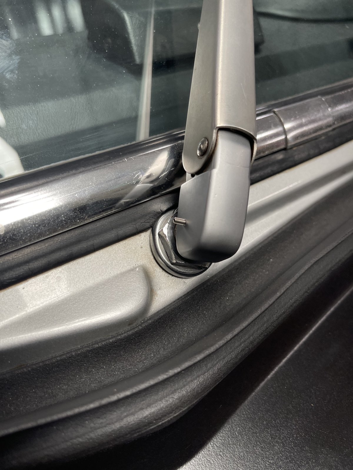

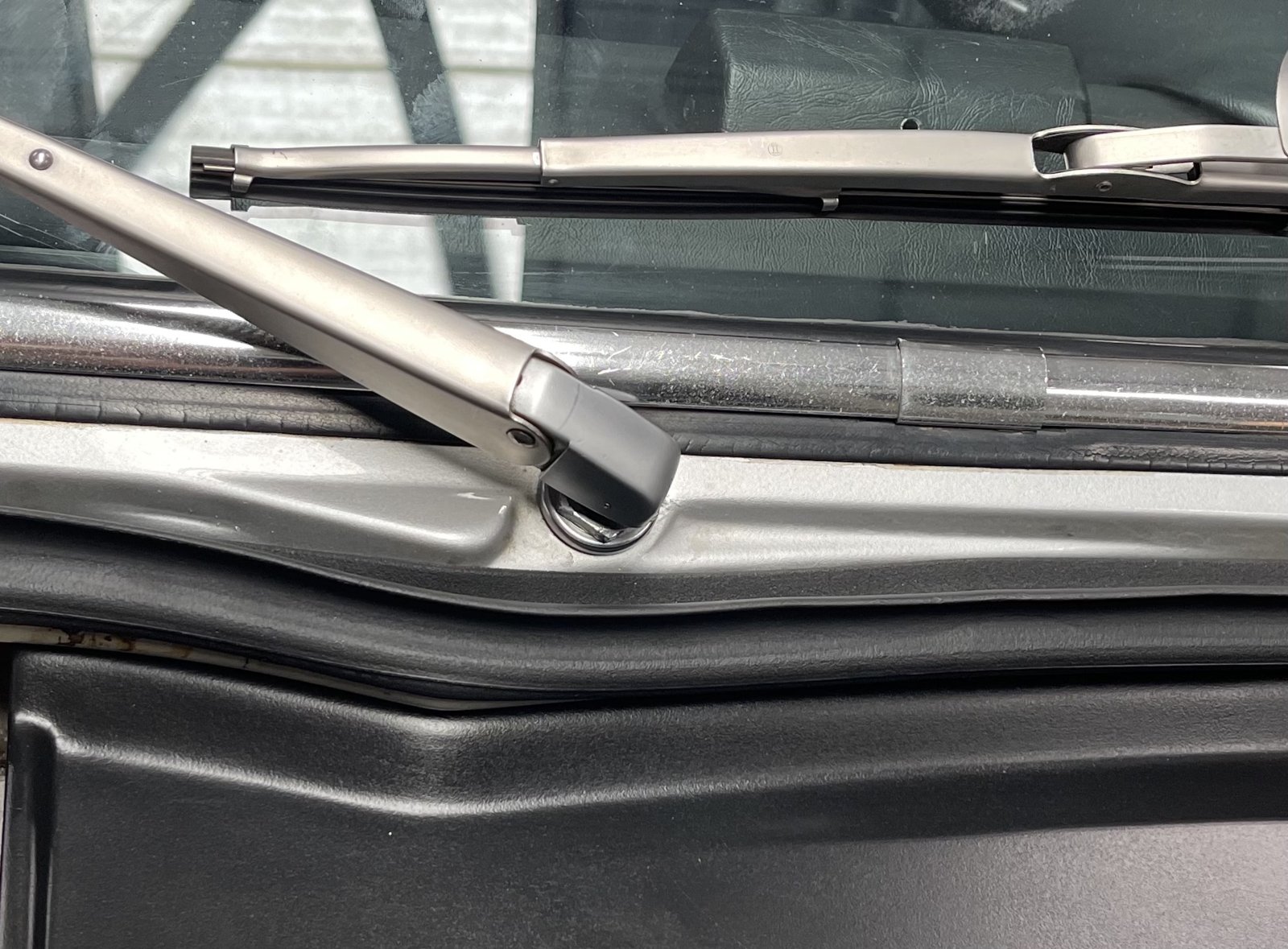

And all the way in, tightened down, they are not going to fly off, and are not noticible when viewing from the front:
Ready to roll!!!

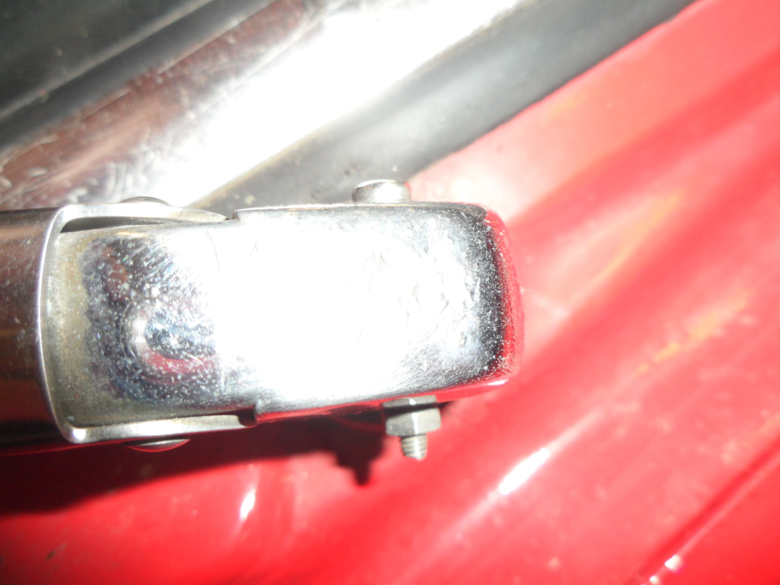

nice solution with the grub screw....we just drilled a hole and mounted a bolt/nut.

Update: I received the .9mm hex tool, snugged the bolts in just until I could feel a little resistance begin, then stopped. They are now just below the surface of the wiper arm and tight enough not to strip the pot metal or work themselves out.
