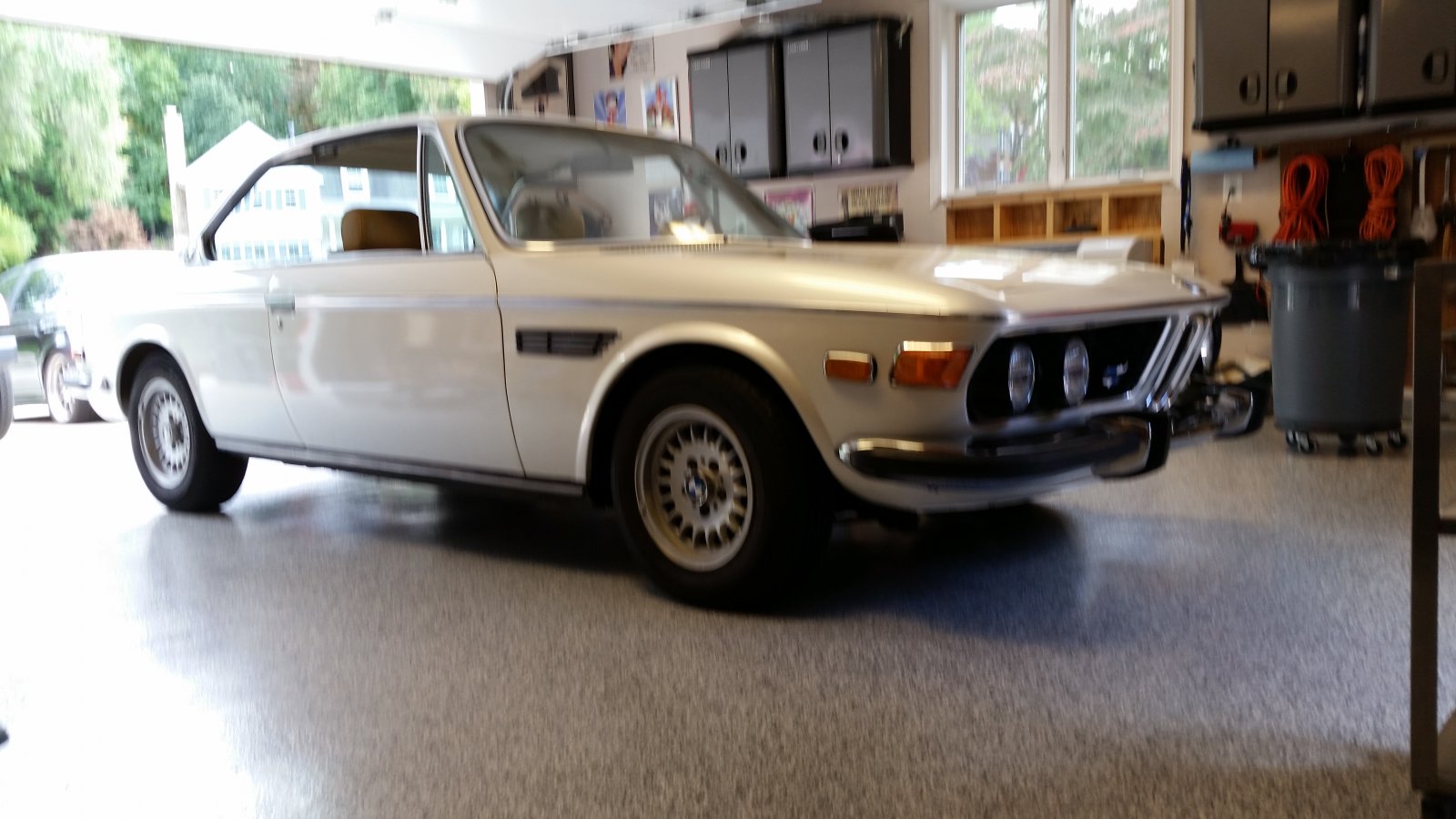

Henrik - I am in the USA, so I don't know if this will work for you, but I have a set of 14" "bottlecap" wheels that were on my car when I bought it that you can have for $25 plus shipping. (The $25 is to cover the cost of the boxes I would need to buy to ship them). I believe they are 14x6, and I know the pcd is 5x120.
Here is a blurry picture of them on my car. (Note that I've misplaced the center caps and sold the tires).
I have no idea what shipping may cost, but if you pm me with your address I will find out.
