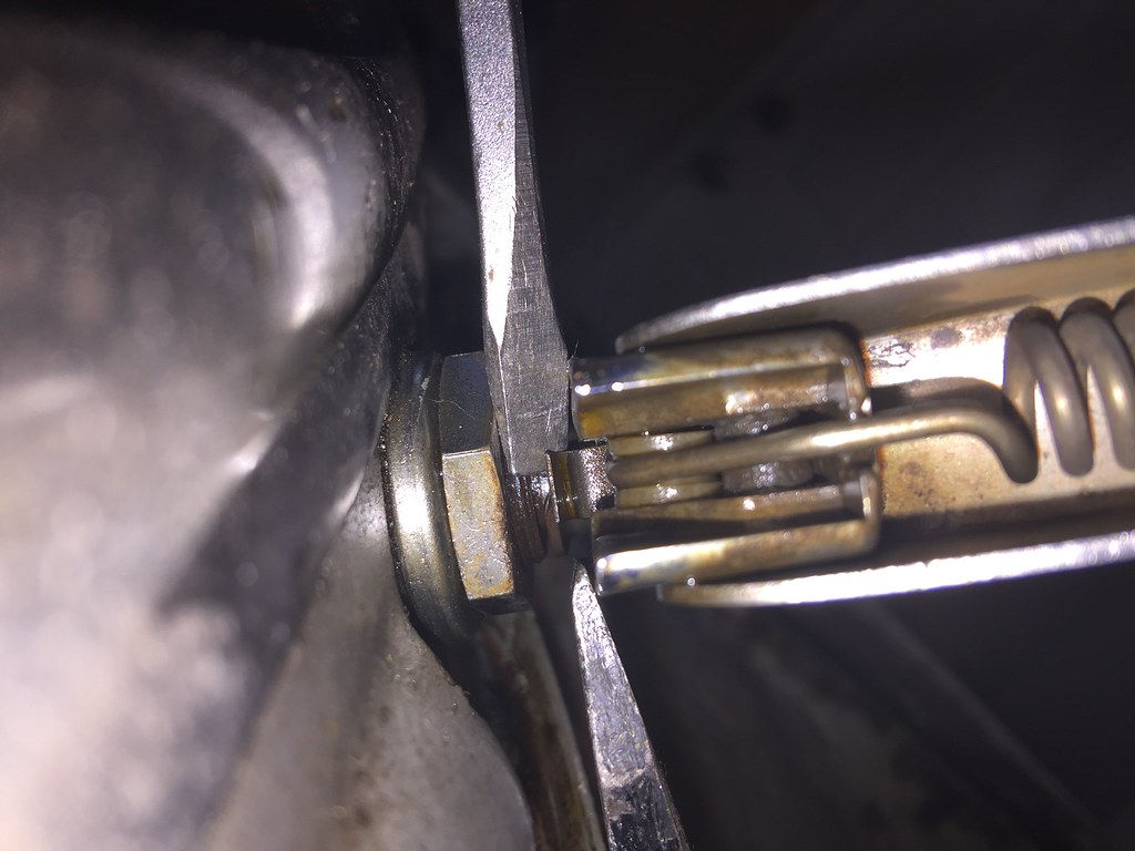

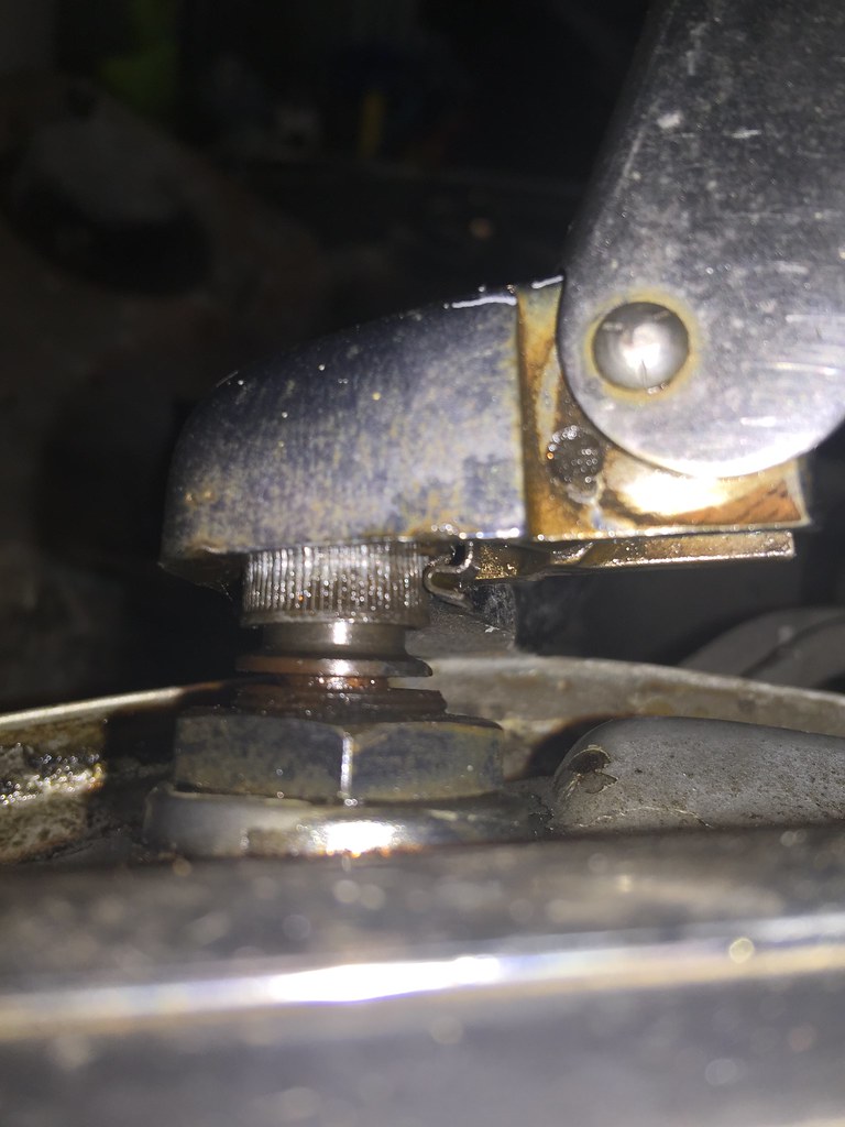

There is a spring clip at the base of the wiper arms. Use needle nose pliers or a screw driver to get the clip out of the groove and remove the arm. Press back on and make sure the clip is in the groove at the base of the splined shaft, otherwise the wiper arm could fly off at the worst possible time.
It's an airfoil to help press the wiper to the windshield for the driver, it works. You can swap the wiper arms so the airfoil is in front of the driver on RHD cars.
