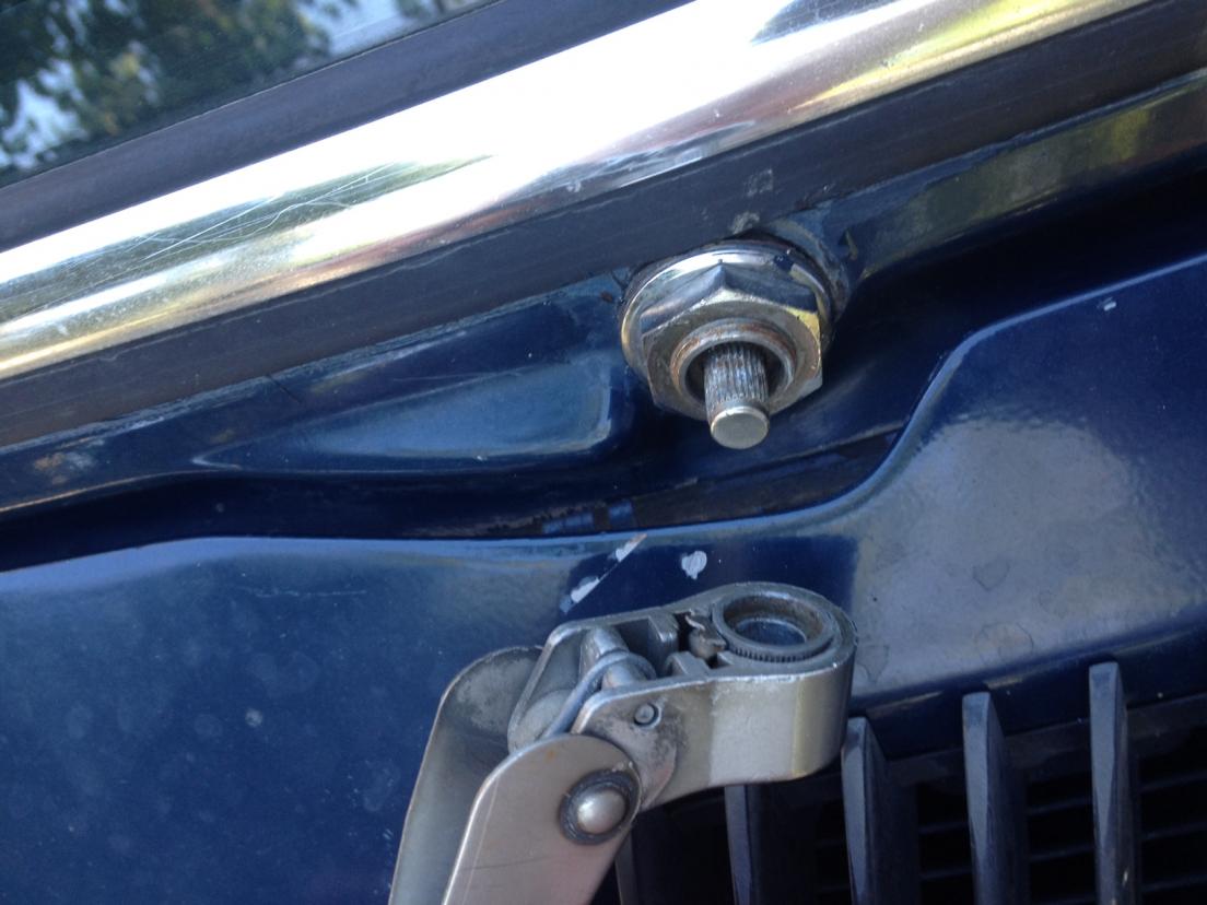

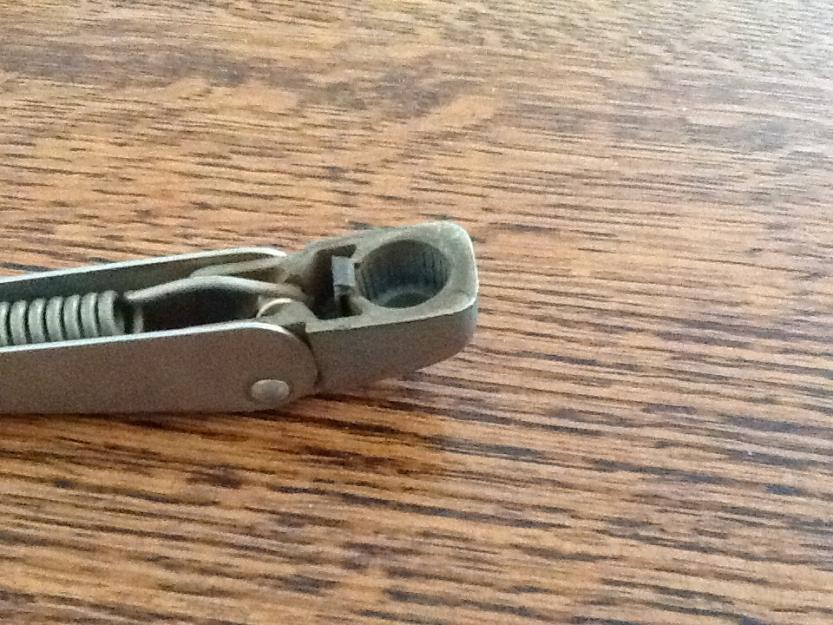

Hi, all. This question is for a 1973 E3, but I figured the E9s might have the same wiper assembly and there seems to be more E9 forum traffic so I hope it is okay to post here. I recently bought my 1973 E3. The day after I got my safety inspection (I mention that because I suspect the technician may have mishandled something) I turned on the wipers and the driver's side wiper didn't move. When I went to check it out, the whole wiper assembly came off of the shaft in my hand. I can press it back down onto the shaft but if I turn the wipers on this wiper will not move. The shaft itself is moving; the issue is that the wiper assembly is not engaging with the shaft. It's just loosely attaching to the shaft. I'm attaching a picture of the wiper assembly and the shaft I am talking about. Thanks in advance for any thoughts on this issue.

It looks like the splines inside the cylinder that fits into your wiper arm are worn, so the part longer grips the splines on the shaft that turns back-and-forth. I'd leave the wiper arm off until you get it fixed - those silver wiper arms are hard to replace. Fortunately your's didn't fall off while driving.
I'm not sure how to fix this, other than finding good, used parts. Pouring some JB Weld into the cylinder and sticking it back on the shaft might work for awhile, but it will quickly fatigue from the cyclic load.
The splined cap on your wiper shaft is stuck inside your wiper arm, pry it out from the spring clip. Maybe someone here has a spare, it usually isn't the problem, it's the splines on the outside of the cap and inside the arm.

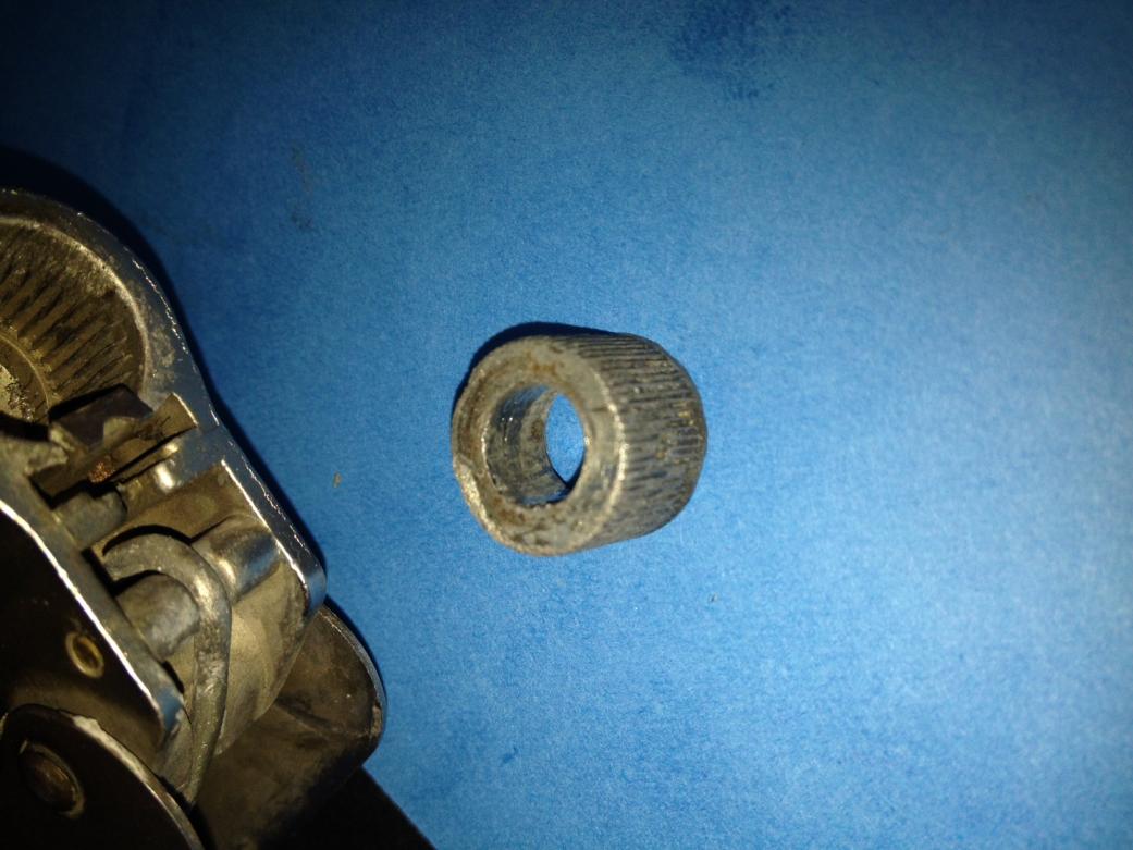

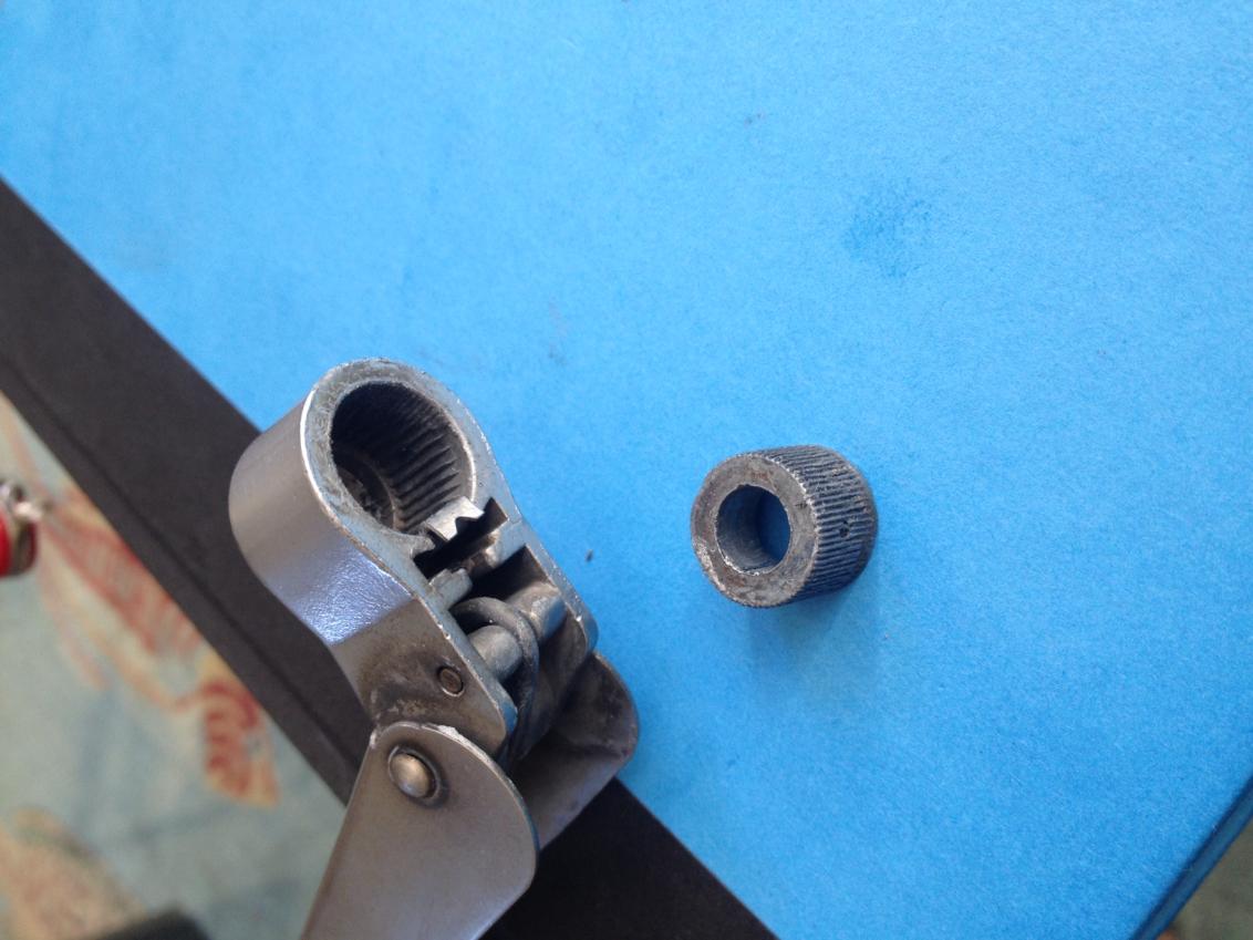

Well, here is the photographic update if anyone is interested. I extracted the splined cap from the wiper arm. I don't know if it shows up in the pictures, but the splines on the wiper arm and on the outside of the cap appear to be in decent shape, while the splines on the inside surface of the cap appear worn. If anyone has a spare cap, I'd love to take it off of your hands. Thanks again to all for the input.

Kluge FWIW
This exact thing happened to me. Happily, the wiper fell off while I was at a stop light and not on the highway. The part is unobtanium. You may notice that the shaft will slide right down into the well beneath.
This happened at The Vintage and with a consult from Rob "The Hack Mechanic" Siegel and Eric Wegwieser, we fixed it by putting just a small dab of JB Weld on the splines and re-seating the splined cap.
Your only other choice is to buy a complete, new wiper mechanism.
