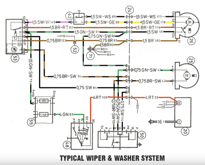

Motor has an internal switch which is used to stop to the motor (arm) in the initial condition.
This stop will work independently from the switch and relay. Only will off once the ignition will be off, so the problem can be at motor or the harness coming to the motor (short circuit).
Here is the diagram which will help to check the wire colors:
26 wiper motor
42 wiper stalk switch
53 wiper interval relay
24 connector
