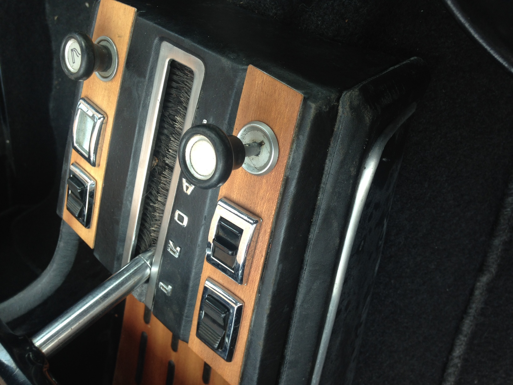

I have an E9 from 1974 LHD with a direction switch and wiper switch on the right hand side of my stearingweel.
Most of the E9 has a switch on the left side of the weel.
What is original and if it is original when did it change ?
Nico
All E9s up through 1973 had this stalk, wiper and turn signal on the right. For the 74 models the turn signal moved to the left side like all other car makers.
Get the actual build date from BMW. What switch do you have on the shift surround next to the driver, wiper speed or other?
