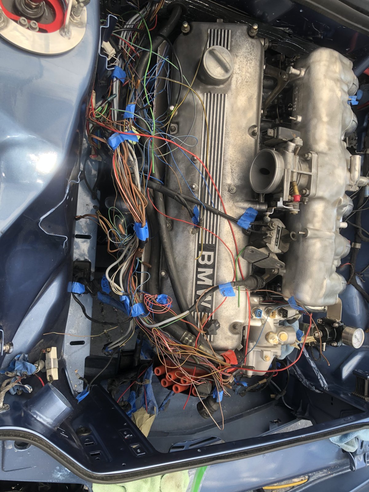

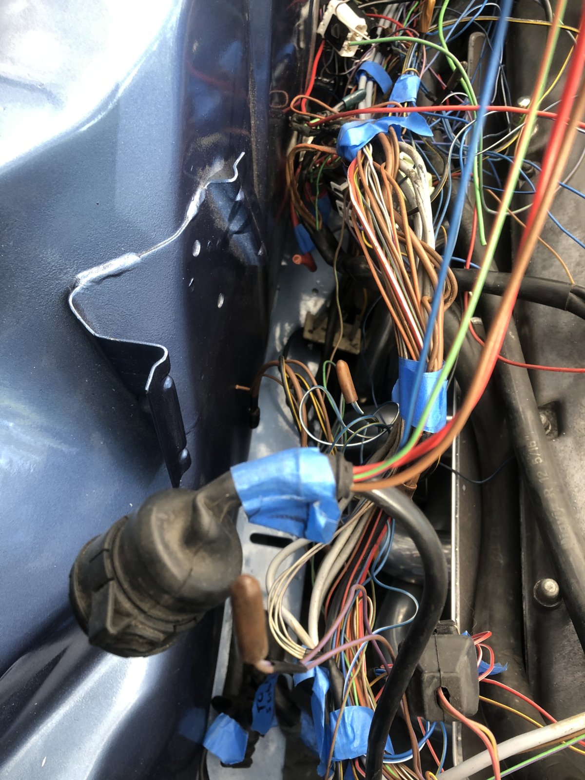

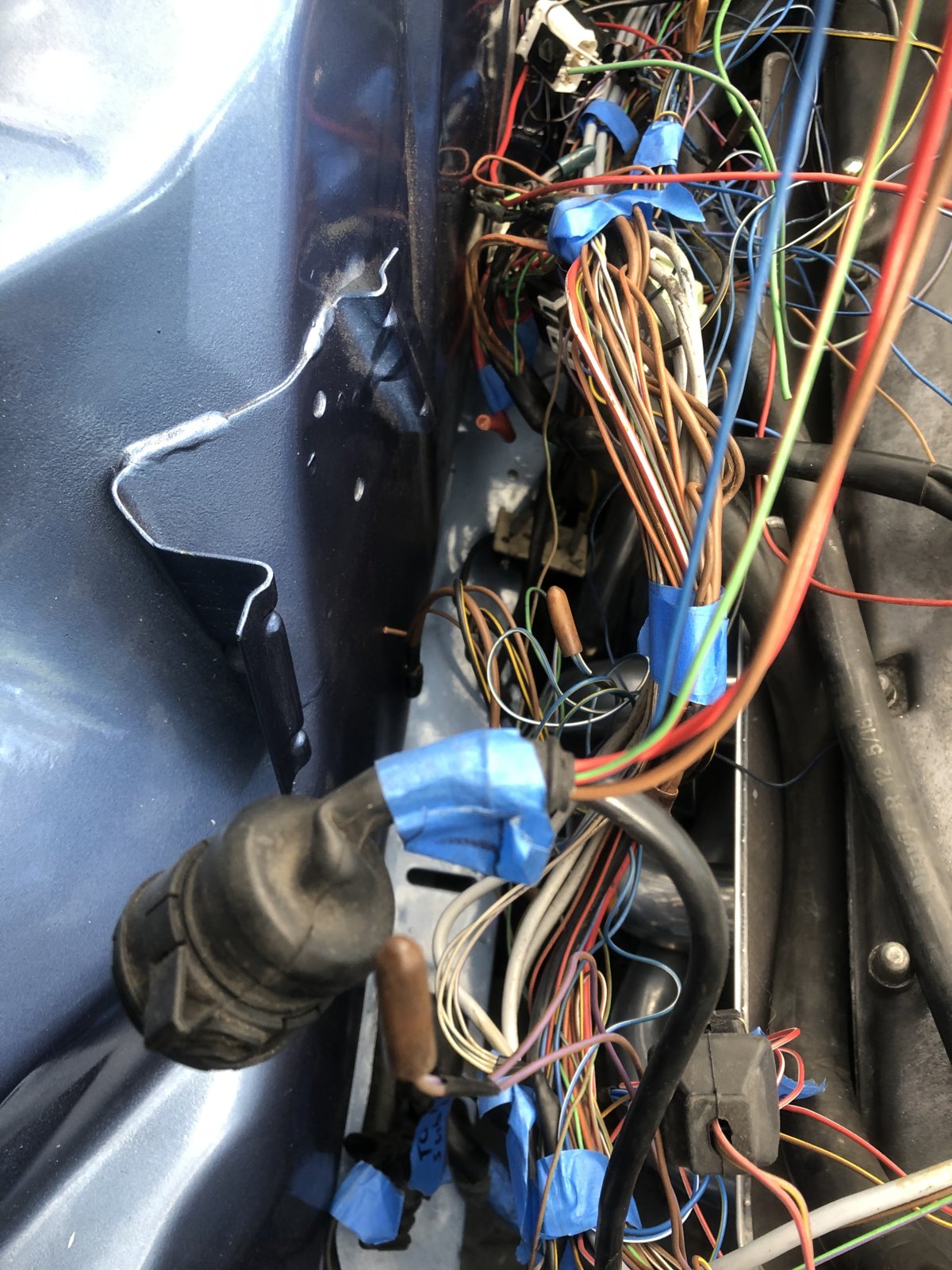

So the engine is installed and it’s time for wiring. Our engine, harness, and ecu all come from a 1992 735 automatic car. We have however changed to an l jet intake, injectors/fuel rail, and throttle body. Thanks to several days of research, we have been able to eliminate a few of the obvious wires that we don’t need, however, I am willing to bet a lot more can go.
Here are our questions:

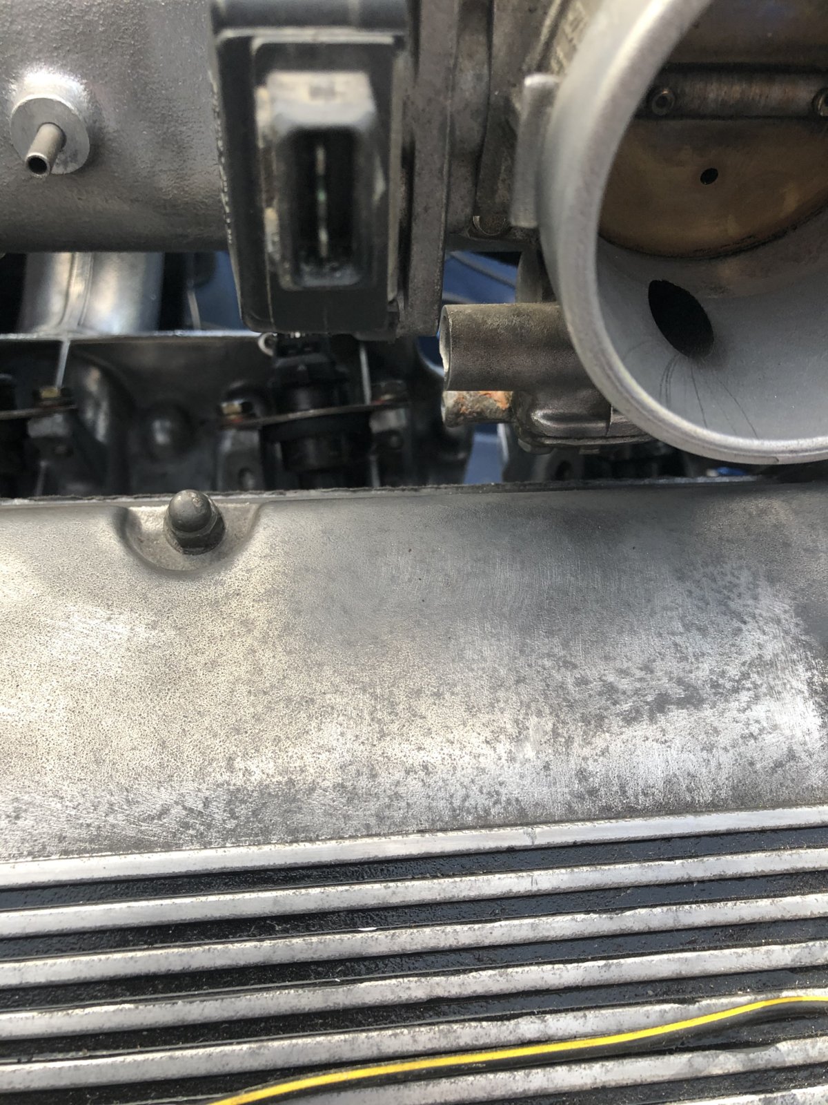

1)since the car was an automatic, the throttle position sensor is a round plug, and we only need three of the wires that run directly to the ecu. Now the l jet throttle body has a 3 pronged tps sensor, so we have sourced the corresponding plugger end to attach to the three wires we will be using. The question is, I’d assume certain wires need to connect in a certain order with the two tps pluggers, so what order do they go?
—I can clarify if needed
2. What else can I get rid of on this harness?
3. If we were to go to megasquirt, could we use this harness? What would we need to change/add? Is it better to go straight to megasquirt?
4. What wires connect to the coils from the chassis harness?
5. There are many threads about the wiring, but sometimes they give conflicting information, I would like to know, specifically with my type of harness, definitively what wires connect to the e9’s chassis harness

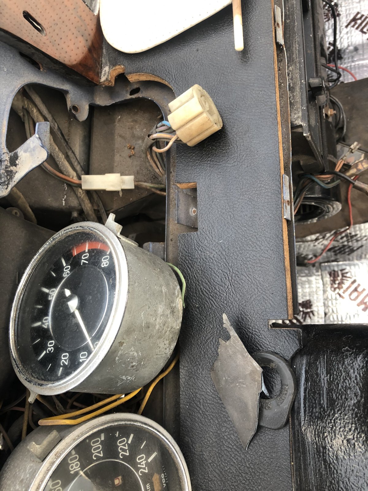

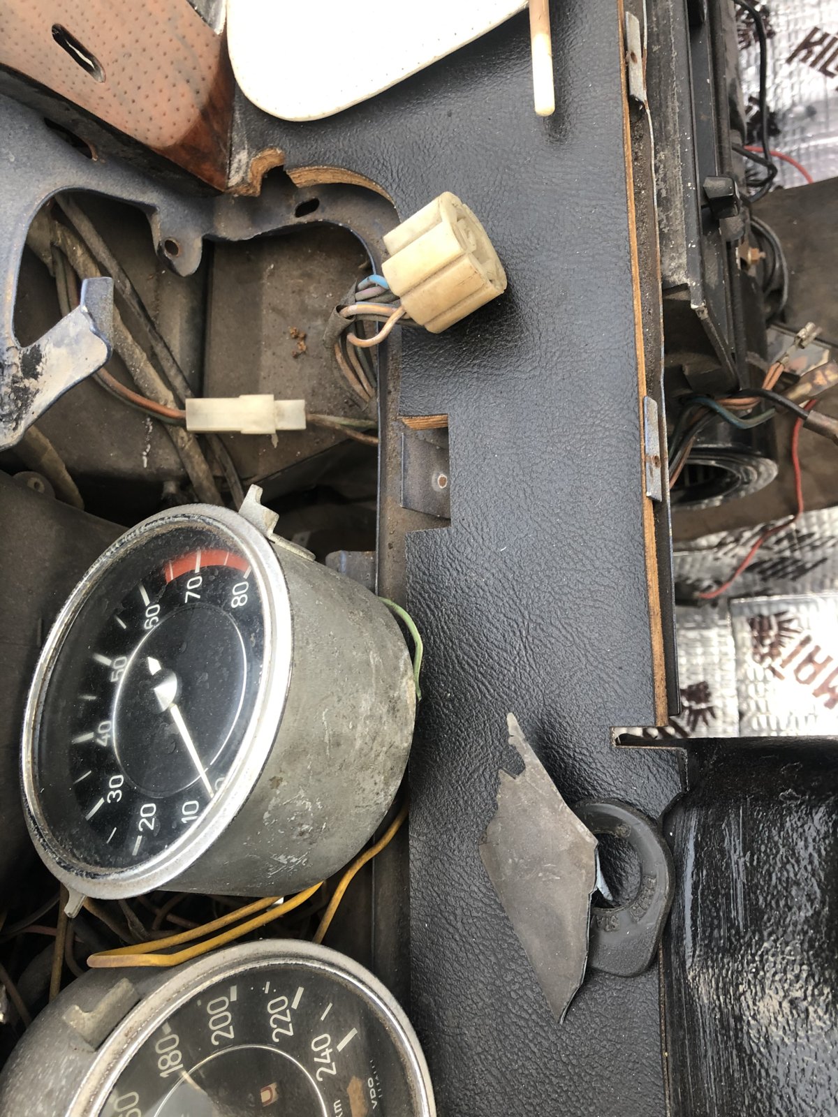

6. What’s this for? It’s not the clock so I don’t know where it goes.
If anything needs clarification I would be happy to do so.
