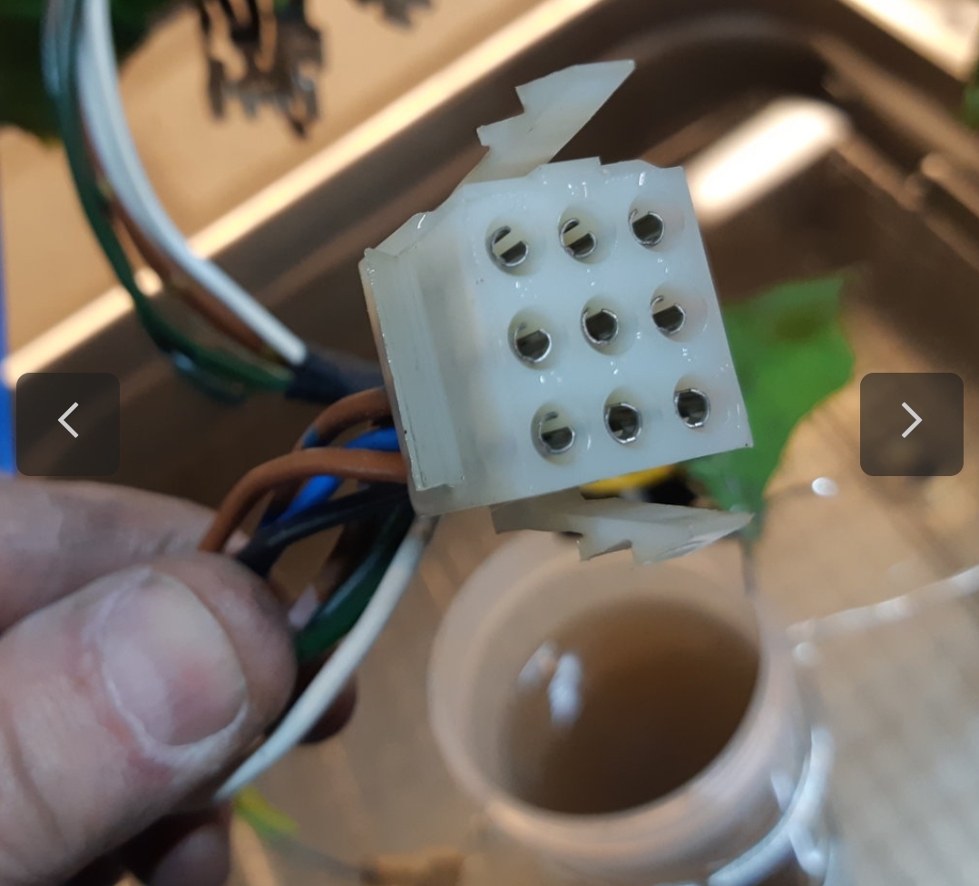

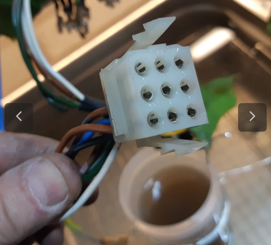

I've done the entire harness a year ago.
Really had good results with a basic small ultrasonic cleaner on the connectors. Gets them really clean. Here's one really filthy connector, after an ultrasonic bath: Screenshot_20230426_231625_Samsung Internet.jpg
