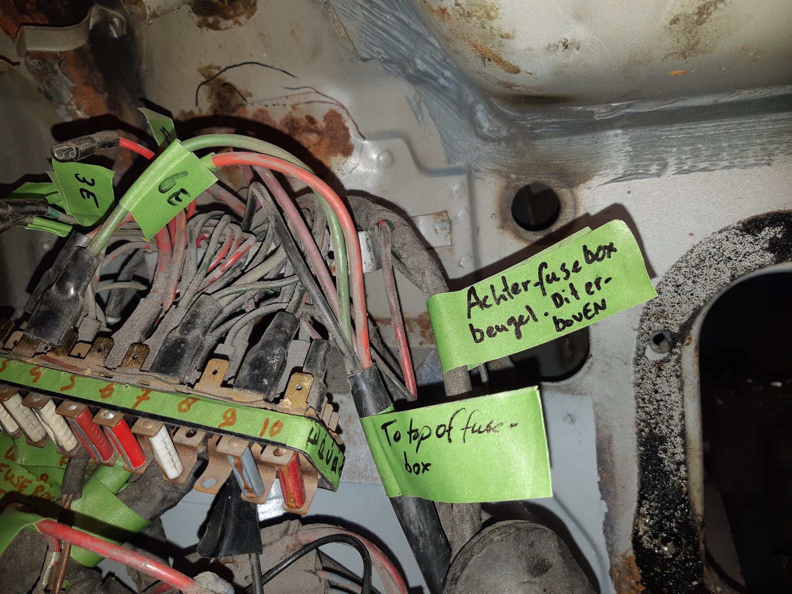

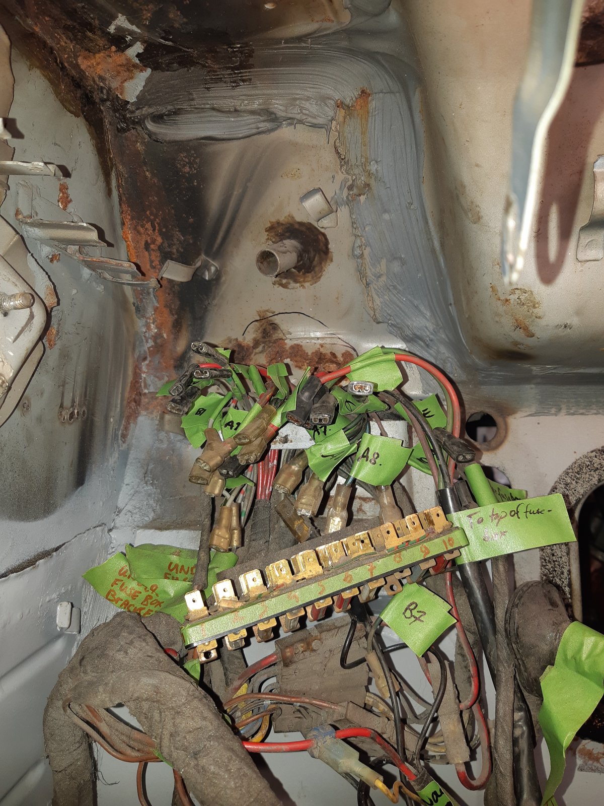

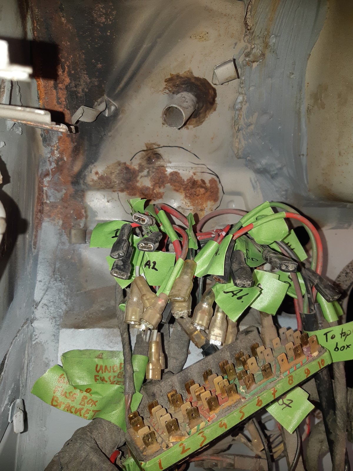

I only have LHD pics, but if you mirror that situation, you wouldn't too far off from original RHD I'd guess.
pic 1: from the fusebox the main branch goes up and over the ~12 cm wide bracket, and dives down behind it.

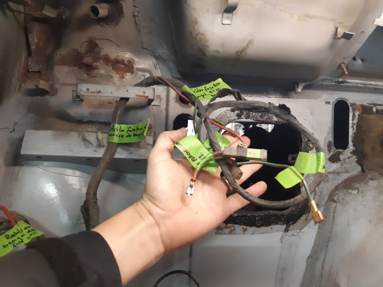

here you see 4 small tabs, one on inside A-pillar and 2 on the bulkhead. last one top right holding the harness above the pedal box, crossing the tunnel:
2 brackets above pedal box:
