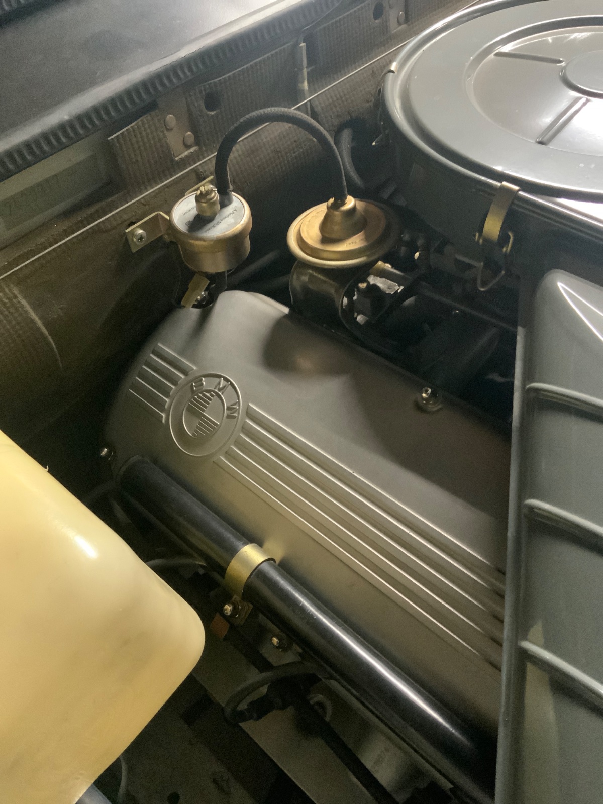

so i was putting in grommets for my wires + tubing going to the washer pump and i noticed a split in the harness right after the heater. there is a green / violet and a brown wire there that only goes about 6" past the heater. the green / black + brown / black keep going to the washer pump as expected. the only thing i could guess was this was an old feed for the fuel injection ECU. i guess i will rip open this portion of the harness and remove it ... unless somebody might have a clue what it might be.
i think i figured it out - there is a hole in the firewall and a grommet on the wires - i think it went to the idle control valve

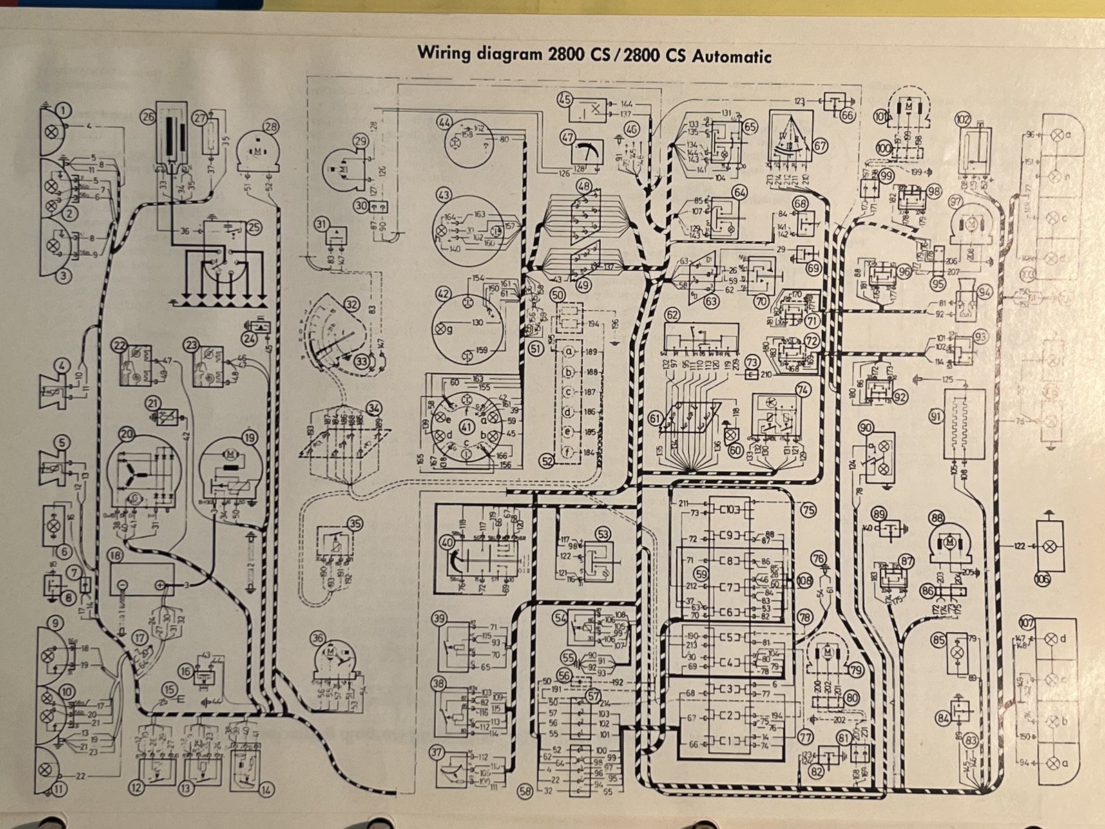

i think the choke wiring (green / white) ran alongside the oil pressure sender wiring. in looking at the 2800cs wiring distribution diagram, there wasn't anything else running in this area other than the wiper motor (36) and washer pump (28). you can see the separate branch going to 22 + 23 (chokes) and 24 (oil pressure sender). this wiring (that i was trying to identify) was only a 6" branch and it is solid green / solid brown ... which seems like added wiring. the wiring was inside the vinyl tubing that ran thru the air intake / windshield wiper area. in all of the harness work that i have done on my 2800cs, i have found this distribution diagram to be pretty accurate.

I'm iny barn now looking at my diagram 1969-70. The Only solid green wire in or near the engine bay is going to resistor for coil, it comes directly from fuse panel
now that makes more sense Chris ... hadn't thought about something like that. since i don't have that anymore, wire is removed and there is a grommet in its place
