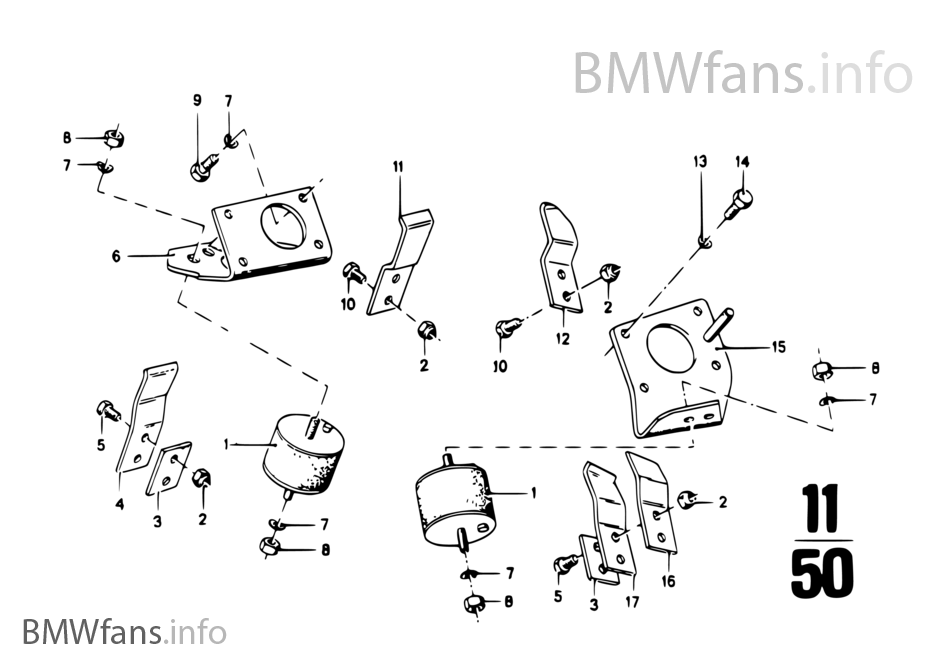

Not only check the clearance between fan and radiator, also check/replace the engine rubber mountings. kvy.png
If you are a hard braker (not heart breaker) you might consider installing these engine stoppers
https://www.cs-werk.de/cs-werk-bonn...-e9-set-anschlag-motorlager-links-und-rechts/

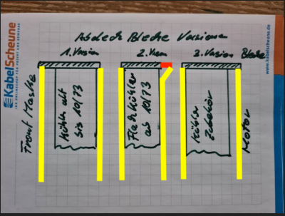

Sketch courtesy of @Christoph. Bonn, E9-Forum.de.
As far as I can remember yours is the one shown in the middle. It mounts close to the front mask.
Whereas the early one on the left points too far towards the engine due to the shape of the top plate.
The right one shows an after market type.
ECS sells radiators that require extensive reworking to make them fit because of the top plate that TomHom discusses.
