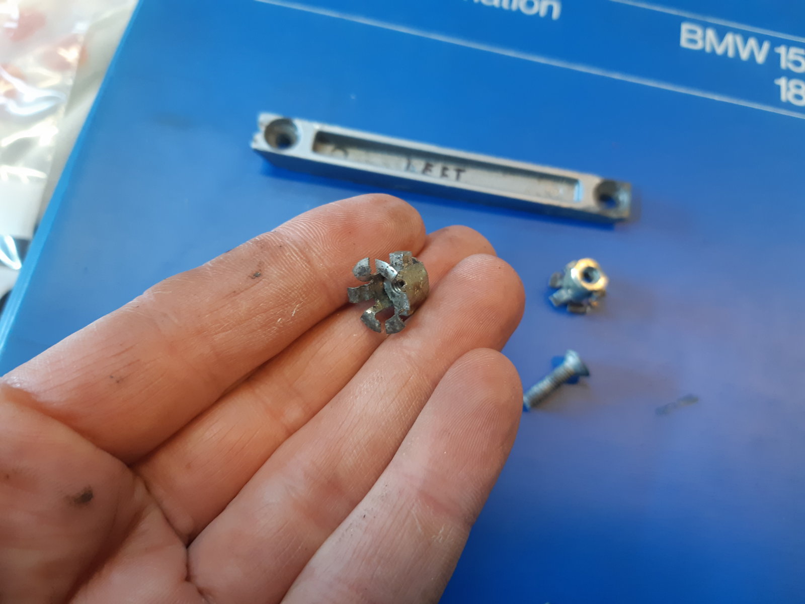

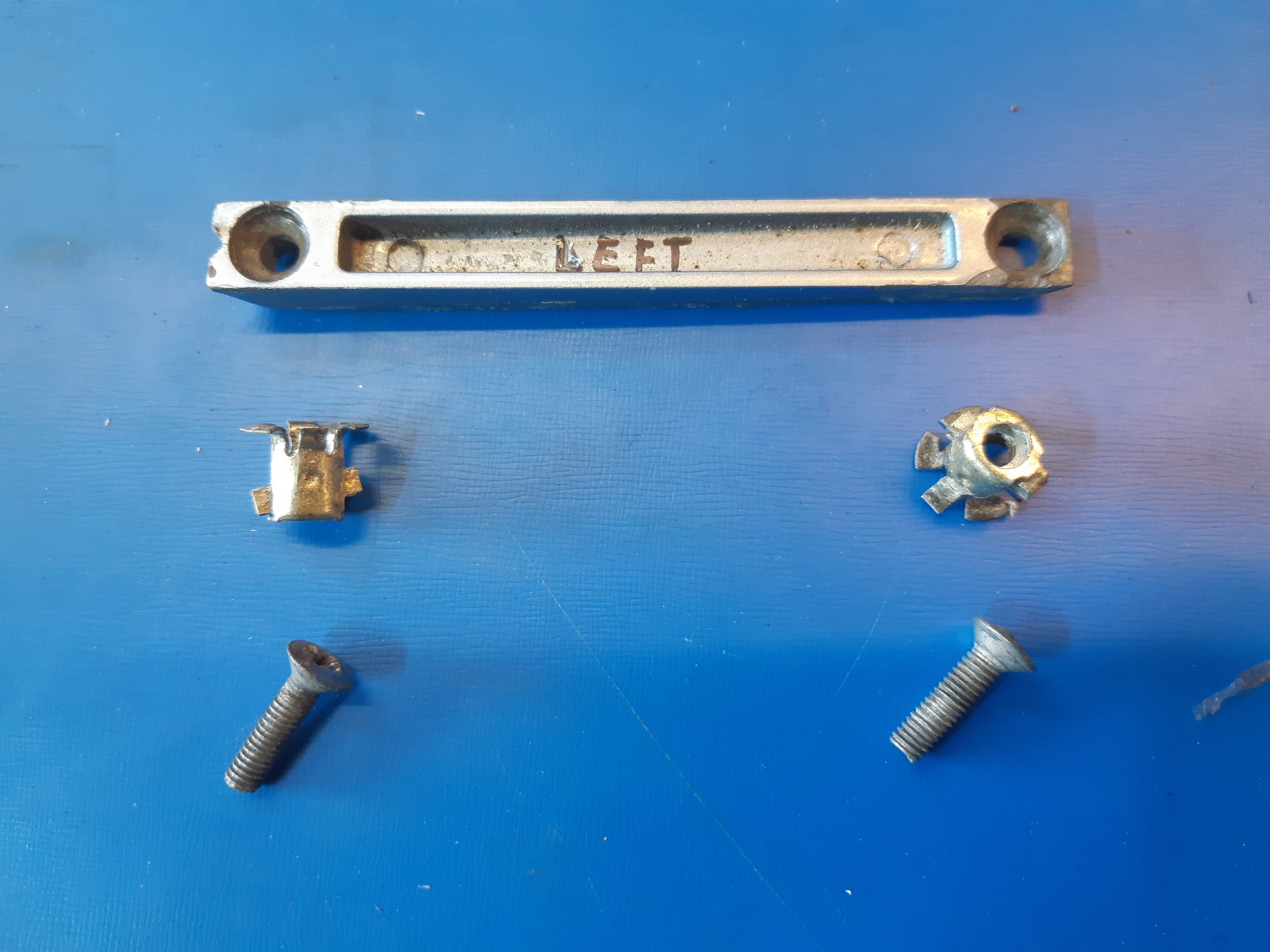

Looking to purchase 2 captive nuts needed to hold the outside rear view mirror on the door skin.
It's this part; looking for 2 of them. Can be NOS or used:
My right side door skins looks to have been replaced, or at least the holes are non-original. Likely a previous owner used normal sheet metal screws to attach the mirrors. Which works, but isn't original.

Thanks for all the replies. I do have a kit to place rivnuts in both steel and aluminum, but as others wisely noted, I hope that using the original part will spread the forces a bit if someone knocks the mirror.

Those original nuts are extremely weak and bend easily. I was a Business Management guy so I used screws. ;)
I also think those cage nuts were a concession to cheap and fast rather than longevity and strength. On my ALFA I will be using a hardened steel strip (0,25” thick), tapped for fine thread mirror mounting screws. I’ll epoxied a small thin rare earth magnet on the backside so the strip will hold itself to the inside of the steel door skin. The bar distributes the load from the screws, is easily nudged into position, and holds itself where ever you place it . On an E9, The mirrors are bigger and heavier than the little round Alfa ones (esp the flag style), so I would make it a little wider, slightly curve the face to match the door skin, coat/paint to slow corrosion, install with plenty of anti-seize. I think the only drawback is there is no tolerance for variation in mounting screw width on the mirror base.

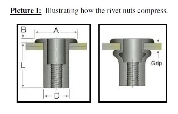

I considered the rivnut, but doubted it because of the thickness; the dimension B in the drawing, as the mirror bracket (the plate, marked ' Left' in post #1) normally sits flush on the door. Any thickness of B would offset the mirror bracket by that same amount.
And I'm not sure if the base of the mirror can adapt to it, if the plate sits 1 or 2 mm proud of the door surface.
They make riv-nuts that have a very thin beveled flange which sit essentially flush if you slightly dimple the metal. But Alfa’s threaded bar setup is superior IMHO. The magnet was my idea, but a dab of BavBob’s favorite gooey black strip caulk will also hold the strip in place long enough to mount a mirror and help seal from water intrusion too.
