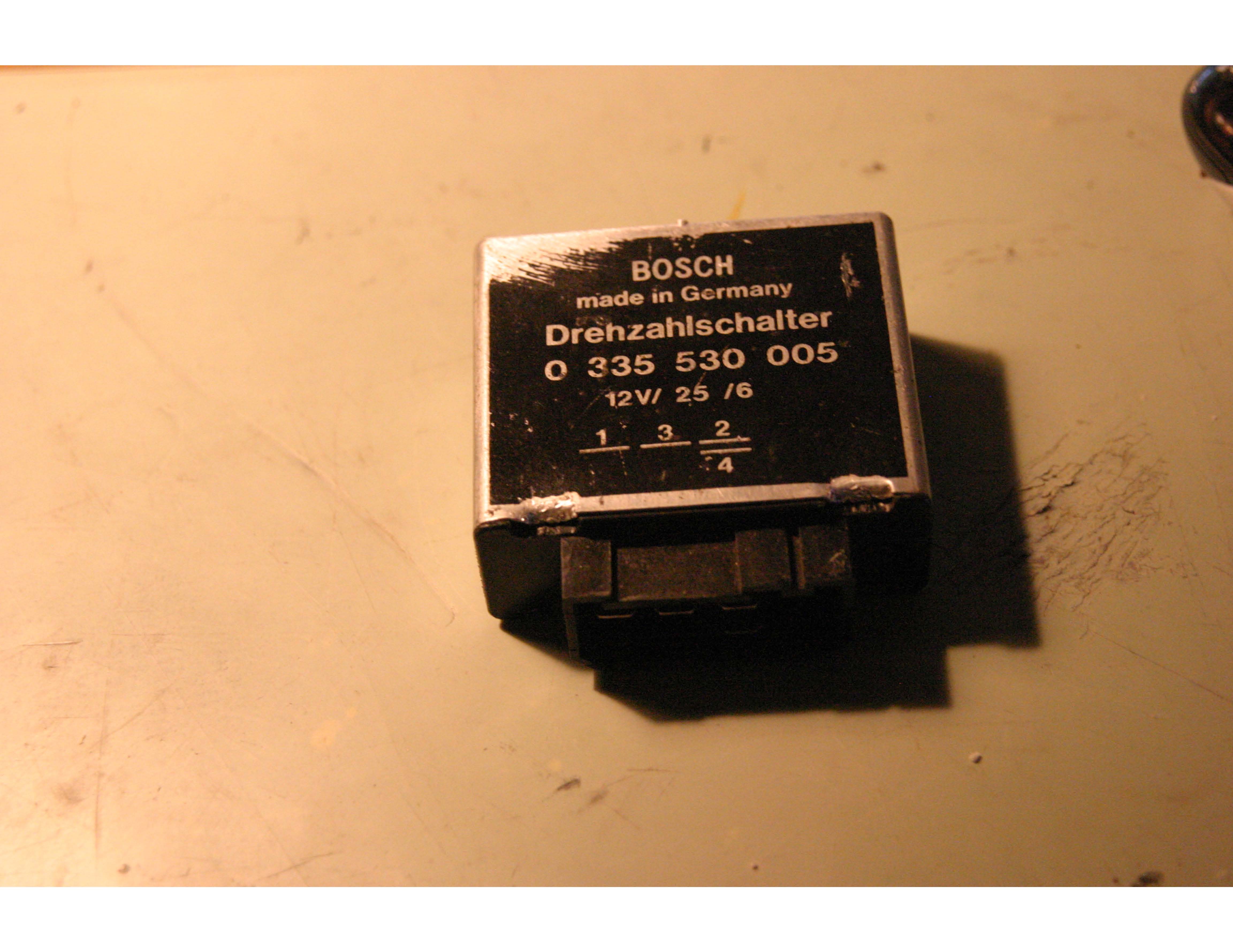

have a 74 w/ two silver relays in the bottom front right engine bay
they have two plastic connectors and wires i think that slip into them i can find mine
ok
this one

Alat,
Not sure those are AC relays. I had one, of these on my '74, not connected to anything. I had an operating AC system before I rebuilt it this summer. It certainly wasn't associated with that AC system. I think the one I had may have been associated with the emissions system. I've removed it from the car.
Those are emission speed relays, they are wired to the 2 valves with vacuum tubes connected to them up on the passenger side firewall. One went to the throttle linkage dashpot, the other maybe distributor.
Besides the speed relays 74s have a temp sensor in the radiator and a similar box to turn on condenser fan when temp gets too hot.
