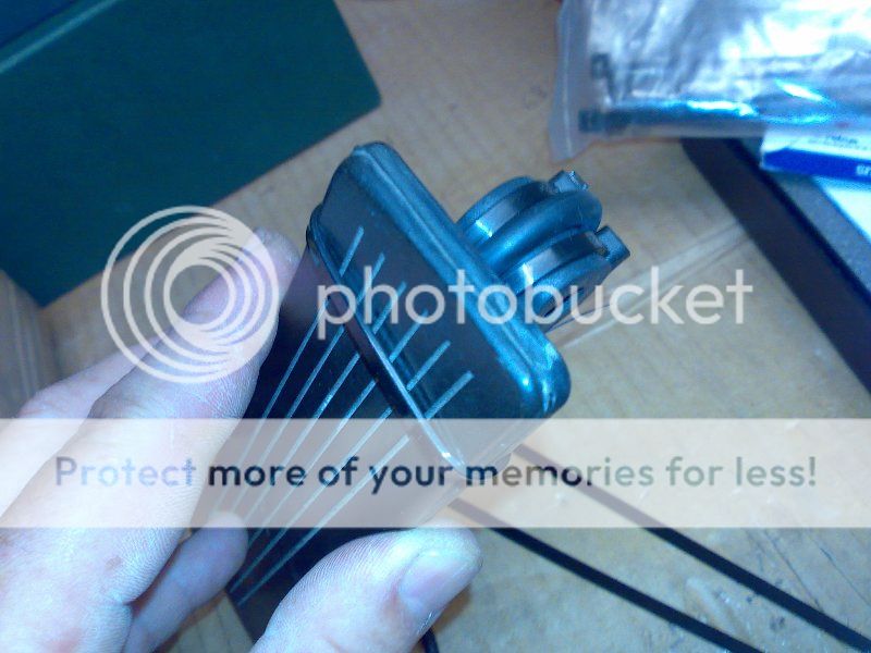

i bought it from walloth 2 years ago, anyway, this new one will have the same failure in the future, the design is poor
there is a way to repair it by yourself, if you interested i can tell you (some pics will do)

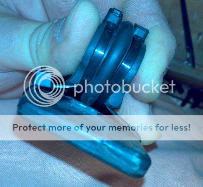

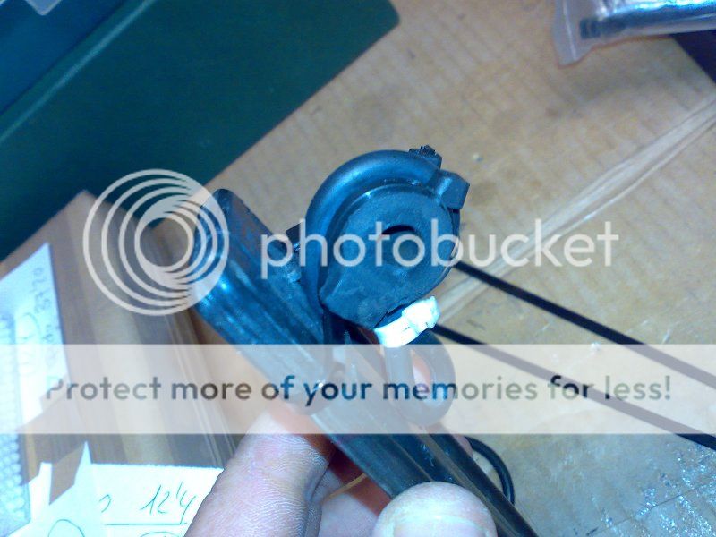

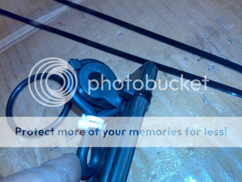

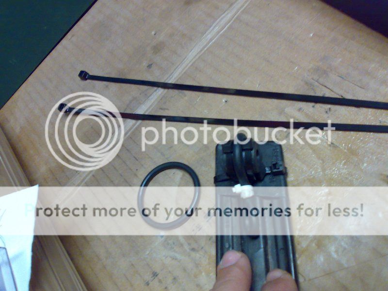

to those interested in the repair
i need to finkd my old acc pedal in which the solution was done in order to present it with some pics and explain how it was done,
i hope this weekend i will have some time to do it
please forgive mefor this delay
regards
repair, you need your broken accel pedal including the broken part that is hooked in the acel rod
besides you will need a rubber ring and some straps
a correct diameter rubber ring will be better than mine, but anyway some straps will adapt it
it provides good fixing but enough flexibility and play to accomodate acelerator pedal movement
