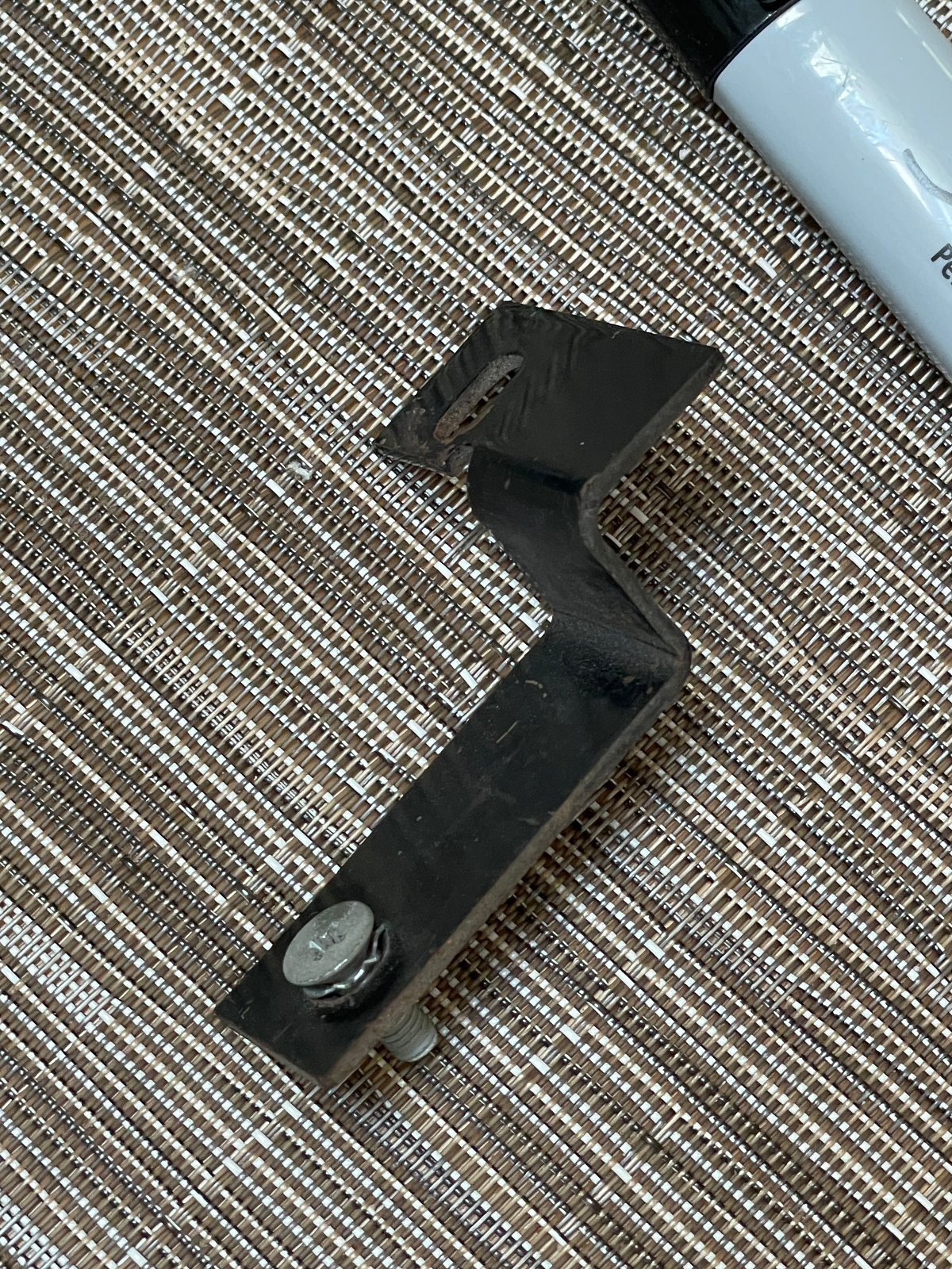

I need the Z bracket that attaches the center console side panel to the plate that is attached to the transmission tunnel
This bracket is at the lower forward corner of the console side panel
It is about 2 inches long
I have the left hand one, I need the right hand one
This photo is of the one I have, the left, I assume the RH will be a mirror image

Do you have a set of calipers or can you measure how thick that is? Looks like something could just do in my garage for cheap, it might not be exact but would serve the purpose. If you want to go that route…happy to help, I’m Seattle as well
I had to bend some similar brackets for my MG’s supercharger springs, just basically it needs to have the two attachment points correct relative to one another, I don’t think that the bends need to be millimeter-exact.

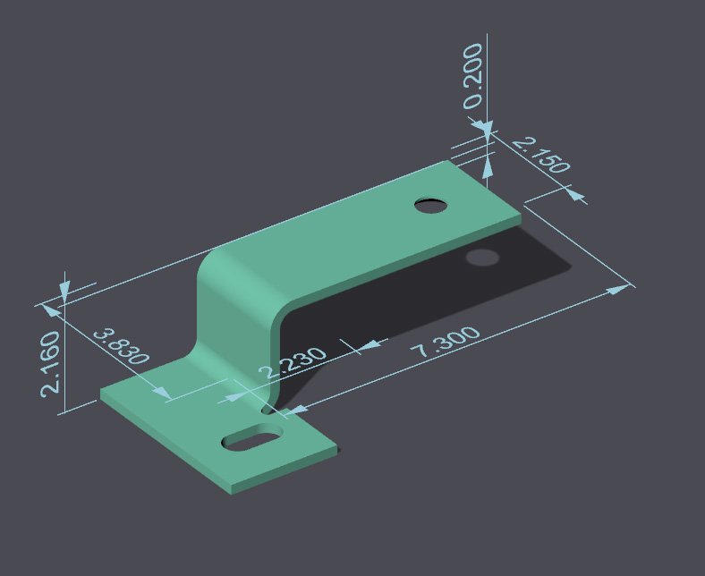

Yes, I drew if up in CAD, this is the side I need
Does not have to be machine tolerance, just screws into a piece of plywood!

Nice, that was fast. You guys and your CAD work!
Looks like we start with a 4 cm x 11.5 cm piece of metal, cut out a 9.5 x 2 cm rectangle on the right side leaving the "L" shape, then just bend 90 degrees at 2 cm in and then back out at 4 cm leaving the 7.5 cm run. I've usually made little brackets like this out of 18-gauge steel, which is about 1.3 mm thick, maybe for this do out of 14 gauge which is 2 mm thick. Since my car is still at the shop getting shocks/springs and my MG is waiting for a part as well, I am car-requirement-free tonight. I was going to work on figuring out Fusion so I can update the Iphone battery stand @Bmachine had made, but if I need to do something physical I'll make a quickie version in the 18-gauge if you want just to see if it works. Only if that's the route you want to go - if someone has the part readily available or if you want it to be perfect then this obviously isn't the way.
if you can make it, that would be fantastic!
I can make a flat pattern

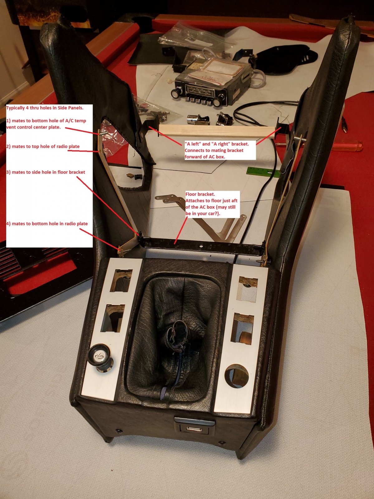

Mark sent me a picture of where this bracket goes. I don’t have this on my car, looks like maybe an AC-car only part?
In this photo, is it the “A Left” and “A Right” brackets?

You need at least three per side, one into vent fascia which is a machine screw and two coarse sheet metal screws into the a/c panel. Last one is bracket under the window switches. The one up front doesn’t attach through the panel and was always a pain for me v

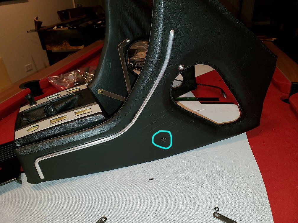

by bracket under the window switches, you mean the one I circled in Cyan in this photo?

No but that one isn’t needed and my first 73 had no holes there. I was referring to the two L brackets holding shift platform to side panels hidden under the window switches.

interesting, on the L brackets, don't those just hold the switch platform to the side panels, not attaching it to the car?
with out the lower, mid, side one, the one I circled, and without the very forward lower one, the only 3 per side holding the console to the car are the 3 you described?
Just an idea, I might try and expand on coupesport's idea and not have the lower show as well, that is why I think I probably need the other connection
