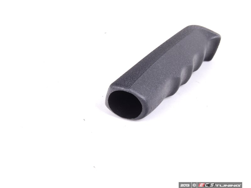

unless you have a supreme desire to stay completely original, you can buy the newer style from bmw for the coupe, bavaria + 2002 ... it was the one created in '76 for the last few batches of the 2002. its a molded grip that fits the hand better. its only about 5 bucks or so. you can even buy a new button.

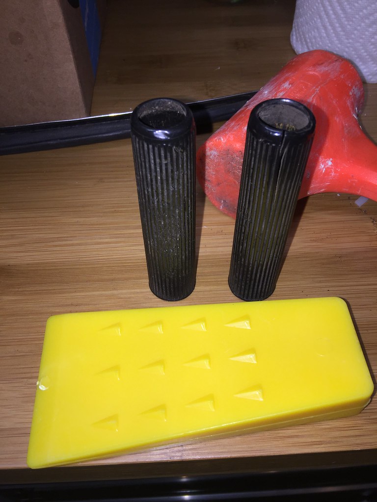

Hi Roger,
Well it looks like one of mine is cracked. It's not as bad as yours but still cracked nonetheless. This was the 'good' one also. Incidentally the orange deadblow and the yellow wedge is how I removed it. The pointy end of the wedge actually put little marks in the end handle, so I reversed it. No lubricant required. Anyway, PM me your address if you want me to send it your way.
Is it me or do these grips look slightly different? The left is a '73 3.0CSI and the right is a '71 2800CS.
Given that these are NLA, I think I might send my other grip to my 3D modeler, along with another small important part. It should only take him about an hour so the development costs should be low. The part uses little material so the printing costs should also be low.

I believe these were on 2002's as well (the style you are looking for). I think they fit the same, I could be wrong but that opens a lot more doors. Bavaria and Coupe grips swap no problem.
34414660109 (This is the e9 part number)
Handle
From:
11/05/1975
To:
01/14/1999 (ENDED)
Weight:
0.012 kg
Price:
Superseded by:
34411116435 (This is the replacement)
(11/05/1975 — ), nonexchangeable retrospectively
Part 34414660109 was found on the following vehicles:
Here is what 34411116435 looks like:
