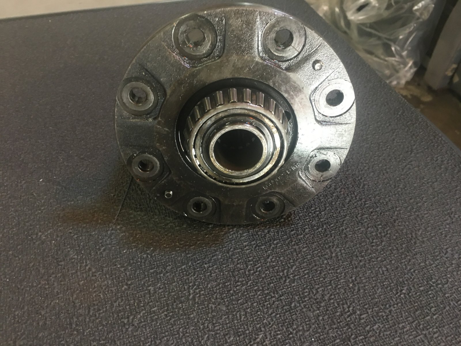

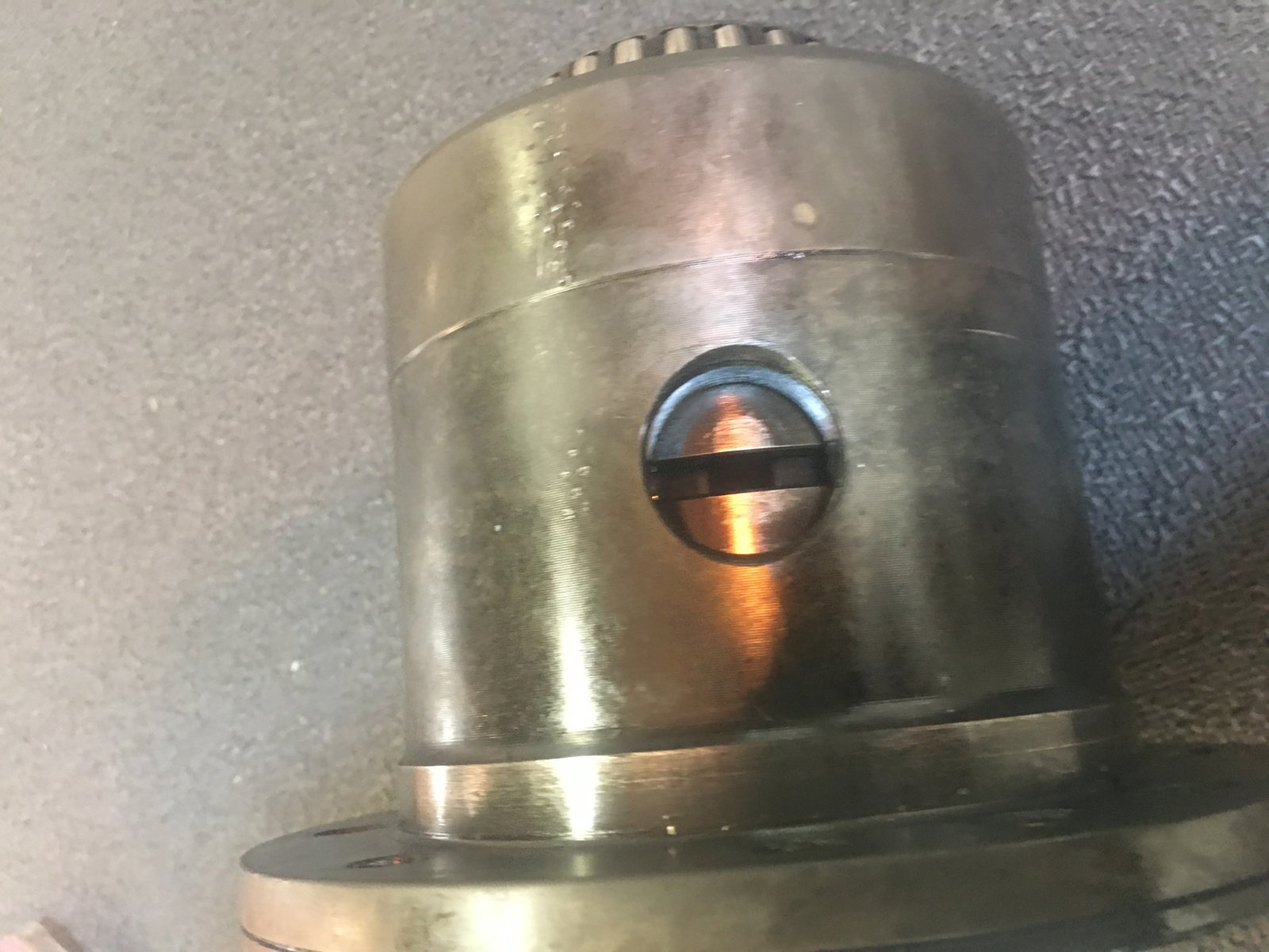

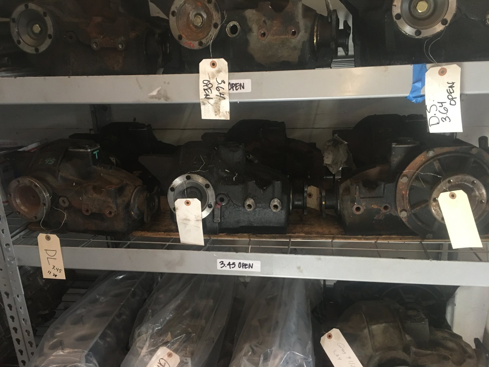

thoughts on this?
Swap an 8 bolt 3.64 LSD for a 10 bolt LSD whatever you have or buy a 8 bolt LSD and sell your 10 bolt LSD?
This country is swimming in 8 bolt 3:45 diffs.
Mostly opens…

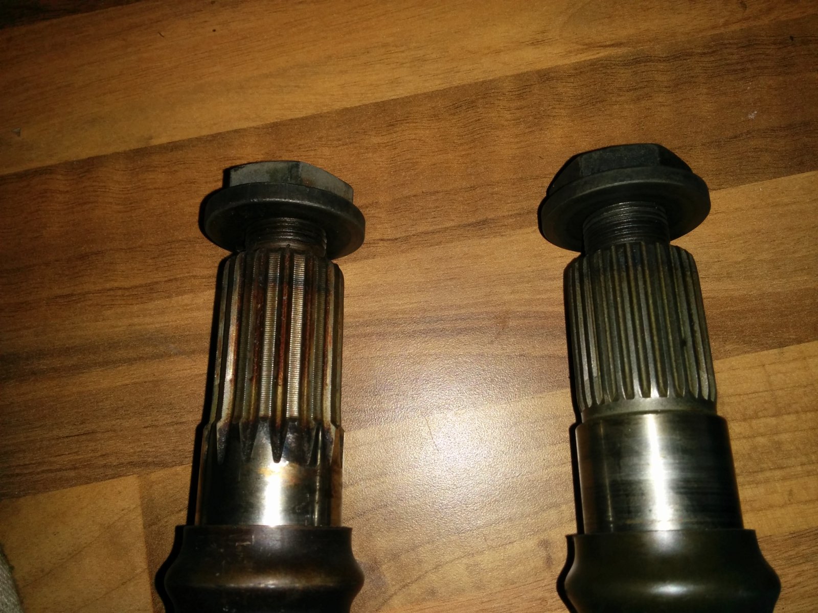

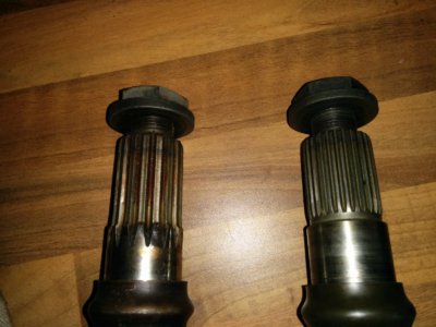

For the benefit of the group, i purchased a 3.64 e34, 188mm, early diff. (cheap).. The gear set is perfect, will work, except the "spline teeth " on the pinion are too fine for the sideloader drive shaft coupling.!!
so close............
Thnaks again SFdon,, one final hail mary..

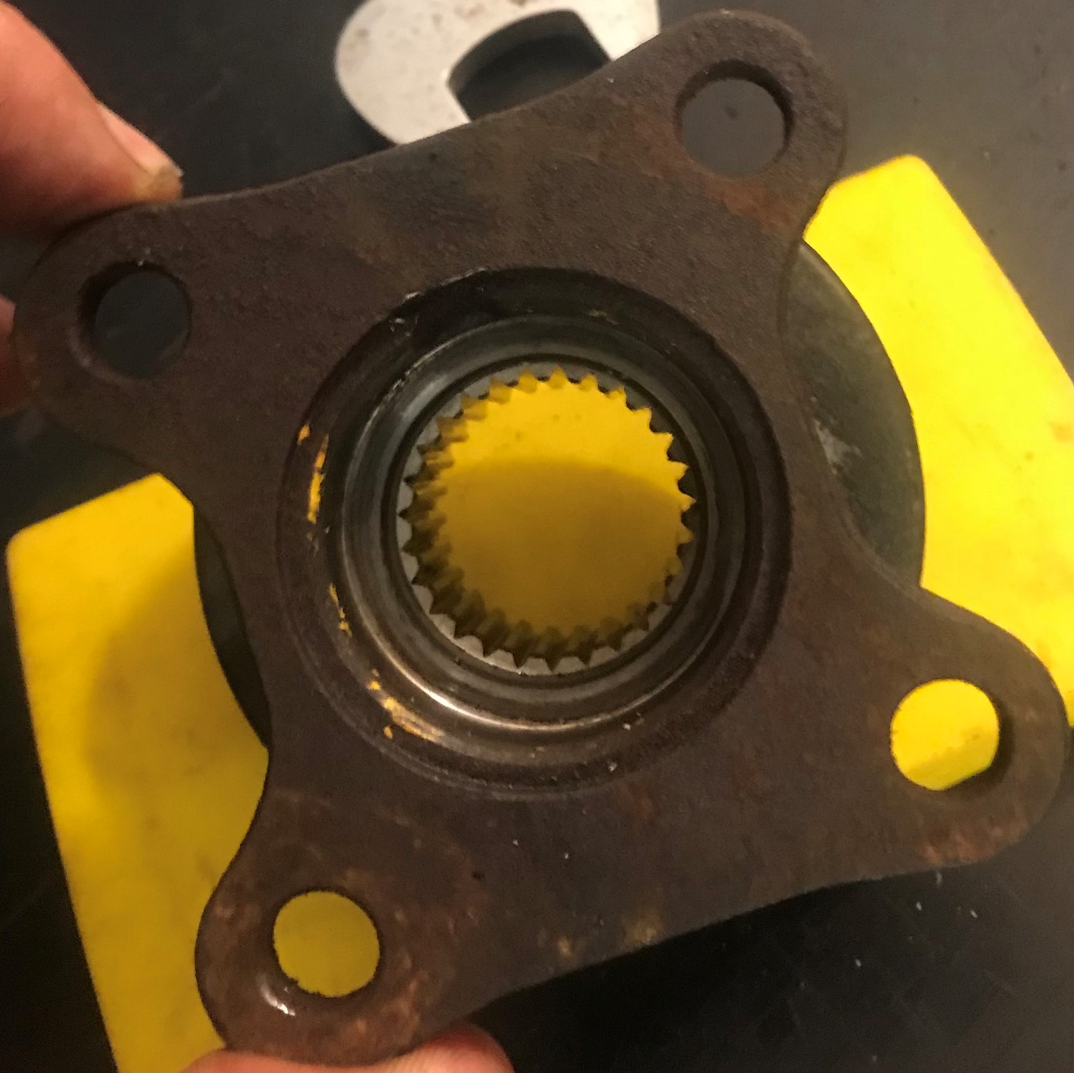

I have a pic of the standard, drive shaft flange, 84mm, 4 bolt. Have also included a pic from frogisland, with the 2 different , pinion patterns, that he has seen used in the sideloader.
Did bmw make 2 different 4 bolt 84mm flanges for the sideloader? One with wide teeth (early), and one with fine teeth (Later)?

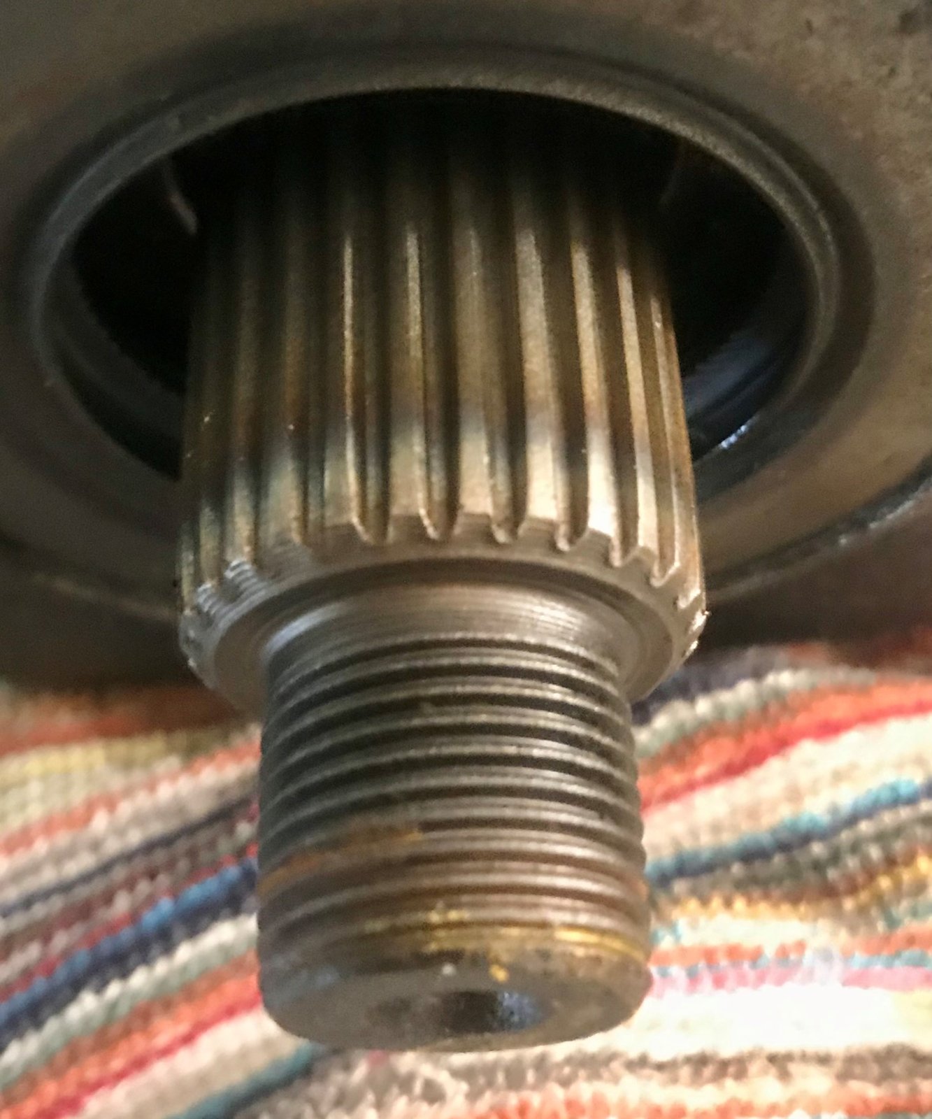

Have found a "tight spline" driveshaft coupling. I will check it works with the pinion from e34 medium diff tomorrow.... but looks good.
So, I have all my answers..
slide out flange, 10 bolt/m12 sideloader, from say early e24, or late e12, used fine spline pinion, so has the fine spline coupling.
Diff is compatible with the early medium "rearloader" diff crownwheel and pinion, as found in the e28, late e24, and early e34 etc.
I have just installed a 3.64 crownweel and pinion, from a 94 e34 520i, into my late sideloader.
All of those later crownwheel and pinion ratios should work, in the late sideloader.
I addition, the crownwheel, I took out of the late sideloader was a low drag , 25mm, type, the one I replaced it with, from the 520i, is a regular 30mm one.
My diff man tells me, all bolt in, no machining, just shim adjustments as per normal when replacing crownwheel and pinion.
