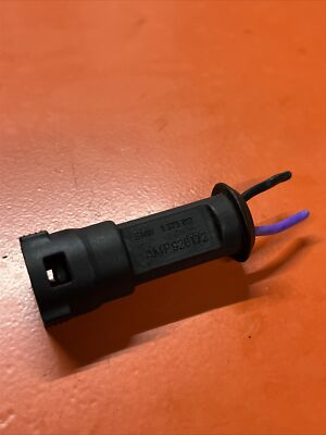

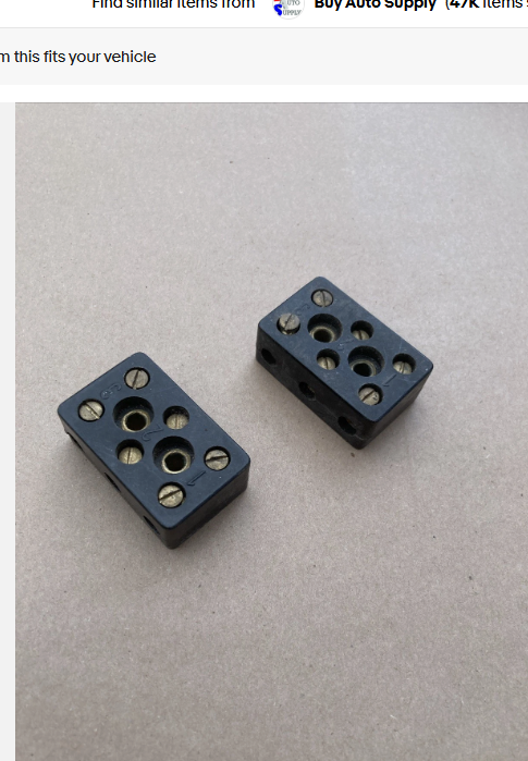

Where can I purchase one of these electrical termination blocks
My e28 motors have plugs with very small round female receptacles. The wiring on my car has flat female receptacles. I was thinking that the blocks would be the cleanest.

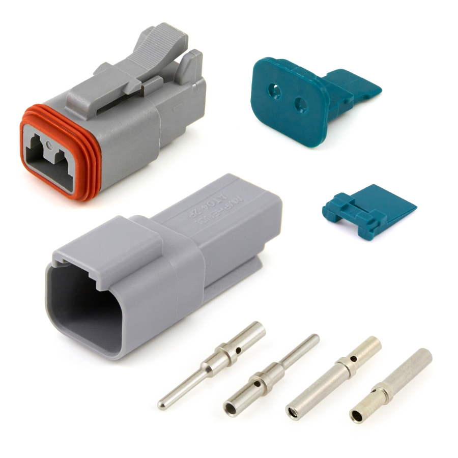

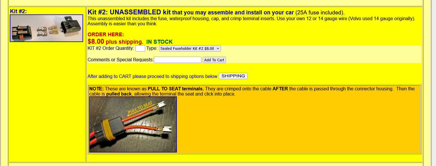

To each his own, but as I did rewiring in my car for things which might need to be removed/changed later, I wired in new clips to make the job easier for the next person. These blocks are fine but are to me a little more work than just unclip-reclip. There are even waterproof ones for things like fog lights, etc. there are period-correct ones but they are a little hard to find. I used the equivalent of these. Just a thought

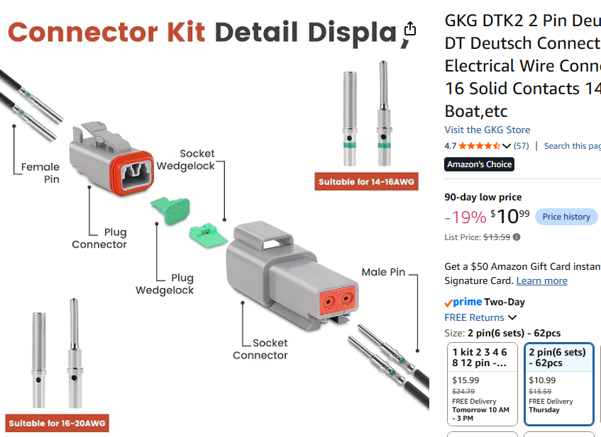

This is nice. Can you send me a link?
There are many kits like this available from the world’s largest online store :)
If you want to avoid Bezos, this kit would work.

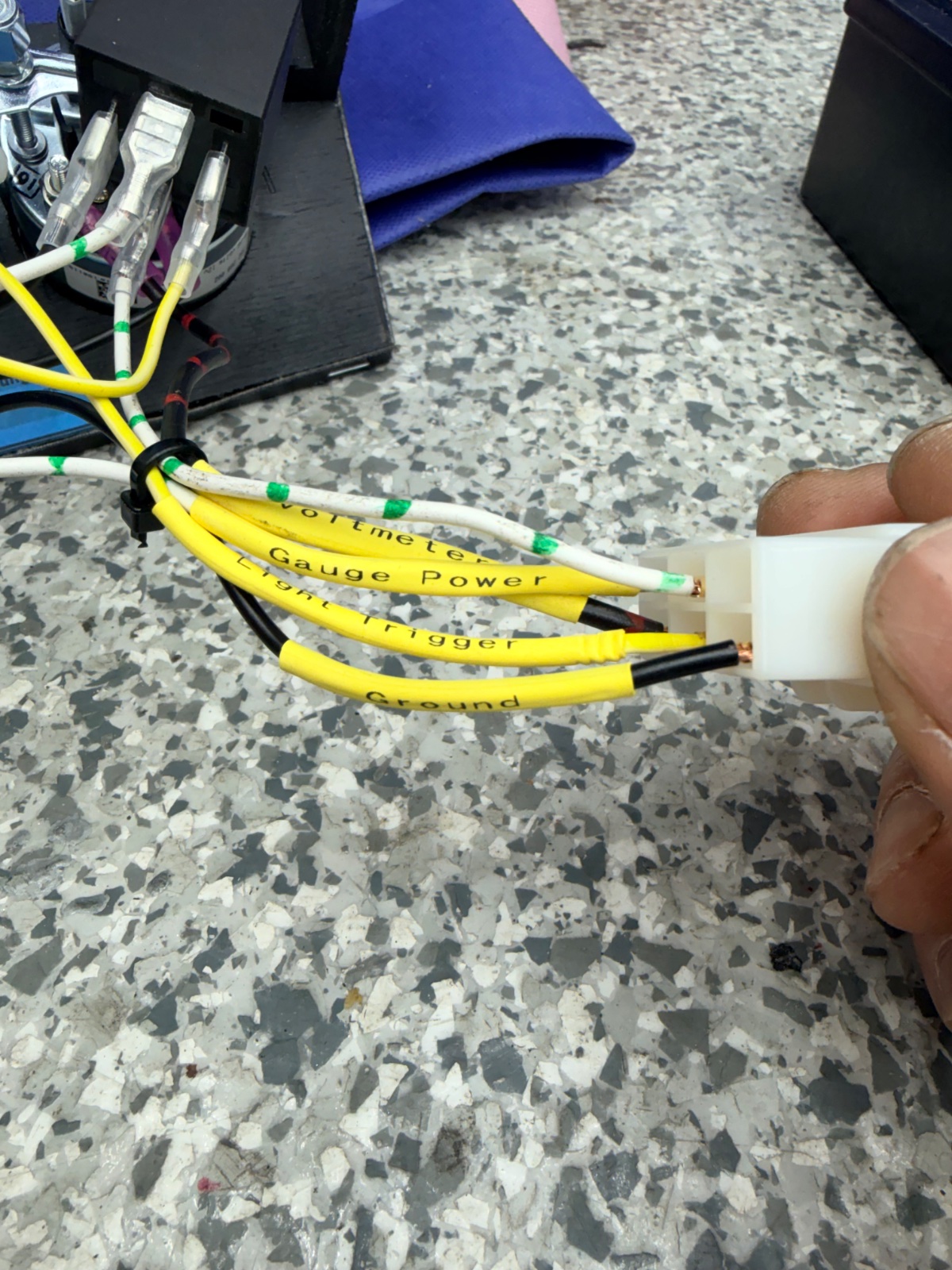

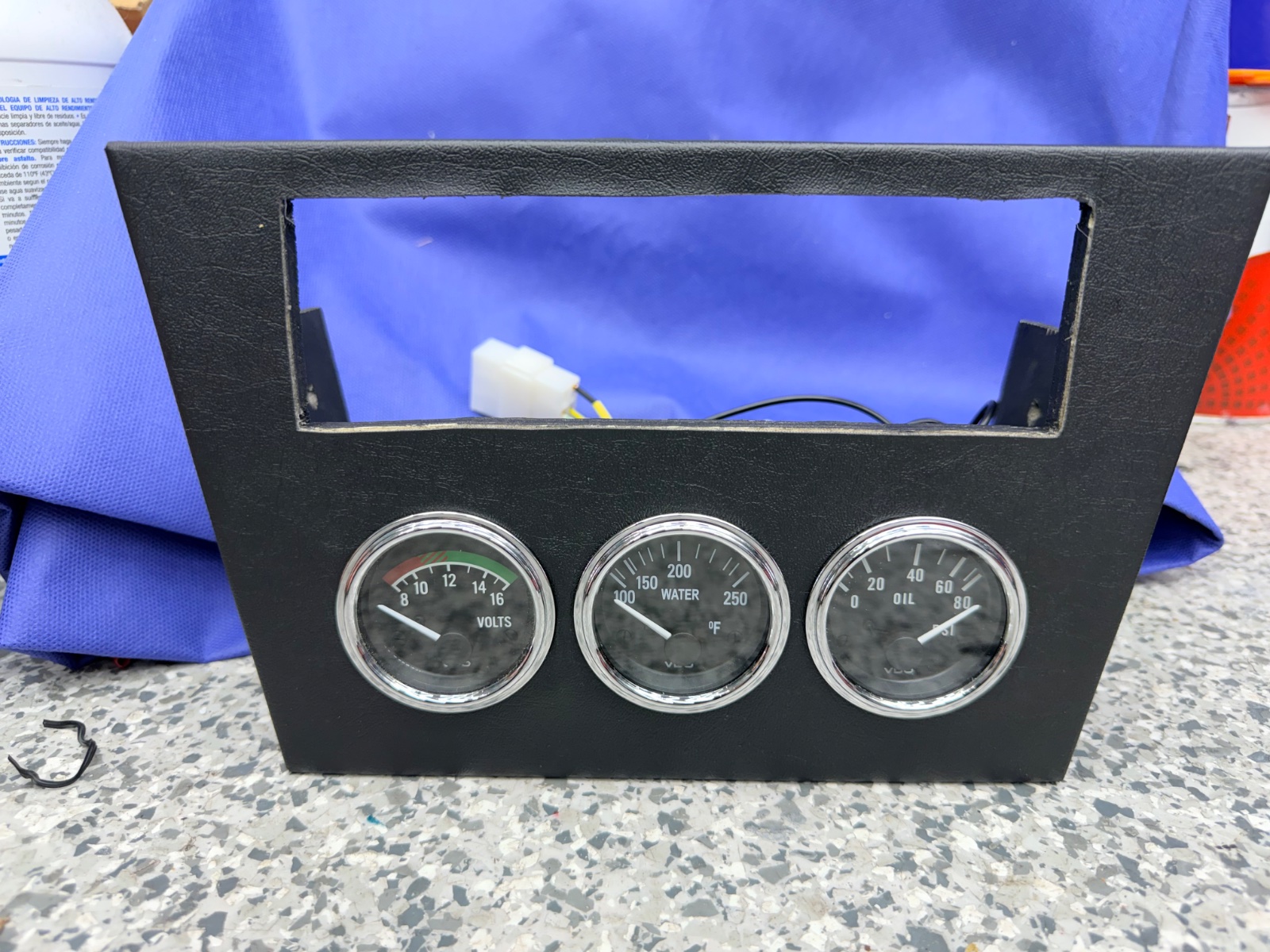

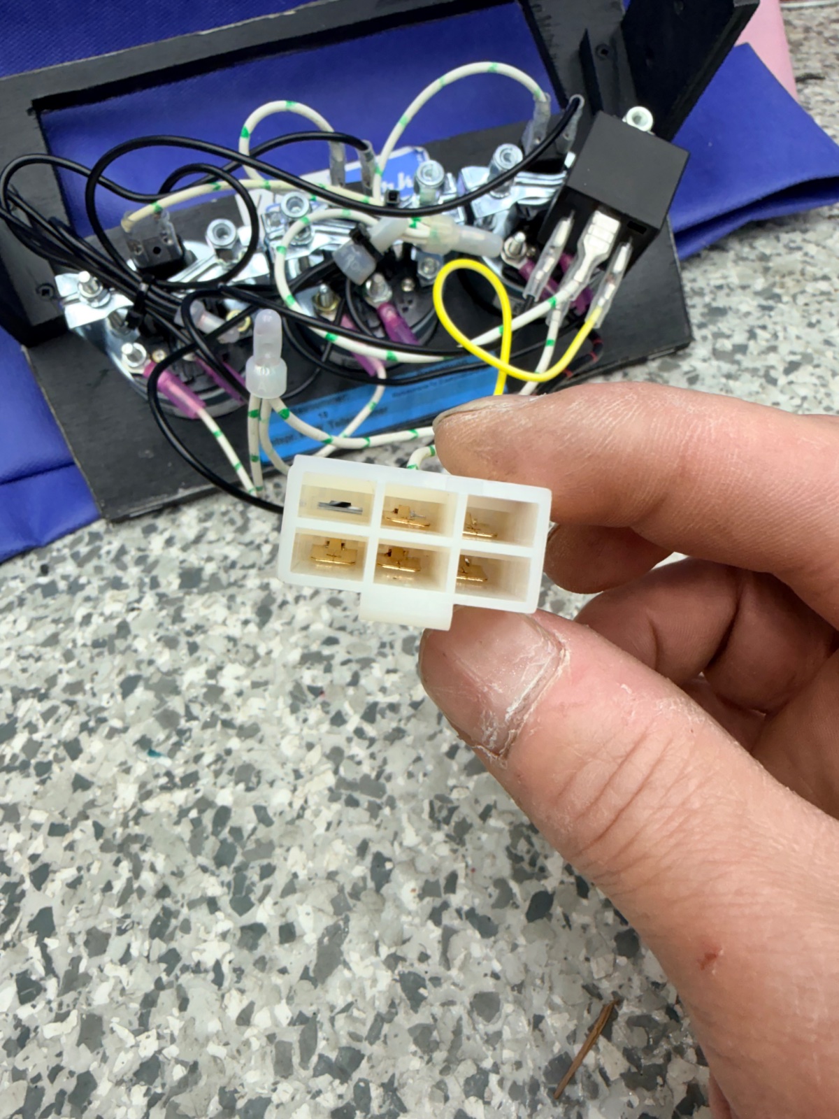

The one I pictured above is a single connector and is a bit pricey. I would buy a box with different sizes - 1,2,3,4 wire. When I wired my three gauges in I made a single block with 6 pins so the whole thing can be removed as a unit. For ones inside the car I used these simpler plastic ones, for ones that could get wet I used the type linked above

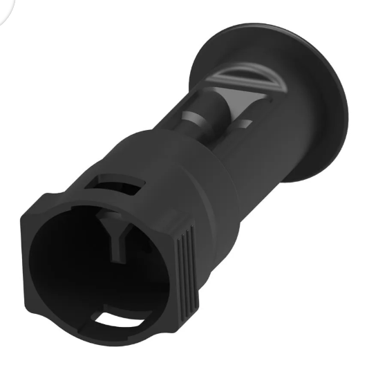

You cut them off and add spades to harness and motors. These other approaches are elegant though.
If these connectors are to be found you can buy cut pieces on eBay.com easily.
I do have new sets somewhere in my stash too.
